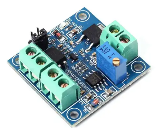

Guys,
any chance to hook up standard VFD (start, stop + analog speed control 0-10V) to Mesa 7i92TF? I think cheap, general 5V PWM to analog 0-10V converters should do fine, aren't they? Thanks!
- Posts: 18115
- Thank you received: 5334
09 Oct 2023 23:51 #282654
Replied by PCW on topic 7i92TF and VFD control.
If you have a step/dir setup, a cheap "Mach 5 axis BOB" has a built in
PWM --> 0..10V analog out section
