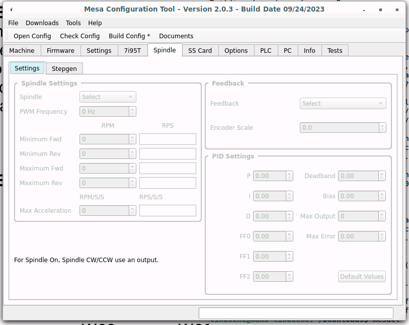

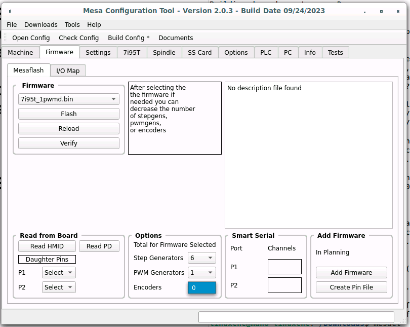

Since Pncconf does not support this card I have installed the Mesa Configuration Tool (2.0.3) and tried to configure the card - but there are several issues I ran into:
1. Can't select any encoders in the firmware options. No matter which firmware I select, 0 Encoders are always the only option available.
2. I can't change any settings on the Spindle tab to set up the PWM output for spindle control. (With "7i95t_1pwmd.bin" and PWM Generators set to 1 on the firmware tab)

The pin names are the same for a 7i95 and 7i95T, the only difference is the mesaflash name.
I'll try and sort out what the problem is. The current version of MesaCT is 2.05
The purpose of the options is to deselect encoders, pwms and stepgens to turn them into gpio.
I do see the issue, the 7i95T uses MuxedQCount and I was only looking for QCount so I'll fix that today.

Thanks for your help! My card arrived in the meantime and using the configuration from the Config Tool worked out of the box, looks like the encoders were not displayed on the UI but are present and working in the config. I couldn't find any reference to the PWM output in the config and couldn't test it yet.
