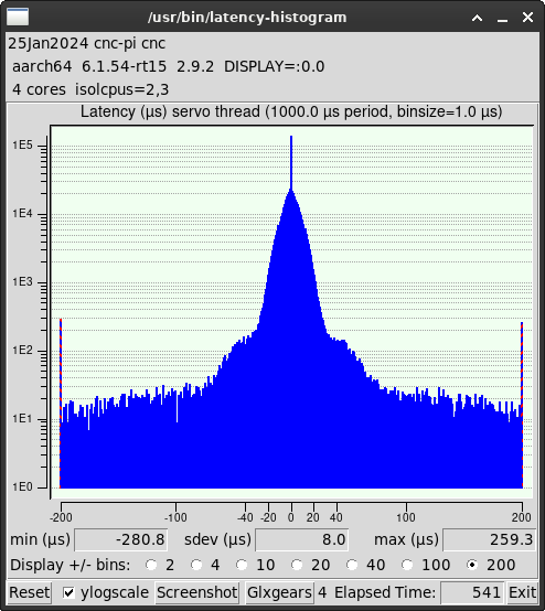

Previously I used: velocity < 500 mm/min, acceleration < 250 mm/s/s.Latency stress test (RasPi-4).
max interval (ns) max jitter (ns)
sever thread (1ms) 1913640 999630
base thread (25us) 304292 279292

What errors do you get from pncconf or mesact?
For the latency test you should not run a base thread so either
latency-test 1ms
or
latency-histogram --nobase --sbinsize 1000

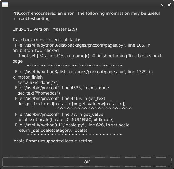

pncconf error example:
Latency (4xGlxGears & 360pYoutubeVideo&4xGlxGears)

You might try increasing the servo thread period to 2 ms
(2000000ns).
Also make sure you have force turbo enabled in the config
as CPU speed switching causes latency issues.
To get an idea what the actual peak latency is, run:
halcmd show param *.tmax
In a terminal when LinuxCNC is running, the numbers represent
the peak times of all LinuxCNC functions (in ns on ARM)

I think pncconf will run to run if you setup a EN_us locale

If you are using an image from the downloads page. please type sudo menu-config
to fix yor locale and any other settings shown.

Seems like there is still a locale issue
Here is my (en_US) locale: (type "locale" in a terminal)
LANG=en_US.UTF-8

Locale en_US.UTF-8 accepted (user error [ass]umed).
