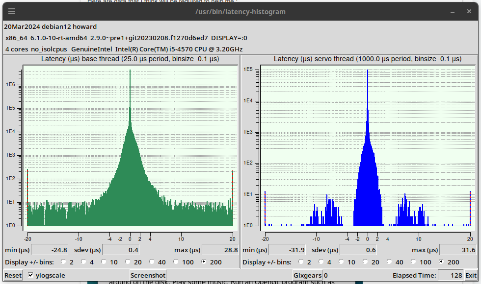

20 Mar 2024 15:58 #296394
by bhowiebkr
Replied by bhowiebkr on topic hm2/hm2_7i76e.0: error finishing read! iter=25403
latency histogram:

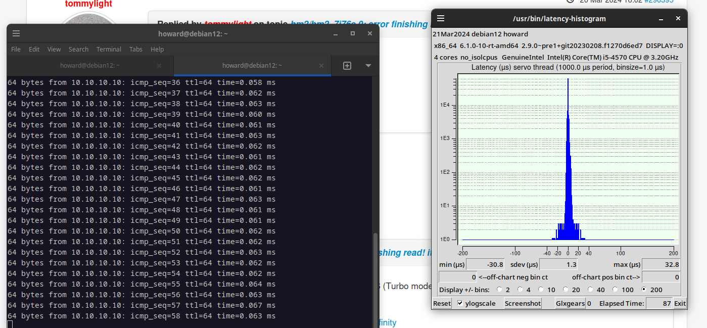

20 Mar 2024 16:02 #296395
Replied by tommylight on topic hm2/hm2_7i76e.0: error finishing read! iter=25403
latency-histogram --nobase --sbinsize 1000 --show
Also, ping times
ping 10.10.10.10
Also, ping times
ping 10.10.10.10

20 Mar 2024 16:11 #296396
Replied by PCW on topic hm2/hm2_7i76e.0: error finishing read! iter=25403
1. Have you disabled all power saving option in you BIOS (Turbo modes, speed-step,Cstates >C1 EIST etc)
2. What is your host hardware?
3. For difficult cases, see this thread:
forum.linuxcnc.org/38-general-linuxcnc-q...ead-and-irq-affinity
