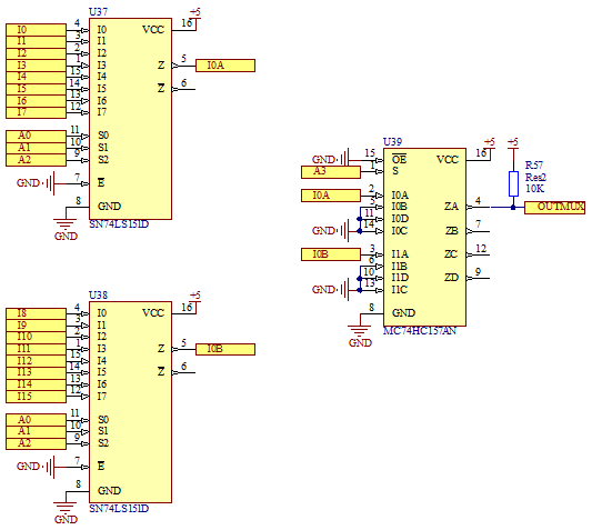

Hello, please help me with add inmux configuration 7i90 card, the P1 port its connected 7i48 card, the P2 connected hardware inmux for 16 inputs bits.

hello, i am load the firmware but the inputs mux dont change the logic value, and use this circuit
the config files
please help me.
the config files
please help me.

17 Apr 2024 21:25 #298497
Replied by PCW on topic inmux mesa card 7i90
Ahh, I forgot that EPP interfaced cards cannot have module addresses > 0x7ffC
which leaves out most of the newer modules. Let me see if there's a handy alternate
address for inmux
address for inmux

17 Apr 2024 21:52 #298500
inmux moved from 0x81xx..0x84xx to 0x70xx..74xx so should work with EPP

ok, i am test and the inmux with length its only 1, start linuxcnc show message inmux 0 scanrate to low, and the only input enabled read the data input.
What does mesaflash [xxxxxxxx] --readhmid report?
