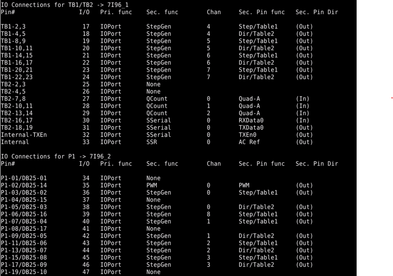

Hi
Looking for 7i96 (non s) firmware for a cnc BOB (the cheap 5 axis one with a relay). I am using the double thcad for ohmic and thc.
Tried the g540 dpl firmware but it swaps my steppers around (0-4 being on the g540 not the mesa) could maybe make this work if i had too but wouldnt be fun to rewire. (see pic)
Ideally axis 0,1,2,3,4 on the mesa still, with 5,6,7,8,9, on the bob.
Currently the machine has 3 X axis. 2x gantry and 1x cable follower (cables hang from ceiling on an axis which follows x so they dont get tangled). 1 for y and 1 for z
looking at adding at least 1 for rotary plasma, and one to feed the bar through the spindle. Might need one or two more to clamp the bar. Not sure yet.
I have a few 7i96S as backups, would it be possible to get the firmware for that board as well?

Replied by PCW on topic 7i96 plasma firmware needed for BOB
That configuration will not fit on a 7I96 but the 7i96s firmware is:
7i96s_5abobdpl.bin
7i96s_5abobdpl.bin
