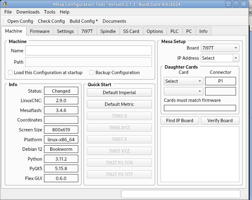

I removed hardware-irq-coalesce-rx-usecs 0 because I'm not using an intel chip and it worked again.
I have exchanged with ping 10.10.10.10.
on the other hand on mesact I have like mesage :
----Find IP Board---
Find IP board
Results : Unsupported ethernet device 7i97T at 10.10.10.10
No ether board fund
----Verify board
Device found at 10.10.10.10 is not a mesa Board
Find IP board
No ether board fund
----Verify board

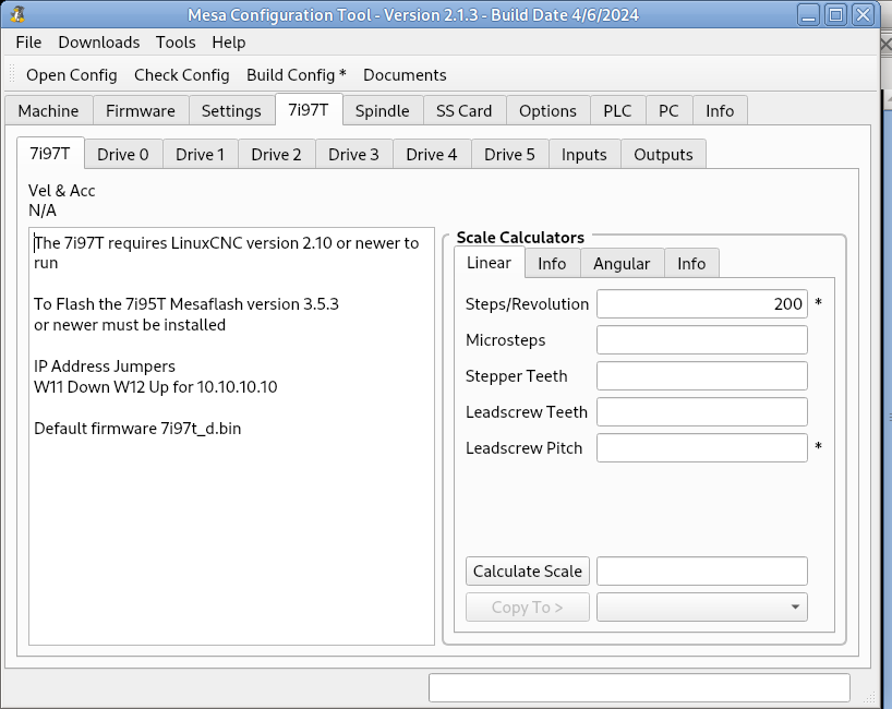

My guess is that you need the latest MesaCT and mesaflash to setup
a 7I97T if you need to change firmware
Note that you don't need to run mesaflash at all or change firmware
unless you are using a configuration with an expansion daughtercard
connected to the 7I97Ts parallel expansion connector.
So if there is an issue with the 7I97T, a configuration built for a 7I97
should work as well. Also If not already doing so, you should use
LinuxCNC 2.9.2 with the 7I97T.

And you can see that on this PC I can't run a 7i97T or do anything with mesaflash with a 7i97T because the version is behind.
