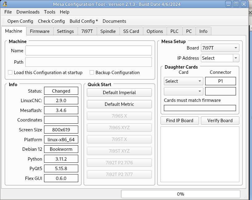

10 Jun 2024 21:36 - 10 Jun 2024 21:39 #302780
by JT
Replied by JT on topic Installing Mesa CT
Last edit: 10 Jun 2024 21:39 by JT. Reason: add image

11 Jun 2024 11:19 #302809
by JT
I downloaded the iso and ran the live cd and there seems to be a problem with xfce and running gdebi from the file manager. I had no problem installing Mesa CT using a terminal and the following command. Also seems xfce is broken if you try and launch a terminal using the keyboard with Ctrl Alt t. Must be a reason I don't use xfce and prefer Mate.
JT
sudo gdebi mesact_2.1.4_amd64.debJT
