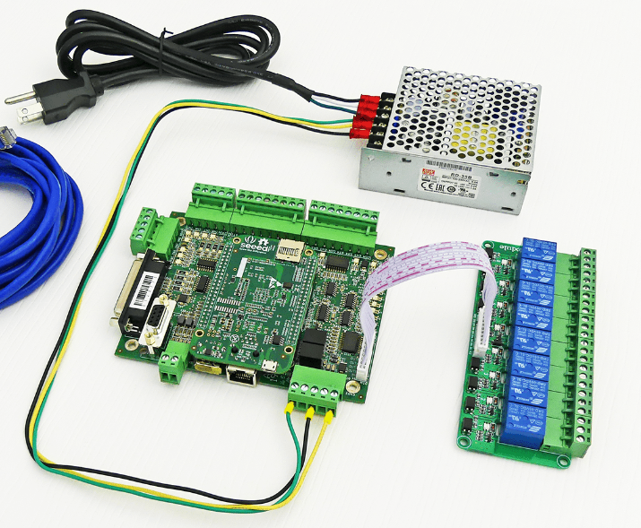

Replied by Benb on topic Mesa 7i77 remote error = (27) over current
The 7i77 card outputs use NCV7806 IC. These chips are sensitive to overvoltage and overcurrent. You can reduce the chances of frying them by NOT disconnecting the 24vdc supply side of the card to avoid overvoltage. Use slave relay cards to avoid overcurrent.Have look at the attached picture. Centroidcnc equip their low-cost CNC cards with hobby grade relay card and hard wire the dc supply side (I would solder the wires) to further reduce headaches with fried chips and provide an AC plug for power disconnections.Centroidcnc has been in the business of dealing with hobbits for long time, they know how to reduce issuance of RMA’s (PCW knows what I am taking about).
