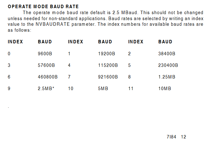

SmartSerial is going to need 2.5mbps serial interface to begin with.
The smart serial protocol is layed out in most of the mesa manuals.
Looking into the slave (probably the easier way to see how things work)
One of the best places to start is to download one of the 7i90 zip files, this includes the bitstreams for the card and the hostmot sources, within that you'll also find ssremote7i90.zip which is the src for the ssremote portion if you want to use the 7i90 as a ssremote card.
The source is in assembly for one of the softcores on the fpga, it's pretty easy to work out, that's not that many instructions. Convert that to your mcu of choice and you should be good to go. Tho you may want to look into learning at least C.
It took me about 2 weeks to really get a good idea of what was going on, then modify that portion to get that running on a colorlight RV901T board that supports 4 MPGs. A couple of days of that was a silly mistake on my part. It was never my intention to get the code running on a MCU, so I never bothered looking into it.
Ok thats just for the slave portion.
If you want to have a non Mesa Master, you'll have to do all of the above but looking at the slave point of view. Then you would have to come up with a serial device that works at 2.5mbps, and then write a SmartSerial that talks to your setup. Or though you can use 115.2k but that's about 20 times slower.
On top of all that you'll have to design the hardware, PCB boards and buy parts. At the end of the day it will more likely end up not being cost effective.

In normal mode, SmartSerial is used so that one serial output serves one SmartSerial device.
Is it possible to use SmartSerial with a modified Master as a bus? I want to use several 7i84.
SmartSerial uses a Full Duplex bus, but I have a Half Duplex bus. Is this a problem?
Replied by zz912 on topic SmartSerial Master for Arduino - exist? Possible?
I found in manual 7i84:SmartSerial is going to need 2.5mbps serial interface to begin with.
I like C. I dont like python.
Thank you, I will study it.

You might be better off looking at modbus. From my point of view you're looking at making some wholesale changes.
As far as I'm aware SmartSerial seems to be designed as a single device per channel at full duplex.

Thank you for the consultation. I came to the same opinion. If I could program a PIC, I would think about converting the 7i84 to a modbus slave.
