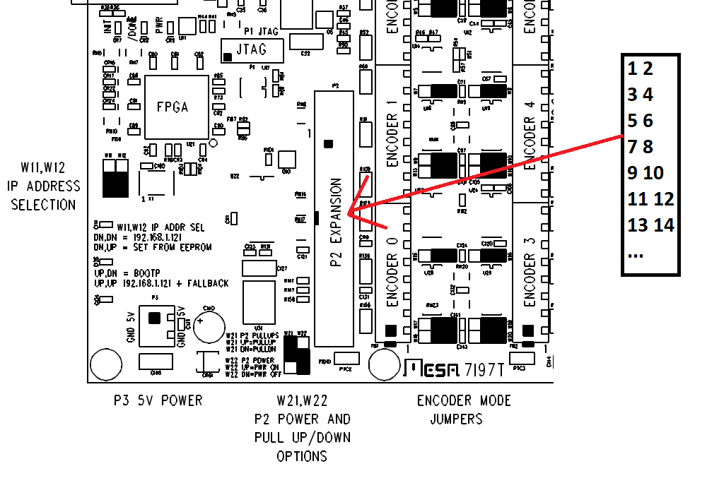

The problem with the .pin file in the distribution zip file is that it was made assuming
you had a 7I85 so it lists 7I85 pins not P1 pins. To make a pin file that lists P1 pins:
mesaflash --device 7I97t --addr [card_ip_address] --readhmid > 7i97t.pin
Also in case there is a question, 26 pin header physical pin arrangement is:
1 2
3 4
5 6
etc etc
Pin 1 is marked with a square pad
This means than a flat cable has wires in numerical sequence
(with the red wire being pin 1 if made correctly)

25 Aug 2024 15:01 #308603
by Krulli_Fräser
Replied by Krulli_Fräser on topic Editing Bitfile on 7i97t for extra smart serial connections
- Posts: 18109
- Thank you received: 5329
25 Aug 2024 15:11 #308605
Replied by PCW on topic Editing Bitfile on 7i97t for extra smart serial connections
Yes
