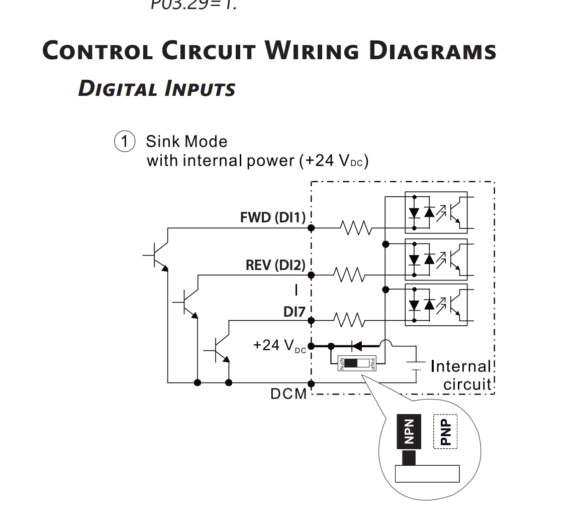

SpinX1A output to DuraPulse GS 20 Input

SpinX1A output to DuraPulse GS 20 Input was created by ekbiker

Replied by PCW on topic SpinX1A output to DuraPulse GS 20 Input
That (SPINX1 CW+ --> FWD, SPINX1 CW- --> DCM)
should work (when the switch is set for NPN) ,
but try with a direct connection (FWD to DCM) to verify that
the drive is setup properly.
Note that SPINX1 /ENA must be asserted (low)
for either CW or CCW to be enabled
