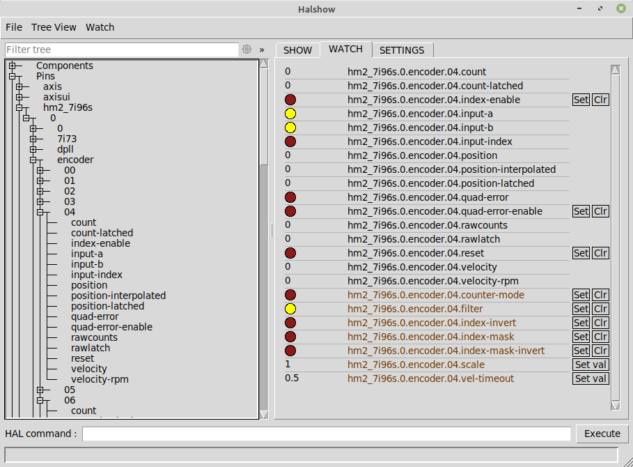

I'm using a 7i96s with 7i96s_p1encd.bin
I'm using an isolated I/O board to interface to the P1 connector, and I'm using the 4 encoders there:
Encoder0: Linear Scale X - tested and working
Encoder1: Linear Scale Z - tested and working
Encoder2: MPG input for X - waiting on encoder to arrive
Encoder3: MPG input for Z - waiting on encoder to arrive
I just made a little potentiometer -> voltage to frequency converter circuit dc-1kHz and it's presently driving isolated input 0 on TB-3, I can see it pulsing in halshow.
I was hoping to use hm2_7i96s.0.encoder.xx.velocity to allow that pot to control Jog rate.
I bumped up num_encoders from 4 to 5, however looking at the available pins in HAL show, encoder 4 does not have all the pins available for encoders 0-3, so I'm guessing there is a 4 encoder limit for the 7i96s?
Perhaps there is another 7i96s version that allows more encoders (hoping for 2 more, one for jog speed and one for feed speed) with two of them on the isolated TB-3 terminals.
If that's not possible, is there another HAL method to measure frequency on the TB-3 isolated inputs?

The number of available encoders depends on the firmware and pin/FPGA size limitations.
The 7i96s_p1encd firmware has 7 encoders: 0..6. They are all basically identical
(except encoder 6 has no index input pin due to lack of pins)
Here are all the encoder 4 pins and parameters (using 7i96s_p1encd firmware):

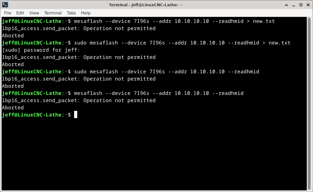

I'm a little confused with the 7196s pin assignments associated with the encoders. Ideally there would be 4 encoders assigned to the P1 expansion port and 2 to the TB3 inputs. The two on the TB3, don't actually have to be quadrature inputs, because those two will simple be driven with a simple square wave .IIRC 7i96s pin assignment can be tweaked by editing 7i96s_p1encd.pin?
Can I simply edit that file, and if so how would I assign the last two encoders to TB3 pins?
I thought I could get the latest pin assignment with:
mesaflash --device 7I96s --addr 10.10.10.10 --readhmid
However I get and error (see attached) when I try that.
Replied by slowpoke on topic 7i96s maximum number of encoders?
The number of available encoders depends on the firmware and pin/FPGA size limitations.The 7i96s_p1encd firmware has 7 encoders: 0..6. They are all basically identical(except encoder 6 has no index input pin due to lack of pins)Here are all the encoder 4 pins and parameters (using 7i96s_p1encd firmware):
That's good news.

Your mesaflash command may have failed because either you have LinuxCNC running
or LinuxCNC did not exit cleanly. LinuxCNC blocks access to the Ethernet port it uses
when running.
The .pin file just a human readable file that describes the firmware contents and
pin connections. Its made by running mesaflash's --readhmid command.
To make new firmware, one changes the PINXXXX.vhd file and re-compiles
the firmware source using the software toolchain for the particular FPGA.
