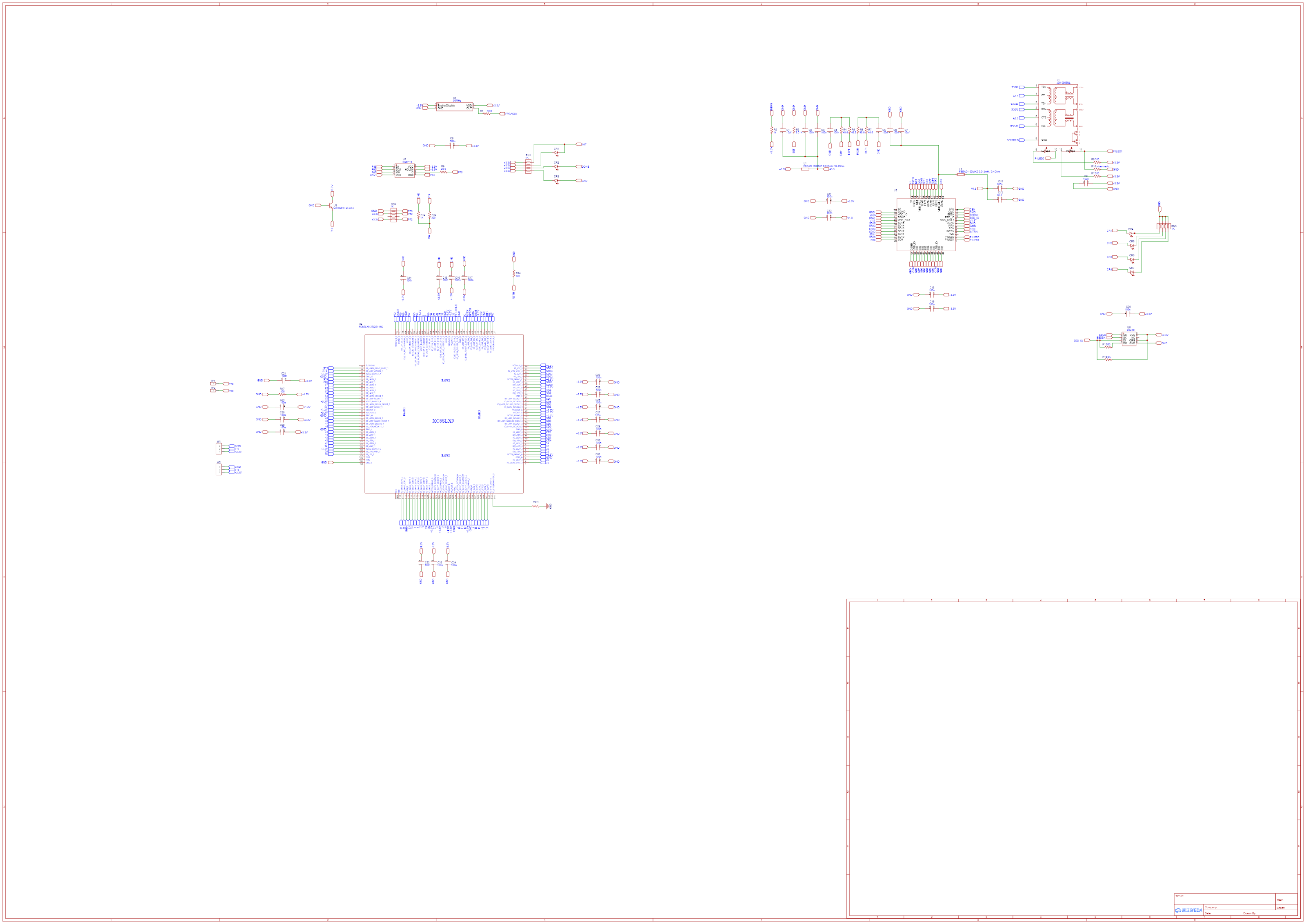

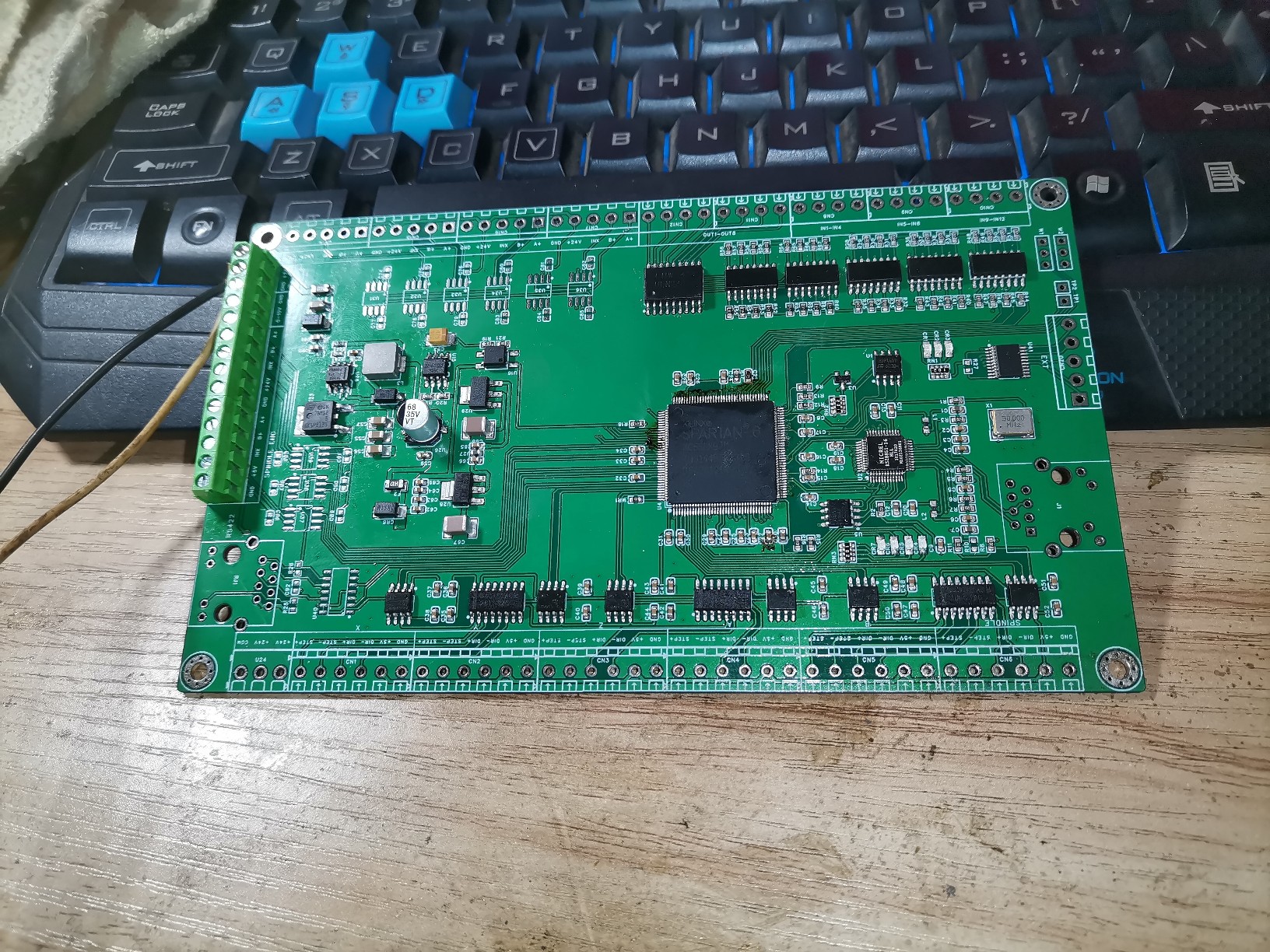

Self-built 7i95 Seeking for help
- wuyatom
- Posts: 42
07 Mar 2025 13:09 #323414
by wuyatom
Self-built 7i95 Seeking for help was created by wuyatom
- Posts: 18115
- Thank you received: 5334
07 Mar 2025 15:01 #323416
Replied by PCW on topic Self-built 7i95 Seeking for help
You should be able to program a 7I95 bit file (or one you created from source) directly
into the flash chip. Then re-program the user firmware and fallback via mesaflash over Ethernet
to fix the fallback/boot sector if you care about that feature.
