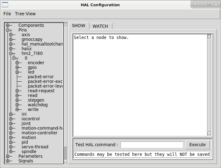

19 Apr 2025 11:48 #326691 by tommylight
Replied by tommylight on topic 7i80db 7i77 + 7i76 serup Hal conf
Do they show in "show hal configuration" from the "machine" menu?

19 Apr 2025 11:52 #326693 by GDTH
Replied by GDTH on topic 7i80db 7i77 + 7i76 serup Hal conf
do you mean this?

19 Apr 2025 11:52 #326694 by tommylight
Try setting all sserial to 000000 instead of 000xxx in the loadrt line, to many sserials enabled in the firmware so might be disabled with x.

19 Apr 2025 11:54 #326695 by GDTH
just did that, made no difference to how to hal conf looks like :?
