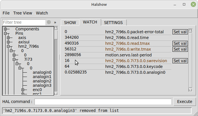

- PasstScho
- Posts: 20
14 May 2025 20:09 - 14 May 2025 20:17 #328484
by PasstScho
Replied by PasstScho on topic mesa 7i73 4x8 keypad problems on KEY8 input
My friend just wrote me that by merging the start of original & rest of the new hex file he could make it run and linuxcnc says fw16 but the buttons are still not working.
Maybe as you mentioned it has something to do with the bootloader it is not a good idea to copy the old bootloader? I really don't know how to fix this now...
Are you sure this file contains a bootloader or whatever is on address 0x0000 - 0x0FFF? Maybe it works for you because you don't erase and only overwrite the area from 0x1000 - ....?
I also feel like PicKit 3 maybe is too old and not doing same procedure as a newer one?
Last edit: 14 May 2025 20:17 by PasstScho.
- Posts: 18105
- Thank you received: 5328
14 May 2025 20:49 - 14 May 2025 20:53 #328486
Replied by PCW on topic mesa 7i73 4x8 keypad problems on KEY8 input
I Started with an erased 7I73 and it works properly
Its known that the R14 base part will not work properly
with the R16 user part (keyboard does not work).
If I load the full R16 firmware image (with the checksum above)
with my programmer, the memory image starts at 0.
Maybe some image incompatibility or hex file option difference
with your programmer is causing the offset.
I have included three most recent full images, I suspect none will work without
some change in your programmer.
Note that I am using a older programmer as well but not a PICKit
(a melabs U2) I do have a PICKit 4 I could try
Last edit: 14 May 2025 20:53 by PCW.
- PasstScho
- Posts: 20
14 May 2025 21:26 #328489
by PasstScho
Maybe I've found the problem. Looks like the hex file is malformed.
The ":00000001FF" is the EOF - end of file - marker. After EOF it looks like there is more data and another EOF marker.
Looks like there is the missing data!
I can copy the parts after the end to the beginning of the file and try again... unfortunately will take some days of uncertainty before I can try.
Your programming tool could just ignore the EOF marker and also read the extra data.
This is the very end of the 7I73S16H1.HEX intel hex file:
:10A8C800320000000000000000000000000000004E
:10A8D8000000000000800000102700001E0000009B
:10A8E8000080000064000000785600003412000068
:08A8F80000000000AA55000059
:00000001FF
:0200000401F009
:100000000F000000FF000000070000008300000058
:10001000C50000004000000007000000C300000011
:00000001FF
:00000001FF
:0200000401F009
:00000001FF
