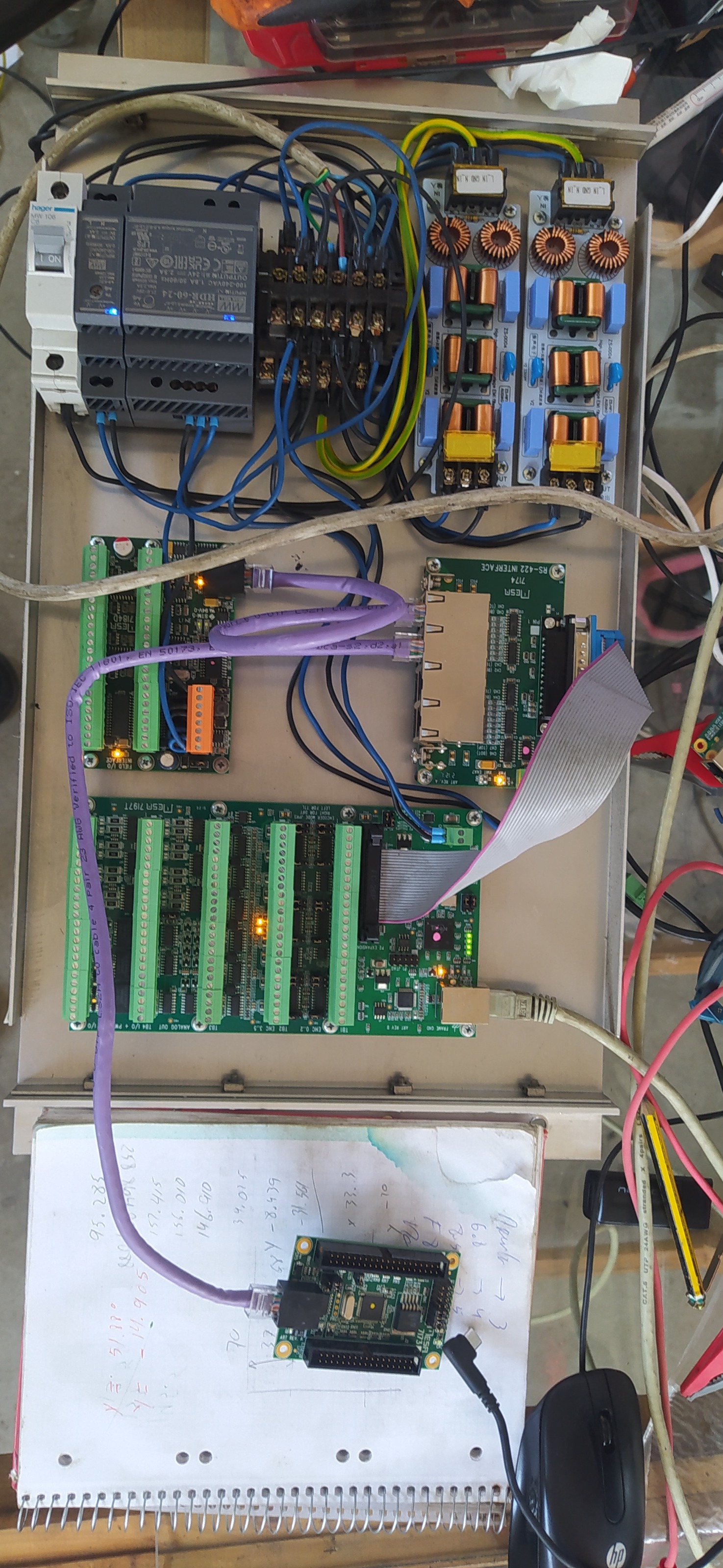

- MRTtechnology
- Posts: 12
28 May 2025 15:19 #329321
by MRTtechnology
Replied by MRTtechnology on topic 7i97T+7i74+7i84+7i73

- MRTtechnology
- Posts: 12
28 May 2025 18:24 #329326
by MRTtechnology
Hi guys
I want to connect two MPGs to the encoder inputs of the 7i73
My MPG has A+A-B+B- OV5V e and use two analogue inputs.
To do this, I'll have to use mode 1 on the 7i73 board
Has anyone configured this board in encoder+analogue mode?
