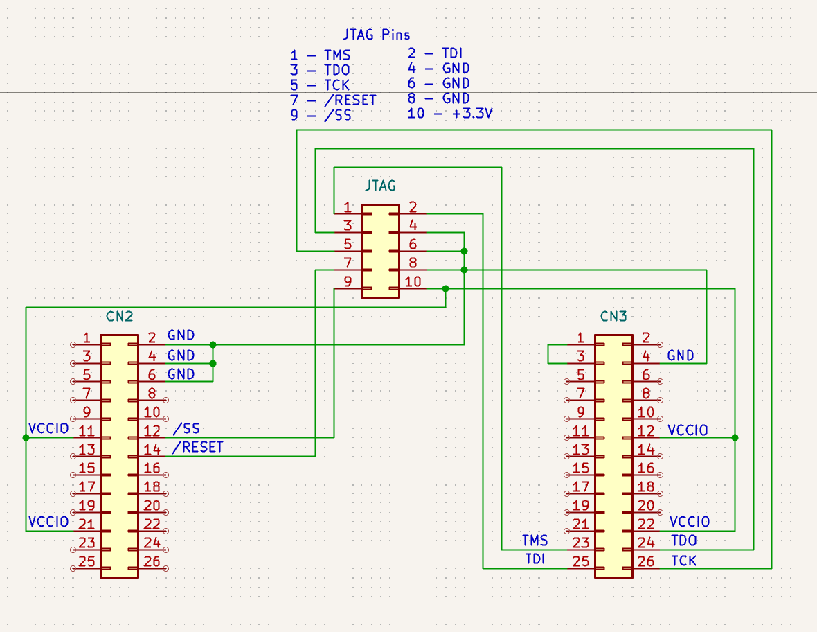

I've got the current efinity software (2025) and a FT2232H Mini Module. I've attempted to wire some of the JTAG up according to the specifications in the datasheet for JTAG, but was unsuccessful with that, and also via the wiring diagram here: www.forum.linuxcnc.org/27-driver-boards/...-the-fallback#318881
However, I can't make sense of the diagram.. It seems to mention that pins 1, 3, and 5 are ground, but according to the FT4232H and FT2232H datasheets, those pins are 3.3V VCC. I've tried a couple combinations of wiring but haven't been able to find one that works.
Is there any mapping between the actual bus names (AD1, BD2, etc) and the JTAG pins on the board? I don't mind doing a writeup on the procedure if I can get it working, but I'm just out of ideas here.

Note that as the schematic says, there's an even/odd swap
because the schematic is for the flat cable, (which plugs on to
the reverse side of the FT4232H), _not_ the FT4232H

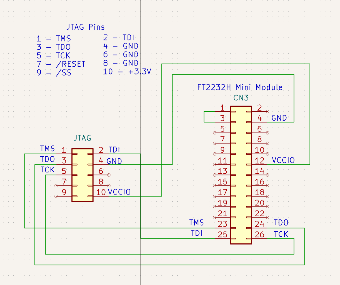

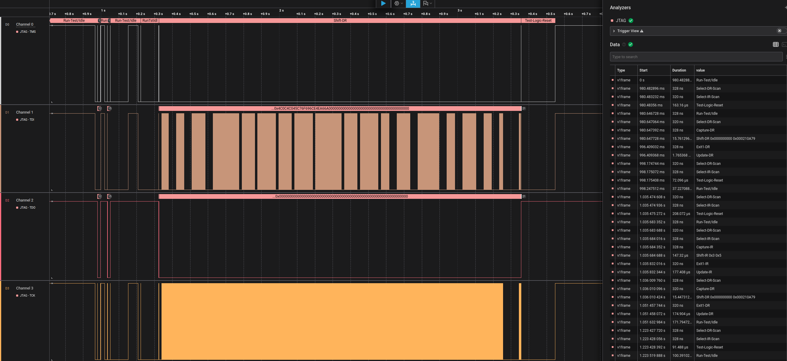

I spent some more time on this tonight and after fixing some Python bugs and rechecking the wiring again, I hooked up my logic analyzer and verified that communication appears to be happening on the JTAG lines, I see mostly TDI with some responses on TDO, and clock signals appear to be working too.
I've done a quick drawing of how things are connected with the FT2232H Mini Module, as the pinout for the ports seems to differ from that of the FT4232H, and after checking the pins just to be safe, I see no data coming out of them, so I assume this setup is correct, matching port for port between the two modules.
I can run init95t and it seems like it attempts to program, and then cause a reset of the board, but the board goes right back into the same mode, with /DONE lit constantly, and no link lights on the ethernet:

Not sure if there's anything obvious wrong with this setup... I've attached a schematic of the wiring and the saleae Logic file as well as a picture of the logic capture.
I should specify that the pin numbers used in the drawing are the ones from the datasheet and the ones on the JTAG match up with what is listed in the manual for that board.

Thank you, after a bunch of messing with this I'd glazed over the 95/92 difference and didn't notice until you called it out.
Turns out my wiring was good, but I had the wrong file being programmed.

- Connect up the FT2232H Mini Module to the 7I92T according to the wiring diagram attached. No connections to CN2 are necessary. Use 5V power to the 7I92T's power terminals, and don't forget to connect the jumper on the FT2232H Mini Module to USB bus power it.
