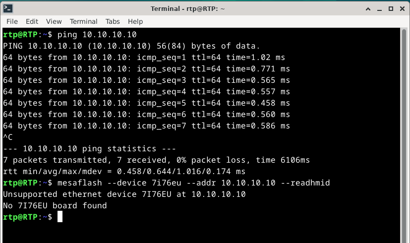

Using with a Mesa 7i76EU (IP ). Ping works, but:mesaflash --device 7i76eu --addr 192.168.1.121 --readhmid
Unsupported ethernet device 7I76EU at 192.168.1.121
No 7I96S board found
Also tried with IP after moving jumper W14 up
mesaflash --device 7i76eu --addr 10.10.10.10 --readhmidIs the 7i76EU supported? How to fix "Unsupported device"?
mesaflash 3.4.9192.168.1.121Unsupported ethernet device 7I76EU at 192.168.1.121
Also tried with IP
10.10.10.10mesaflash --device 7i76eu --addr 10.10.10.10 --readhmid
Unsupported ethernet device 7I76EU at 10.10.10.10No 7I96S board found
- Posts: 22006
- Thank you received: 7490
20 Jun 2025 15:57 #330582
Replied by tommylight on topic Mesaflash 3.4.9 shows "Unsupported ethernet device 7I76EU" despite successful pi
Use the latest version of mesaflash
github.com/LinuxCNC/mesaflash
Scroll down for info on how to install.

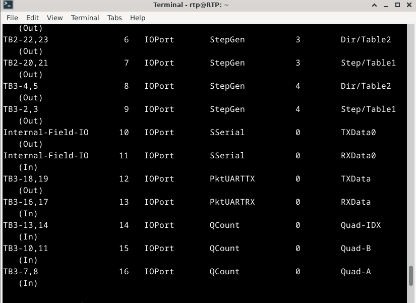

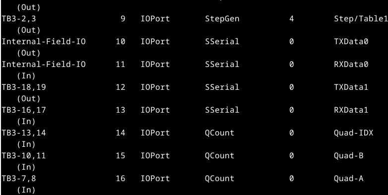

- AdelRTP
- Posts: 19
20 Jun 2025 20:34 #330598
by AdelRTP
Replied by AdelRTP on topic Mesaflash 3.4.9 shows "Unsupported ethernet device 7I76EU" despite successful pi
- Posts: 18115
- Thank you received: 5334
20 Jun 2025 20:49 - 20 Jun 2025 20:50 #330600
Replied by PCW on topic Mesaflash 3.4.9 shows "Unsupported ethernet device 7I76EU" despite successful pi
You would load the 7I76eu firmware that includes PKTUart support
7i76eu_7i76x1_pktv3d.bin
This file is in the 7i76eu.zip archive downloaded from Mesa's store (in the specifications tab)
You program it with mesaflash, something like:
mesaflash --device 7i76eu --addr 10.10.10.10 --write 7i76eu_7i76x1_pktv3d.bin --reload
