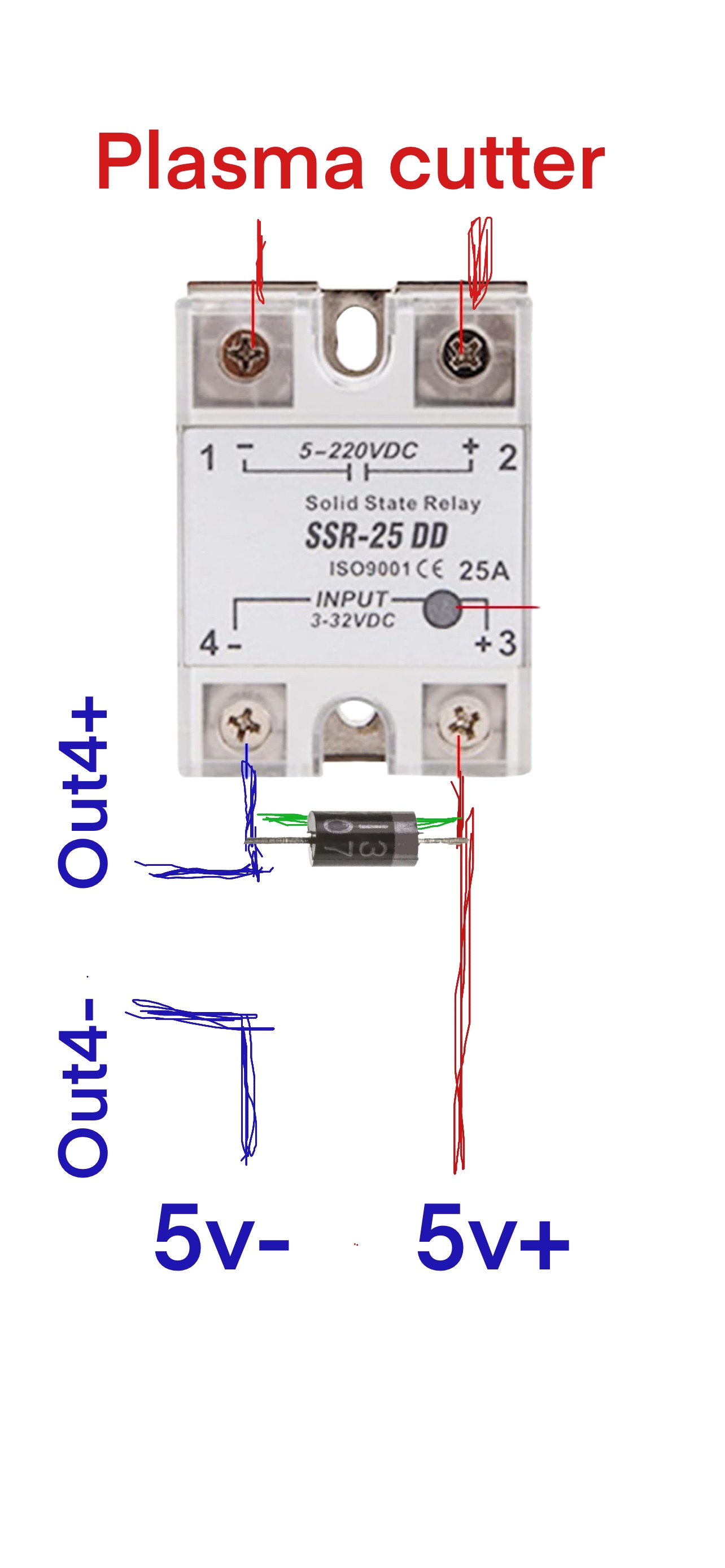

- Johnnysacalu
- Posts: 39
24 Jun 2025 18:36 #330813
by Johnnysacalu
Replied by Johnnysacalu on topic Como conectar mesa 7i96s
Me podrias confirmar si es correcto? Gracias
- Posts: 18115
- Thank you received: 5334
24 Jun 2025 18:50 #330814
Replied by PCW on topic Como conectar mesa 7i96s
That will likely work, but the diode in not needed unless you use a magnetic relay.
It also unnecessary for TORCH_ON as you could use one of the high isolation (OUT4,OUT5)
outputs of the 7I96S directly as long as the current required is not > 100 mA
- Johnnysacalu
- Posts: 39
24 Jun 2025 20:14 #330816
by Johnnysacalu
No creo que pueda saber si necesita mas de 100mA lo tengo que conectar al gatillo que tenia la antorcha
- Posts: 18115
24 Jun 2025 20:19 #330817
Yes, if you don't know the signal characteristics,
an external SSR would be safest.
Though if it is a DC signal, you can measure the
current with a DVM (Start at high current range and work down)
