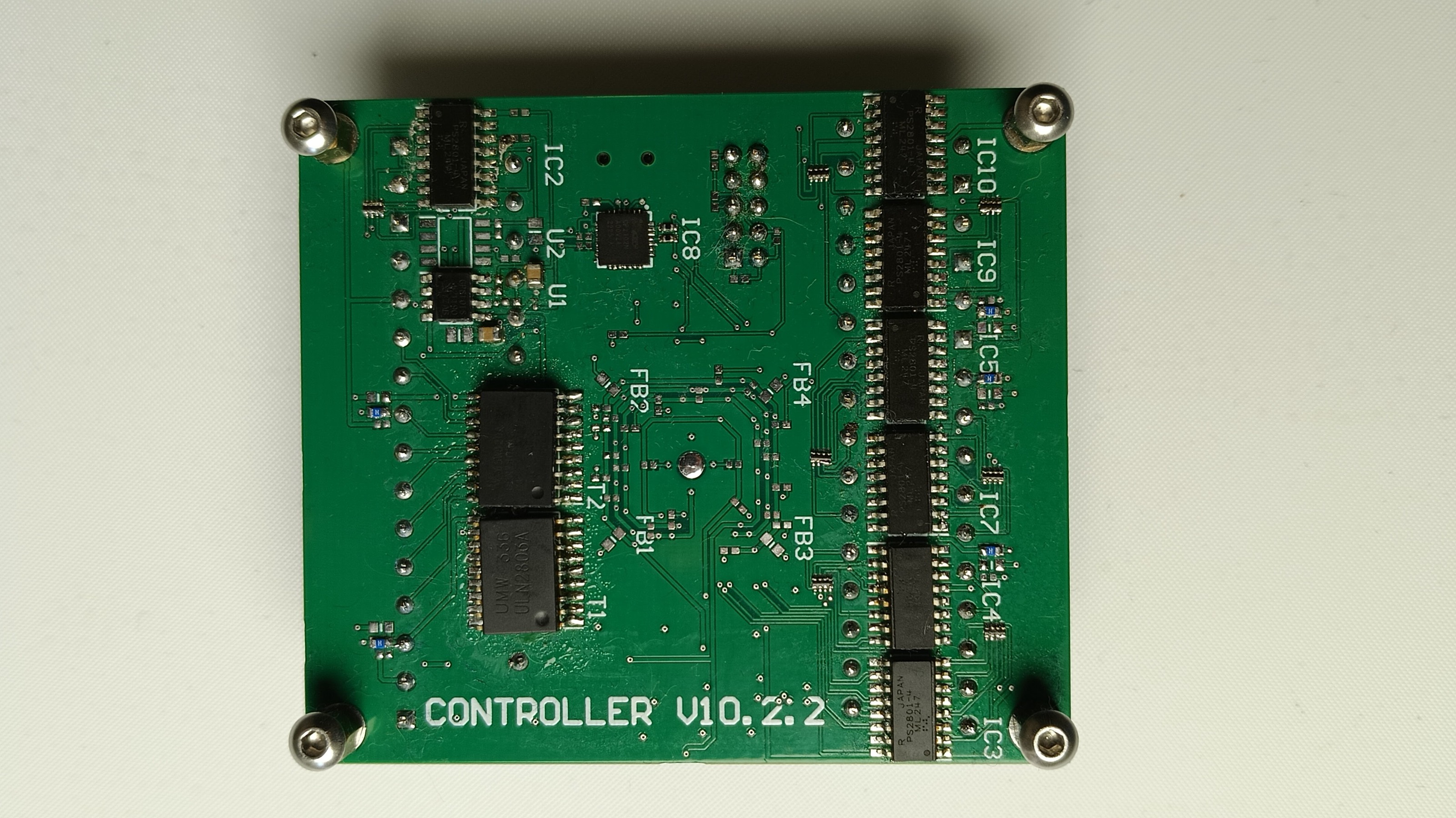

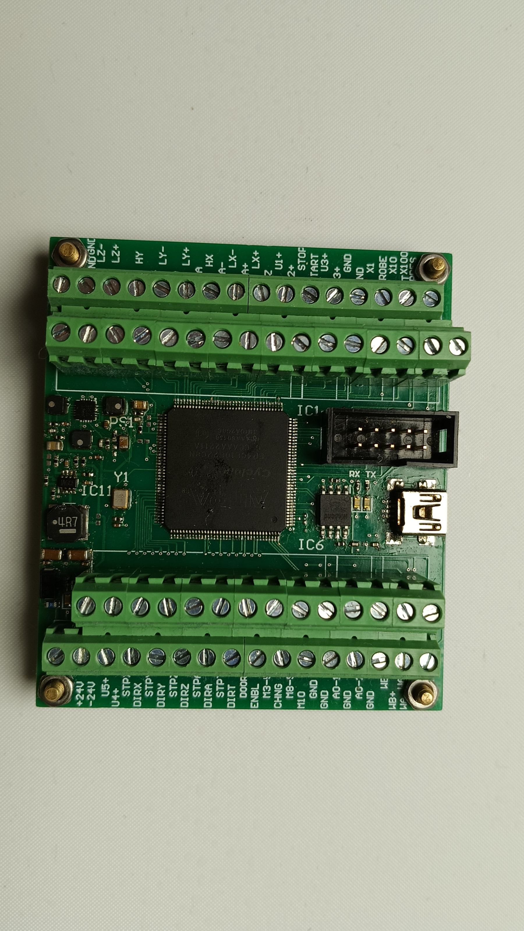

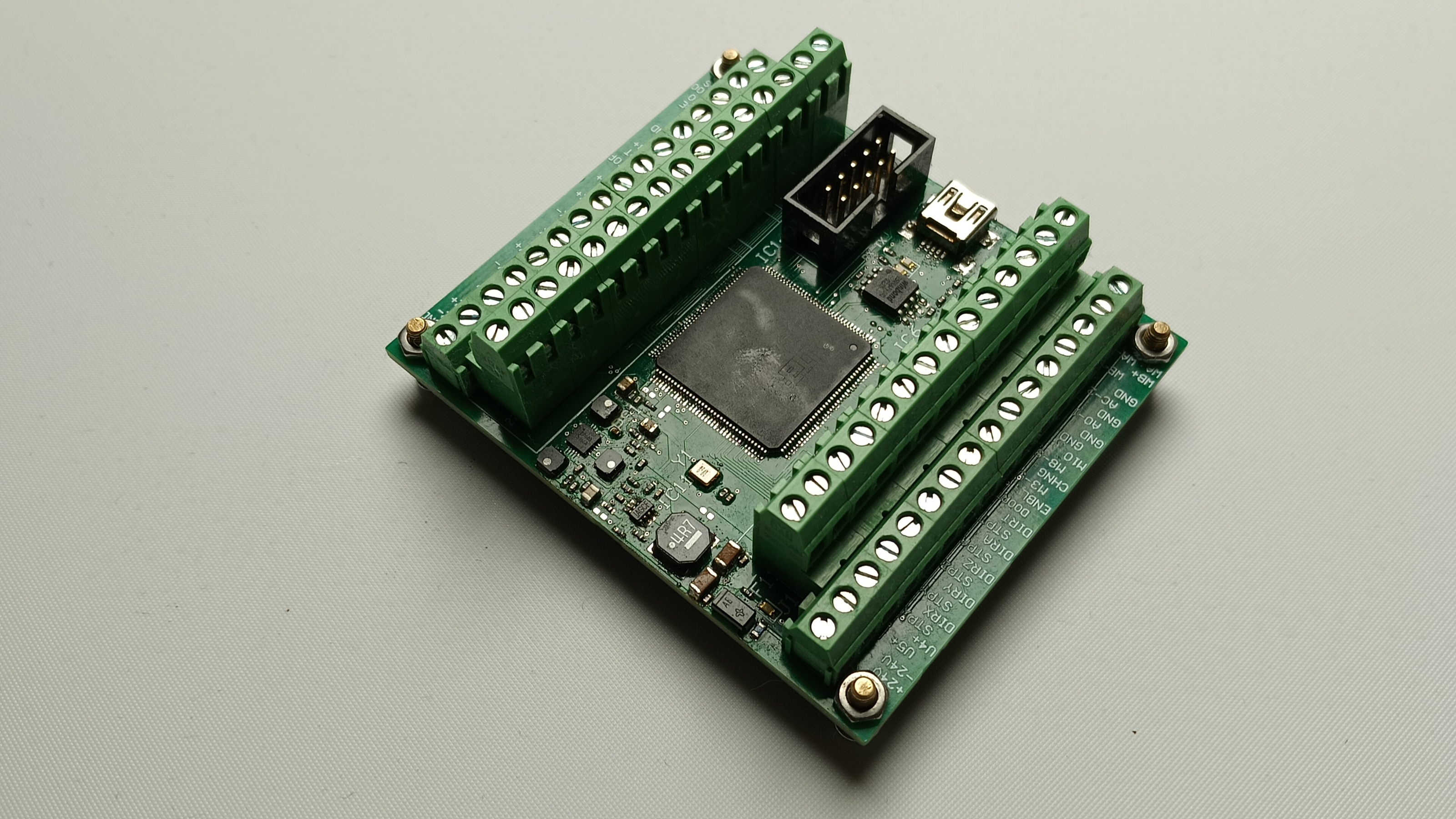

Hi.
I am new in Linuxcnc. I am going to design my own board use FPGA. I do not know how to make driver. I have experience in c c++. May be somebody knows how to do it, or where i can take any sample driver or any information.

Thank you for the help. I am going to use EP4CE10E22, Verilog, and it will be open source project.
Board parameters:
Dimensions 67x76x20 mm
Weight 60g
Supply voltage 12-24V
Power 0.5 W
Opt. isolated inputs 24
Outputs: digital 16 (0.5A max)
analog 2 (0-10V)
JTAG, USB
Board parameters:
Weight 60g
Power 0.5 W
analog 2 (0-10V)
JTAG, USB
- vitali

sweet
and for the host interface USB?
this will not really work
LinuxCNC is a little bit different to other controller like GRBL,
you need a realtime loop between board and host and this will only work with Ethernet/Ethercat/SPI(raspberry) or LPT., not with USB or UART.
If you need almost ready to use Gateware/Drivers for your board, you can look at:
github.com/multigcs/riocore/
(github.com/multigcs/riocore/blob/dev/doc/BOARDS.md)
this is a gateware generator and all the FPGA stuff is written in verilog,
but it use W5500 UDP interface or SPI.
There is also an UART/USB plugin, but only for testing, not for realtime use.
you can take a look on my youtube channel, there are many videos with different FPGA's running RIO:
www.youtube.com/@unixconf/
but i can understand if you prefer to write your own software, it's also fun

I am going to install Linuxcnc on Orange Pi PC Plus. OPC send to FPGA controller
Speed and Axis coordinate in steps. FPGA controller has buffer for all parameters. According my calculations USB speed is enough to work in real time.
- unknown
- Posts: 887
- Thank you received: 323
24 Jun 2025 23:34 #330831
by unknown
Replied by unknown on topic How to design new driver for my own board
It's not speed that is the issue, it's regularity. Once you introduce a buffer you lose the ability for realtime response.
There's a reason that no USB development has been done for Linuxcnc.
Search the forum for questions related to USB and you'll get the same response over and over.
Mesa has one or two boards that have USB interfaces but none are used for Linuxcnc.
As previously stated, Ethernet, SPI or EPP are the way to go. USB maybe ok for control panels for non realtime input, but disconnection can be an issue.
I really suggest you look into it more, especially the difference between speed and regularity. You may also want to look to see if USB has any realtime drivers.
