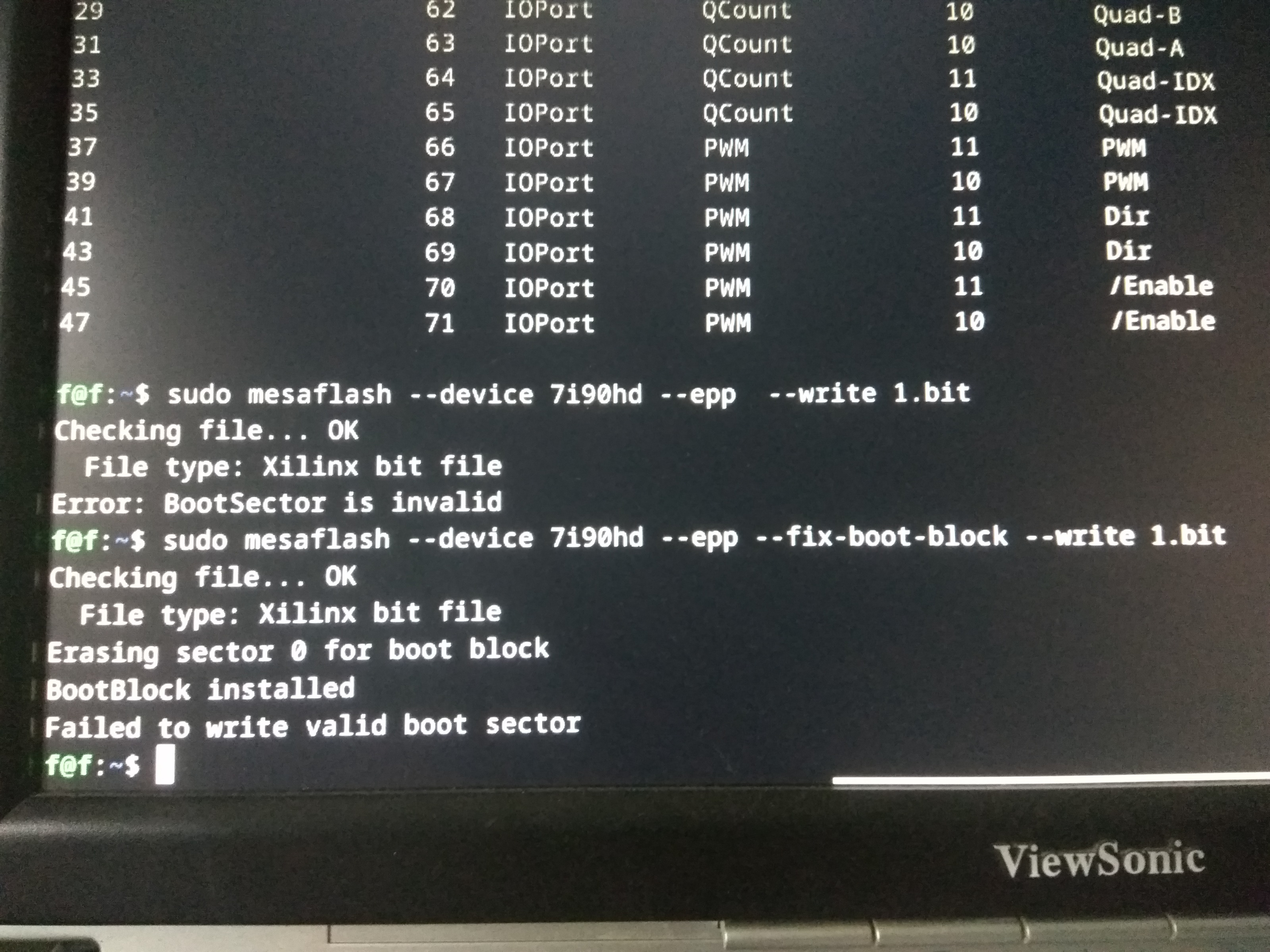

Hello. After incorrect firmware loading all three LEDs on the board light up and mesaflash not found board. I try jtag flash. The firmware is uploaded successfully and light up only yellow power led. Mesaflash found board, but when I try to write a bit file an error occurs: Error: BootSector is invalid.
--fixbootblock doesn't help. What shoud i do to wrtie bit file in EEPROM?

Hard to tell if this is a EPP interface issue or maybe a Mesaflash problem
Can you try:
Power up on alternate EEPROM (which should have a valid boot sector)
program FPGA via JTAG (NOT FLASH!)
Then try mesaflash again to write a standard EPP bitfile
If this does not work, a temporary workaround (if you are building you own firmware)
would be to write the flash via JTAG
Can you try:

Sorry, took a while to check this out as I did not have a working
test system with a EPP parallel port and Mesaflash/LinuxCNC.
Unfortunately, I am unable to duplicate the issue.
What I did was take a 7I90HD and corrupt the S EEPROM so the boot block was broken
then booted from the P EEPROM , reselected the S EEPROM and attempted to update
The S EEPROM via mesaflash:
So it still may be a host EPP issue of some kind.
Test system: LinuxCNC 2.9.4 mesaflash 3.4.9
Hardware: HP Elite 8200 SFF with on board parallel port
