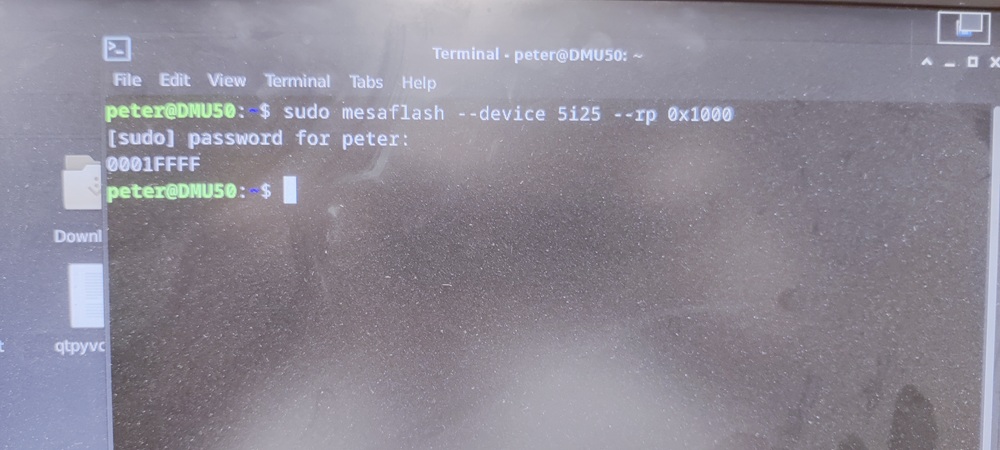

You can check the 5I25 for damage by
1. Disconnecting the DB25 cable (with all power off)
2. Running:
sudo mesaflash --device 5i25 --rp 0x1000
This should report all highs on the I/O pins = 0x001FFFF

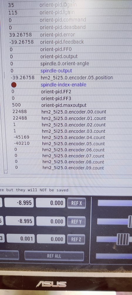

To diagnose the 7I77 encoder issue, I would setup halshow
to watch all 6 encoders and then try each encoder input and see:
1. If it works
2. If it affects any other channel

5i25 reported as you said 0001FFFF

Encoder 00 and 01 show the same value, although nothing is attached to 01.
02 & 03 seems to be paired as well.
I got different reading on encoder 04 & 05, but they both changing from one encoder input.
