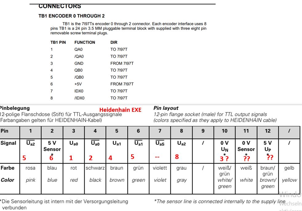

Dear members,
a simple question. I hope, that somebody knows the answer and responds.
I would like to connect 3 Heidenhain glas scales LS303 and 1 Heidenhain rotary sensor ROD450 via the EXEs.
Thanks a lot in advance and best regards
Hartwig
Hartwig
- Posts: 19899
10 Aug 2025 17:58 #333178
Replied by andypugh on topic Heidenhain EXE610 - which MESA board would be needed to connect 4 of them?
Any quadrature encoder counter should work.

- RotarySMP
- Posts: 1635
- Thank you received: 595
11 Aug 2025 06:50 #333198
by RotarySMP
Replied by RotarySMP on topic Heidenhain EXE610 - which MESA board would be needed to connect 4 of them?
I have LS403's with EXE's feeding into the 7i77 on my mill, and a ROD and modern servo's encoders feeding into a 7i85 on the lathe. As Andy said, any of the mesa cards with encoder inputs will work fine.

13 Aug 2025 08:18 - 13 Aug 2025 08:21 #333317
by RotarySMP
The scale has an emitter (LED or bulb) and a receiver , so they both need power and ground, but per the note the power lines (pins 3 and 12) and the grounds grounds (pin 10 and 11) are internally connected. So you just need to supply +5VDC to either pin 3 or 12, and a ground to pin 10 or ll.
You show both Ua1 and Ua2 connected to pin 5 of the Mesa. Ua2 shoud be connected to pin7.
Last edit: 13 Aug 2025 08:21 by RotarySMP.

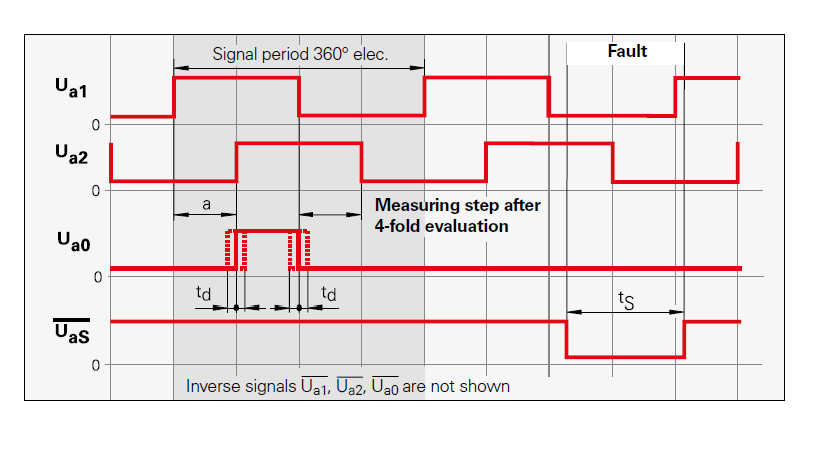

- RotarySMP
- Posts: 1635
13 Aug 2025 08:32 #333319
by RotarySMP
