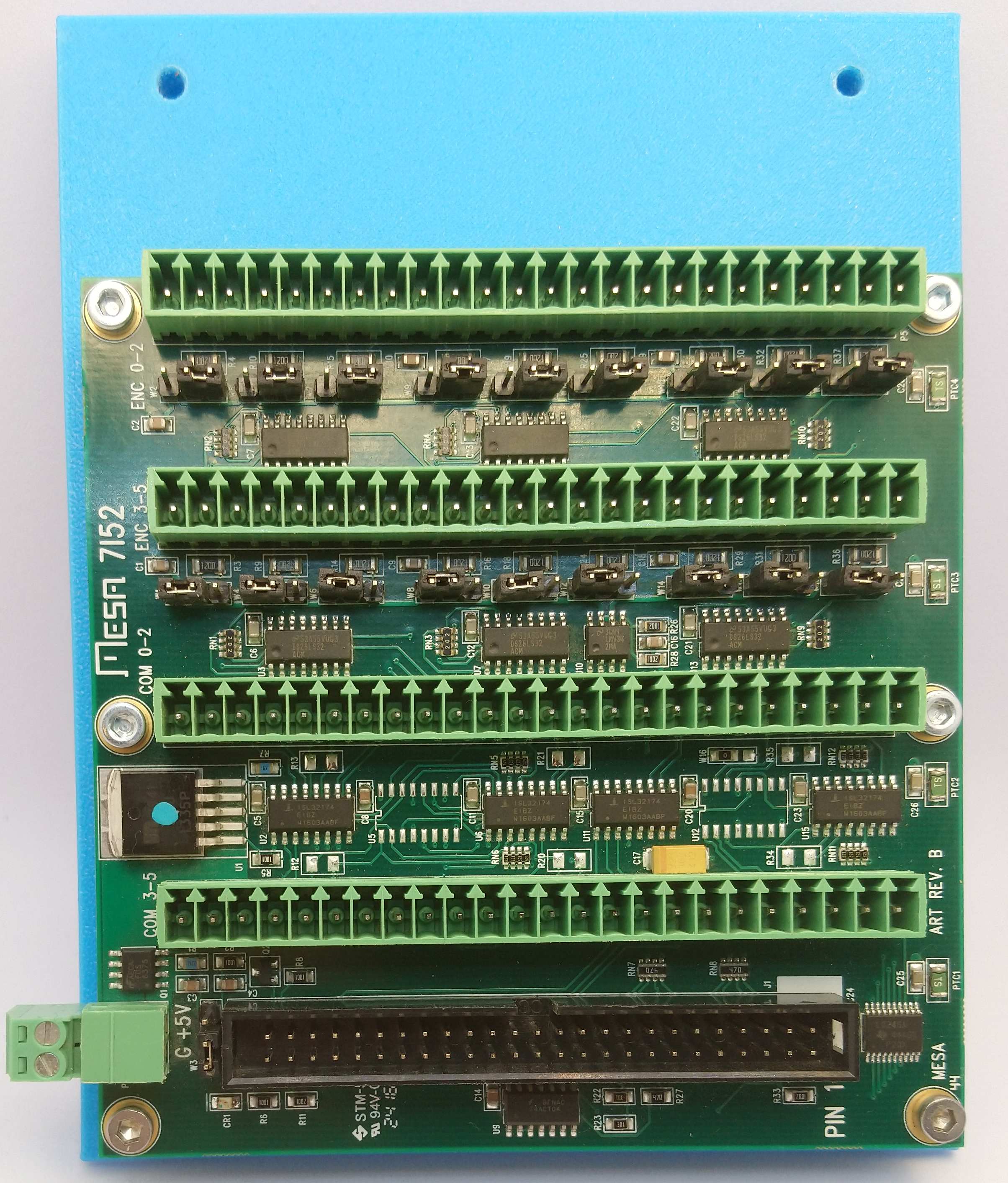

Connect Mesa 6i25 HDR26 with 7I52S HDR50
14 Aug 2025 12:53 - 14 Aug 2025 12:56 #333411 by juergen-home
Connect Mesa 6i25 HDR26 with 7I52S HDR50 was created by juergen-home
So I made something up to connect  6i25 HDR26 with 7I52S HDR50.
Some questions about that:
1. Do I have to connect /TX3BENA and /TX0BENA with i/0 pins and config them to low in the .hal file?
2. Can I pull /TX3BENA and /TX0BENA low to GND to save I/O ports?
3. What reason only Differential outputs TX0B and TX3B can be Tristated, do they have a special purpose?
4. Is ENCMUX managed by the 6i25 or do I have to handle the mux things in the .hal myself?
There are a few more questions but this is enough for today.

14 Aug 2025 14:30 #333416 by PCW
1. No, just ground them
2. See #1
3. Because the 7I52 (which supports RS-422/RS-485 Serial) and 7I52S use the same PCB
4. The FPGA source and HM2 driver support muxed encoders, so as long as the pinout file
    is correct, there's nothing else needed

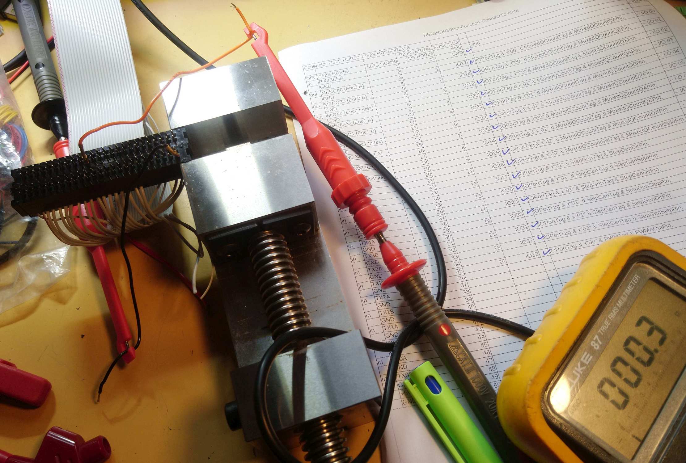

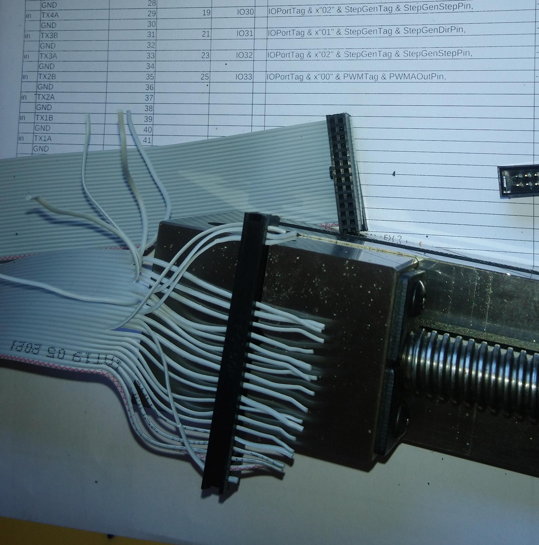

31 Aug 2025 06:59 - 31 Aug 2025 08:38 #334171 by juergen-home
Replied by juergen-home on topic Connect Mesa 6i25 HDR26 with 7I52S HDR50
So the cable is done and the connection seems to work.
Last edit: 31 Aug 2025 08:38 by juergen-home.
