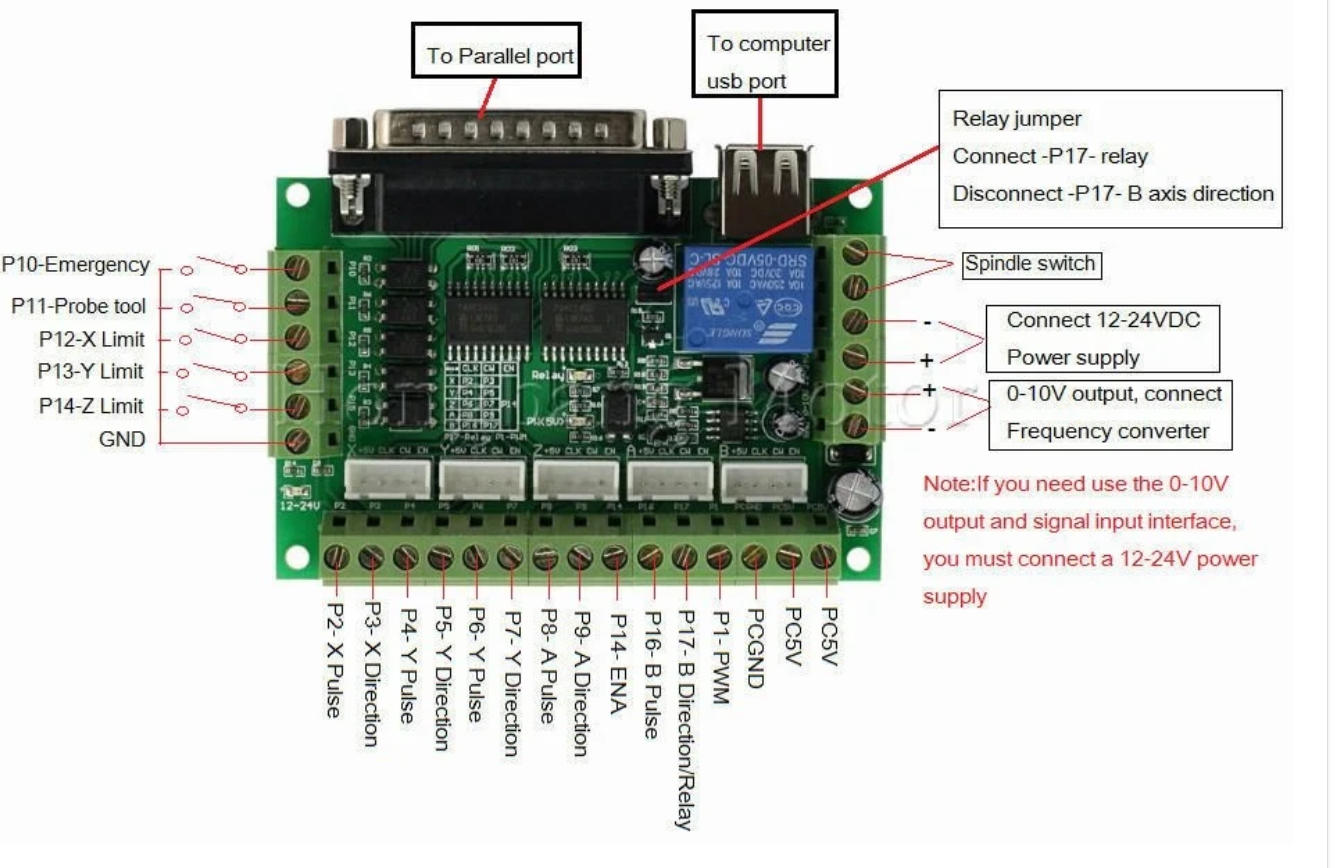

Hello Everyone,
I’m looking for a bitfile for my 6i25 setup with a 7i77 (P3) and a Chinese breakout board (P2).
The breakout board will only be used for stepper control.Does anyone already have a suitable bitfile available, or would be willing to help create one? I’m not yet familiar with making custom bitfiles myself and wouldn’t know where to start, so any help would be greatly appreciated.Thanks in advance!

Replied by PCW on topic Bitfile needed for 6i25 + 7i77 + Chinese BoB
5i25_7i77_5abobd.bit should be correct
