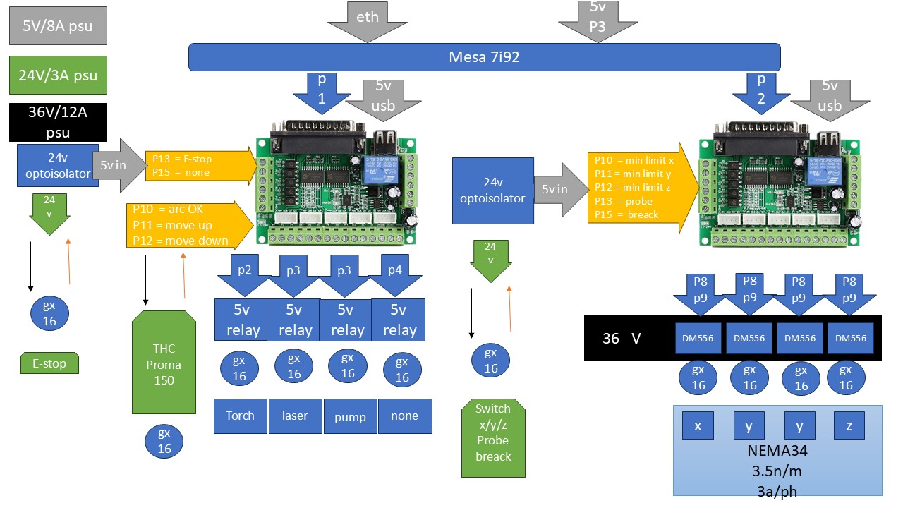

Hello everyone,This is my first post here on the LinuxCNC forum, and also my very first CNC build — so please forgive any mistakes or lack of experience on my part. I'm doing my best to learn as I go.I'm building a plasma CNC machine and using a Mesa 7i92 card. For my setup, I’ll be connecting two 5-axis breakout boards — one on P1 and one on P2. I’m looking for a suitable firmware that would allow me to:
- Use 4 or 5 encoder inputs (for THCAD and potentially other uses)
- Have at least 10 inputs and 5 outputs for general machine control

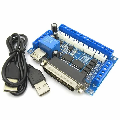

Yes, I'm using the common 5-axis BOBs from china, one on each port (P1 and P2).
That said, I don’t actually need all 10 StepGen channels. My machine only uses 4 axes, so I’m hoping to free up many of the StepGen-related I/O pins and use them as general-purpose I/Os instead.
Also, since the 7i92 headers are mirrored (P1 and P2), both BOBs give access to the same type of GPIO pins. I’m hoping to take advantage of that symmetry and assign more pins for inputs (e.g., limit switches, ArcOK, ohmic probe, thc UP /down etc.), and just a few for outputs (torch on/off, float switch reset, laser etc.).
Ideally, I'd like a bitfile that allows:
At least 10 inputs and 5 outputs for general machine control
Fewer StepGen channels (maybe 4 or 5 max)
If a bitfile like that exists — or if modifying an existing one is straightforward — I’d really appreciate the guidance.

Any stepgen or encoder that is not in use, it's pins can be used as IO, so if you just load
loadrt num_stepgens = 4
that will enable 4 stepgens on the first port (no idea exactly if P1 or P2) and the rest of the 26 pins can be used freely as inputs or as outputs.
Use
mesaflash --card_name --IP --readhmid
replace name and IP with what you have and check the resulting pin assignment so you can decide how many stepgens and encoders you need and what pins they use, from that you know what pin numbers remain for inputs and outputs.
BUT, since you are using BOB's, you will be limited to what the BOB uses as inputs ( 10 in total for encoders and switches) and 24 as outputs.

A picture or link to the actual breakout board you have would be helpful.
As tommylight noted, the common "5 Axis CNC" breakout has 12 outputs
and 5 inputs and this is fixed by the breakout board hardware.

Hi all,Thanks in advance to everyone who responds!I’m using the following HostMot2 bitfile for my Mesa 7i92:

- I only need 4 axes (X, Y1, Y2, Z). Can I use the last StepGen for torch on and laser pointer outputs?
- I do not need encoders. Can I use the QCount pins as general-purpose inputs?
- Can I use the pins labeled “None” or “unassigned” in the bitfile as inputs or outputs, depending on their pin direction?For example, pins 10 and 15 as inputs, and pin 14 as output?
- Are pins 13 and 15 on P2 free to use as I/O?

Hello again everyone,First, I apologize for the late reply — I’ve been working on revising my plan and wiring, and it took longer than expected.I’ve updated my wiring/architecture plan (see attached diagram), and here’s where I’m at:
- Mesa 7i92 over Ethernet
- Two 5-axis breakout boards (5ABOB ×2)
- DM556 drivers for NEMA34 motors (3.5 Nm, 3 A/phase)
- THC Proma 150 for torche height control (Arc OK, Up, Down signals)
- Relays for torch, laser, pump, etc.
- E-stop, limits, probe via optoisolators
- Power supplies: 5 V/8 A, 24 V/3 A, 36 V/12 A
- With that setup (7i92 + 2 × 5ABOB), is the wiring architecture I’m proposing feasible?
- I was thinking of starting with the G540 HAL/INI config in pncconf as a base, then editing it . Is that a sensible approach, or is there a better workflow to generate a clean HAL/INI for this sort of layout?
- Posts: 22006
- Thank you received: 7490
26 Sep 2025 12:42 #335453
Replied by tommylight on topic Firmware Request for 7i92 – Plasma CNC Build
1. yes
2. yes
2. yes
The following user(s) said Thank You: souh-hil
