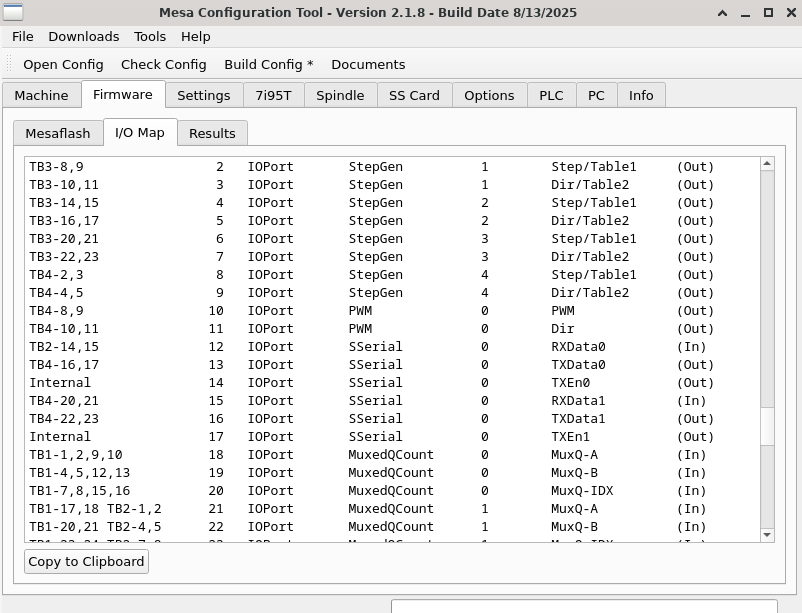

Hi everyone,
this is my first time using LinuxCNC and a Mesa board. I received my 7i95T a few days ago and have been running several tests since then.
I installed LinuxCNC 2.9.4 on an old desktop PC and everything runs smoothly. After that, I updated the system and installed the Mesa Configuration Tool, since I read that the 7i95T cannot be configured with the standard PNCconf wizard.I successfully connected to the board using the default IP address 192.168.1.121, and the PC communicates with it correctly.
Because I need a PWM output for my 0–10 V analog converter (my VFD does not support RS-485 unfortunately), I downloaded the appropriate firmware, flashed it to the board, and the update went fine.
After completing the basic configuration, I switched the GUI to qtDragon_hd for a better interface. LinuxCNC loads without errors, and I was able to test one axis (stepper + proximity sensor) without issues.Where I’m stuck: PWM generationReading the HMIDs, I can see that the last stepgen has been replaced by a PWM generator, but I’m not understanding how to properly use this PWM output.Here’s what I tried:
Also, I would also like to use my MPG wheel.
My idea is:
Thanks a lot to everyone in advance!
- I connected the PWM signal to pin 9 on the 7i95T header.
- I left the DIR pin disconnected for now because I only need the spindle to run clockwise.
- I connected my 0–10 V PWM-to-analog converter, but no voltage output appears.
- I also tried checking the signal using an oscilloscope, but I get no PWM activity at all.
- I misconfigured the PWM generator in LinuxCNC/HAL,
- I am misunderstanding how the PWM output on the 7i95T is supposed to work.
My idea is:
- connect the MPG encoder to the left-side encoder input (ENC0),
- connect the MPG pushbuttons and the selector to the input pins on the right side, according to the Mesa Config Tool assignments.

Can you post your current hal/ini files?

# SPINDLE PWM - MESA 7i95T pwmgen.00
# Imposto la frequenza PWM hardware (valore tipico 10 kHz)
# Usa il parametro dall'INI [SPINDLE_0](PWM_FREQUENCY)
setp hm2_[MESA](BOARD).0.pwmgen.pwm_frequency [SPINDLE_0](PWM_FREQUENCY)
# pwmgen.00: PWM su Out0, direzione su Out1 (che puoi anche non usare)
setp hm2_[MESA](BOARD).0.pwmgen.00.output-type 1
# Scala: valore in ingresso = RPM, duty = RPM / SCALE
# Esempio: SCALE = 24000 => 24000 rpm = 100% duty
setp hm2_[MESA](BOARD).0.pwmgen.00.scale [SPINDLE_0](SCALE)
# --- Collegamento con il motion ---
# Abilitazione PWM: attivo quando lo spindle è "on" (M3/M4)
net spindle-enable motion.spindle-on => hm2_[MESA](BOARD).0.pwmgen.00.enable
# Comando velocità in RPM dal planner
net spindle-speed-cmd-rpm motion.spindle-speed-out => hm2_[MESA](BOARD).0.pwmgen.00.value

[MESA]
VERSION = 2.1.8
BOARD = 7i95
BOARD_NAME = 7i95t
FIRMWARE = 7i95t_1pwmd.bin
CARD_0 = None

Hal file
# This file was created with the Mesa Configuration Tool on nov 15 2025 15:24:04
# If you make changes to this file DO NOT run the configuration tool again!
# This file will be replaced with a new file if you do!
# kinematics
loadrt [KINS](KINEMATICS)
# motion controller
loadrt [EMCMOT](EMCMOT) servo_period_nsec=[EMCMOT](SERVO_PERIOD) num_joints=[KINS](JOINTS)
# hostmot2 driver
loadrt hostmot2
loadrt [HM2](DRIVER) board_ip=[HM2](ADDRESS) config="num_encoders=6 num_pwmgens=1 num_stepgens=6 sserial_port_0=00000000"
setp hm2_[MESA](BOARD).0.watchdog.timeout_ns 10000000
loadrt pid names=pid.x,pid.y,pid.z
# PID Information for Stepper Boards
# Mesa hardware step generators at every servo thread invocation, the step
# generator hardware is given a new velocity. Without feedback from the PID
# controller the hardware position would slowly drift because of clock speed and
# timing differences between LinuxCNC and the step generator hardware.
# The PID controller gets feedback from the actual (fractional) step position and
# corrects for these small differences.
# THREADS
addf hm2_[MESA](BOARD).0.read servo-thread
addf pid.y.do-pid-calcs servo-thread
addf hm2_[MESA](BOARD).0.write servo-thread
# DPLL TIMER
setp hm2_[MESA](BOARD).0.dpll.01.timer-us -200
setp hm2_[MESA](BOARD).0.stepgen.timer-number 1
# amp enable
net motion-enable <= motion.motion-enabled
# Board: 7i95
# Axis: X Joint: 0 Output: 0
# PID Setup
setp pid.x.Pgain [JOINT_0](P)
setp pid.x.Igain [JOINT_0](I)
setp pid.x.Dgain [JOINT_0](D)
setp pid.x.bias [JOINT_0](BIAS)
setp pid.x.FF0 [JOINT_0](FF0)
setp pid.x.FF1 [JOINT_0](FF1)
setp pid.x.FF2 [JOINT_0](FF2)
setp pid.x.deadband [JOINT_0](DEADBAND)
setp pid.x.maxoutput [JOINT_0](MAX_OUTPUT)
setp pid.x.error-previous-target True
# limit stepgen velocity corrections caused by position feedback jitter
setp pid.x.maxerror [JOINT_0](MAX_ERROR)
# joint-0 enable chain
net joint-0-index-enable <=> pid.x.index-enable
net joint-0-index-enable <=> joint.0.index-enable
net joint-0-enable <= joint.0.amp-enable-out
net joint-0-enable => pid.x.enable
net joint-0-enable => hm2_[MESA](BOARD).0.stepgen.00.enable
# Joint 0 Step Generator Settings
setp hm2_[MESA](BOARD).0.stepgen.00.dirsetup [JOINT_0](DIRSETUP)
setp hm2_[MESA](BOARD).0.stepgen.00.dirhold [JOINT_0](DIRHOLD)
setp hm2_[MESA](BOARD).0.stepgen.00.steplen [JOINT_0](STEPLEN)
setp hm2_[MESA](BOARD).0.stepgen.00.stepspace [JOINT_0](STEPSPACE)
setp hm2_[MESA](BOARD).0.stepgen.00.position-scale [JOINT_0](SCALE)
setp hm2_[MESA](BOARD).0.stepgen.00.maxvel [JOINT_0](STEPGEN_MAX_VEL)
setp hm2_[MESA](BOARD).0.stepgen.00.maxaccel [JOINT_0](STEPGEN_MAX_ACC)
setp hm2_[MESA](BOARD).0.stepgen.00.step_type 0
setp hm2_[MESA](BOARD).0.stepgen.00.control-type 1
# position command and feedback
net joint-0-pos-cmd <= joint.0.motor-pos-cmd
net joint-0-pos-cmd => pid.x.command
net joint-0-pos-fb <= hm2_[MESA](BOARD).0.stepgen.00.position-fb
net joint-0-pos-fb => joint.0.motor-pos-fb
net joint-0-pos-fb => pid.x.feedback
# PID Output
net joint.0.output <= pid.x.output
net joint.0.output => hm2_[MESA](BOARD).0.stepgen.00.velocity-cmd
# Axis: Y Joint: 1 Output: 1
# PID Setup
setp pid.y.Pgain [JOINT_1](P)
setp pid.y.Igain [JOINT_1](I)
setp pid.y.Dgain [JOINT_1](D)
setp pid.y.bias [JOINT_1](BIAS)
setp pid.y.FF0 [JOINT_1](FF0)
setp pid.y.FF1 [JOINT_1](FF1)
setp pid.y.FF2 [JOINT_1](FF2)
setp pid.y.deadband [JOINT_1](DEADBAND)
setp pid.y.maxoutput [JOINT_1](MAX_OUTPUT)
setp pid.y.error-previous-target True
setp pid.y.maxerror [JOINT_1](MAX_ERROR)
# joint-1 enable chain
net joint-1-index-enable <=> pid.y.index-enable
net joint-1-index-enable <=> joint.1.index-enable
net joint-1-enable <= joint.1.amp-enable-out
net joint-1-enable => pid.y.enable
net joint-1-enable => hm2_[MESA](BOARD).0.stepgen.01.enable
# Joint 1 Step Generator Settings
setp hm2_[MESA](BOARD).0.stepgen.01.dirsetup [JOINT_1](DIRSETUP)
setp hm2_[MESA](BOARD).0.stepgen.01.dirhold [JOINT_1](DIRHOLD)
setp hm2_[MESA](BOARD).0.stepgen.01.steplen [JOINT_1](STEPLEN)
setp hm2_[MESA](BOARD).0.stepgen.01.stepspace [JOINT_1](STEPSPACE)
setp hm2_[MESA](BOARD).0.stepgen.01.position-scale [JOINT_1](SCALE)
setp hm2_[MESA](BOARD).0.stepgen.01.maxvel [JOINT_1](STEPGEN_MAX_VEL)
setp hm2_[MESA](BOARD).0.stepgen.01.maxaccel [JOINT_1](STEPGEN_MAX_ACC)
setp hm2_[MESA](BOARD).0.stepgen.01.step_type 0
setp hm2_[MESA](BOARD).0.stepgen.01.control-type 1
net joint-1-pos-cmd <= joint.1.motor-pos-cmd
net joint-1-pos-cmd => pid.y.command
net joint-1-pos-fb <= hm2_[MESA](BOARD).0.stepgen.01.position-fb
net joint-1-pos-fb => joint.1.motor-pos-fb
net joint-1-pos-fb => pid.y.feedback
# PID Output
net joint.1.output <= pid.y.output
net joint.1.output => hm2_[MESA](BOARD).0.stepgen.01.velocity-cmd
# Axis: Z Joint: 2 Output: 2
# PID Setup
setp pid.z.Pgain [JOINT_2](P)
setp pid.z.Igain [JOINT_2](I)
setp pid.z.Dgain [JOINT_2](D)
setp pid.z.bias [JOINT_2](BIAS)
setp pid.z.FF0 [JOINT_2](FF0)
setp pid.z.FF1 [JOINT_2](FF1)
setp pid.z.FF2 [JOINT_2](FF2)
setp pid.z.deadband [JOINT_2](DEADBAND)
setp pid.z.maxoutput [JOINT_2](MAX_OUTPUT)
setp pid.z.error-previous-target True
setp pid.z.maxerror [JOINT_2](MAX_ERROR)
# joint-2 enable chain
net joint-2-index-enable <=> pid.z.index-enable
net joint-2-index-enable <=> joint.2.index-enable
net joint-2-enable <= joint.2.amp-enable-out
net joint-2-enable => pid.z.enable
net joint-2-enable => hm2_[MESA](BOARD).0.stepgen.02.enable
# Joint 2 Step Generator Settings
setp hm2_[MESA](BOARD).0.stepgen.02.dirsetup [JOINT_2](DIRSETUP)
setp hm2_[MESA](BOARD).0.stepgen.02.dirhold [JOINT_2](DIRHOLD)
setp hm2_[MESA](BOARD).0.stepgen.02.steplen [JOINT_2](STEPLEN)
setp hm2_[MESA](BOARD).0.stepgen.02.stepspace [JOINT_2](STEPSPACE)
setp hm2_[MESA](BOARD).0.stepgen.02.position-scale [JOINT_2](SCALE)
setp hm2_[MESA](BOARD).0.stepgen.02.maxvel [JOINT_2](STEPGEN_MAX_VEL)
setp hm2_[MESA](BOARD).0.stepgen.02.maxaccel [JOINT_2](STEPGEN_MAX_ACC)
setp hm2_[MESA](BOARD).0.stepgen.02.step_type 0
setp hm2_[MESA](BOARD).0.stepgen.02.control-type 1
net joint-2-pos-cmd <= joint.2.motor-pos-cmd
net joint-2-pos-cmd => pid.z.command
net joint-2-pos-fb <= hm2_[MESA](BOARD).0.stepgen.02.position-fb
net joint-2-pos-fb => joint.2.motor-pos-fb
net joint-2-pos-fb => pid.z.feedback
# PID Output
net joint.2.output <= pid.z.output
net joint.2.output => hm2_[MESA](BOARD).0.stepgen.02.velocity-cmd
# Manual Tool Change Dialog
net tool-number hal_manualtoolchange.number <= iocontrol.0.tool-prep-number
net tool-change-request hal_manualtoolchange.change <= iocontrol.0.tool-change
net tool-change-confirmed iocontrol.0.tool-changed => hal_manualtoolchange.changed
# tool prep loopback
net tool-prep-loop iocontrol.0.tool-prepare => iocontrol.0.tool-prepared
ini file
# This file was updated with the Mesa Configuration Tool on nov 15 2025 15:24:04
# Changes to most things are ok and will be read by the Configuration Tool
[MESA]
VERSION = 2.1.8
BOARD = 7i95
BOARD_NAME = 7i95t
CARD_0 = None
CARD_1 = None
[EMC]
VERSION = 1.1
MACHINE = Mesa_7i95t
DEBUG = 0x00000000
[HM2]
DRIVER = hm2_eth
ADDRESS = 192.168.1.121
[DISPLAY]
DISPLAY = qtvcp qtdragon_hd
EDITOR = geany
PROGRAM_PREFIX = /home/linuxcnc/linuxcnc/nc_files
POSITION_OFFSET = RELATIVE
POSITION_FEEDBACK = COMMANDED
MAX_FEED_OVERRIDE = 1.5
MIN_LINEAR_VELOCITY = 0.0
DEFAULT_LINEAR_VELOCITY = 1.5
MAX_LINEAR_VELOCITY = 80.0
INCREMENTS = 10mm , 5mm , 1mm , 0.5mm , 0.1mm , 0.05mm , 0.01mm
CYCLE_TIME = 0.1
INTRO_TIME = 0
OPEN_FILE = ""
[KINS]
KINEMATICS = trivkins coordinates=XYZ
JOINTS = 3
[EMCIO]
