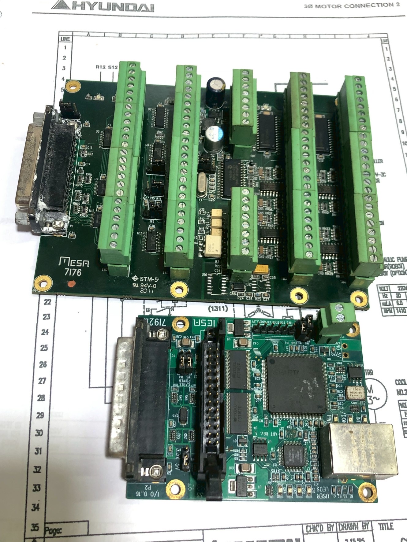

7i92M + 7i76 add PWM+PktUART was created by SOLD
Hello PCW,I am using a Mesa 7i96M with a 7i76, and I would like to ask a question regarding firmware configuration before requesting any custom bitfile.Question:
Is it possible for PktUART to be used instead of SSerial in a 7i96M firmware configuration?
I would like to understand whether PktUART can be implemented in place of SSerial, or if SSerial is architecturally fixed and not interchangeable.If this is feasible, I would like to request a custom bitfile with the following changes:
- Replace SSerial with PktUART
- Repurpose STEP5 (unused in my system) as a PWM output
- Keep all other functions the same as the standard 7i96M + 7i76 firmware
Last edit: 07 Jan 2026 01:17 by SOLD.

28 Jan 2026 06:47 - 28 Jan 2026 06:49 #342079
by SOLD
Replied by SOLD on topic 7i92M + 7i76 add PWM+PktUART
Hello PCW,
I would like to ask for guidance regarding a firmware issue with a Mesa 7i92 + 7i76 system, and clarify the exact sequence of events.
LinuxCNC reported the following warning:
hm2/hm2_7i92.0: Warning: sserial remote device 7i76 channel 0 has old firmware that should be updated
Based on this warning, I attempted to update the Smart-Serial firmware.
At that time, I assumed that 7I76U.BIN could be used as a compatible replacement and used it to update the 7i76. This was a deliberate decision made in response to the hm2 warning, not an accidental flash.
After this, the system no longer behaves as expected.
Current status:
7i92 Ethernet communication works normally.
The Smart-Serial port responds and reports SSLBP version, channel count, and baud rate.
I reflashed with 7i92_7i76x1D.bit, followed by a full power cycle.
The W3 jumper on the 7i76 has been changed as recommended.
Attempting to rewrite 7I76R14.BIN via mesaflash produces no errors, however there is no explicit indication that a firmware rewrite actually occurred, and the observable behavior of the board does not change.
Is there any supported recovery method for a 7i76 in this condition, assuming access to a working Smart-Serial master (7i92)?
Current status:

Error flag set after CMD Clear 00000001
Firmware Flash Failed
setsserial: rtapi_app_main: Operation not permitted (-1)
setsserial: not loaded
<commandline>:0: exit value: 255
<commandline>:0: rmmod failed, returned -1
hm2_eth: in hm2_eth_reset
hm2_eth: HostMot2 ethernet driver unloaded
hm2: unloading
<commandline>:0: unloadrt failed

Replied by PCW on topic 7i92M + 7i76 add PWM+PktUART
Unfortunately the 7I76U uses a complete different processor
with different firmware memory layout so I expect the only way
to recover is with a (newer) PIC programmer.
The following user(s) said Thank You: SOLD

Is restoring a 7i76 by externally reprogramming the dsPIC with the proper 7I76R14 image theoretically possible
If recovery requires a Mesa-provided programming image or process, is there any form of guidance or support you can offer? I fully understand if this is not something Mesa can support or disclose.
The 7I76R14.BIN image will not work as there are two program images
in the DSPIC code (the setup and working images) This is done to allow
live updates.
This is the complete 7I76 image:
live updates.
Last edit: 29 Jan 2026 11:16 by PCW.
