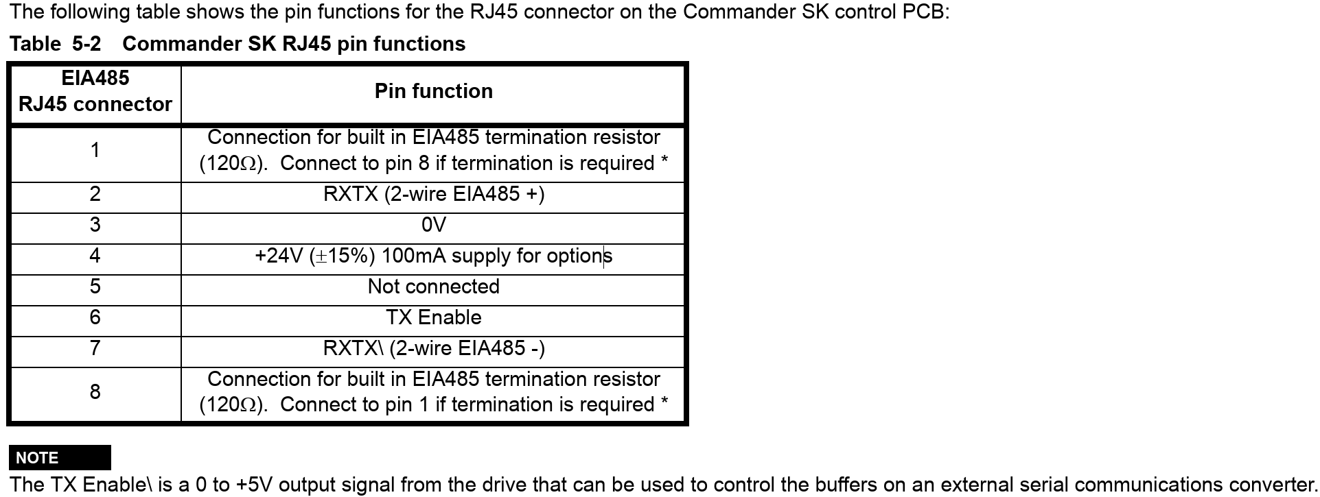

Connected CommanderSK VFD RS485 to 7i96 connector.
Docs at linuxcnc.org/docs/2.9/html/drivers/mesa_modbus.html state:6. Hardware ConnectionThe Mesa serial ports have separate pins for Tx and Tx pairs. For RS422 Modbus RTU communications these should be connected at the Mesa card Tx+ to Rx+ and Tx- to Rx-.Note that there are differing naming standards for Modbus pins. Typically Rx+ and TX+ will connect to the B- pin on the modbus device and Rx- and Tx- will connect to the A+ pin, i.e., +/- will appear reversed.
Is RS485 wired the same way?
My working USB/485 dongle solution connects:
RJ45 USB Dongle
2 EIA485+ A+
3 0V GND
7 EIA485- B-
So I have connected EIA485 to Mesa TX- and RX-, EIA485- to Mesa TX+ and RX+, 0V to Mesa GND.
I set up CommanderSK.mbccs to simply read the software version from the vfd. This fails with a "Received PDU too small, size=4"
I have tried hal_types HAL_FLOAT, HAL_U32 with the same result.
Any hints before I bring out the scope?

8 months 1 week ago #343373
Replied by PCW on topic hm2_modbus pktuart, probably a firmware request?
Here's the wiring information: (just added to 7I96 manual)
RS-485 OPERATION
For 2 wire RS-485 applications, TX+ must be connected to RX+ and TX- must be
connected to RX-. RS-485 pair wiring is TX-/RX- to A and TX+/RX+ to B.
For RS-485 applications, 7I96 cards require two biasing resistors to establish the
non-driven state of RS-485 interfaces (MODBUS etc). The first resistor should connect
between +5V and RX- and the second between GND and RX+. Suggested resistor value
is 330 Ohms.

8 months 1 week ago #343375
by jtrantow
Replied by jtrantow on topic hm2_modbus pktuart, probably a firmware request?
Thanks, that makes sense. R's must be built into the usb adapter.
I will add termination resistors and give that a try.

8 months 1 week ago #343431
by jtrantow
I added the RS485 termination resistors and I'm successfully talking to the VFD.
