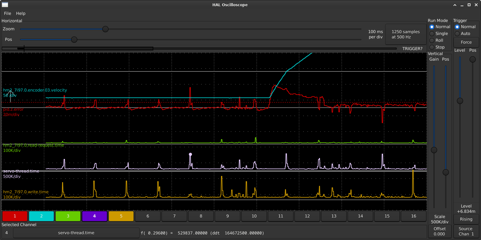

Hello.
I'm having hard time getting Linuxcnc run without "Unexpected realtime delay on task 0 with period 1000000". What I have tried so far is the "regular" isolcpu approach:
GRUB_CMDLINE_LINUX_DEFAULT="quiet splash isolcpus=5 nohz_full=5 rcu_nocbs=5 irqaffinity=0-4 intel_idle.max_cstate=1 processor.max_cstate=1"
Also tried to isolate cpu number 4, no difference.
packet error-total stays at 0.
I tried to add [HMOT](CARD0).read-request servo-threadin the end of the servo-thread. That makes read.tmax drop significantly and realtime delay error does not appear but causes weird spiking in servo-thread.time when any of the axis(or spindle) is moving. The spikes also appear as joint following error. So maybe it's only hiding the problem from servo-thread?
Here are .tmax's, i know theres a lot of them but the problem was there right from the beginning when there were not so many.

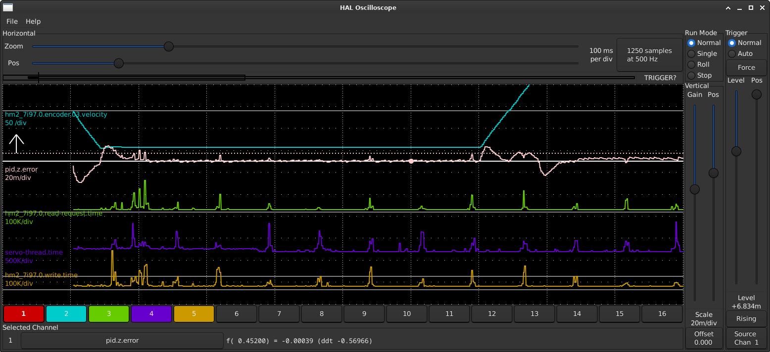

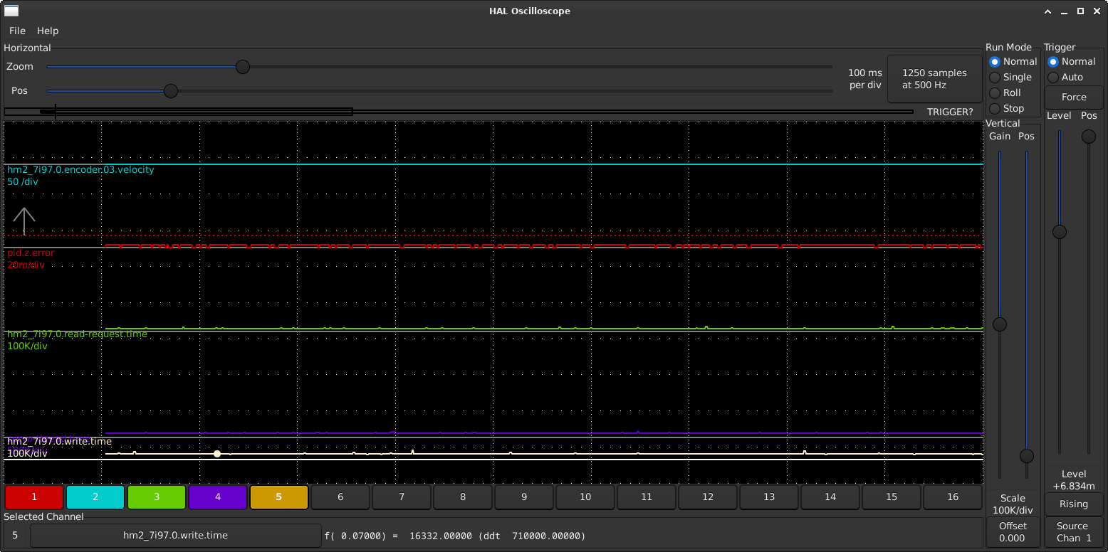

Halscope screenshots of spiking attached. These are captured having [HMOT](CARD0).read-request at the beginning and at the end of servo-thread. The following error spikes go crazy when read-request at the end but also visible when at the beginning. When servos are stationary no spiking.

I just managed to verify the cause for the spikes visible in halscope. They appear to happen the same interval than the pyvcp graphics refresh. I just can't figure out if it's more of a symptom than a cause.

The spikes in following error were indeed caused by graphics. It settled down when I removed one of 2 screens I had attached. Realtime delay error persists though.
