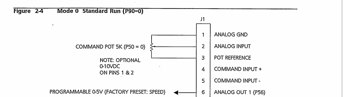

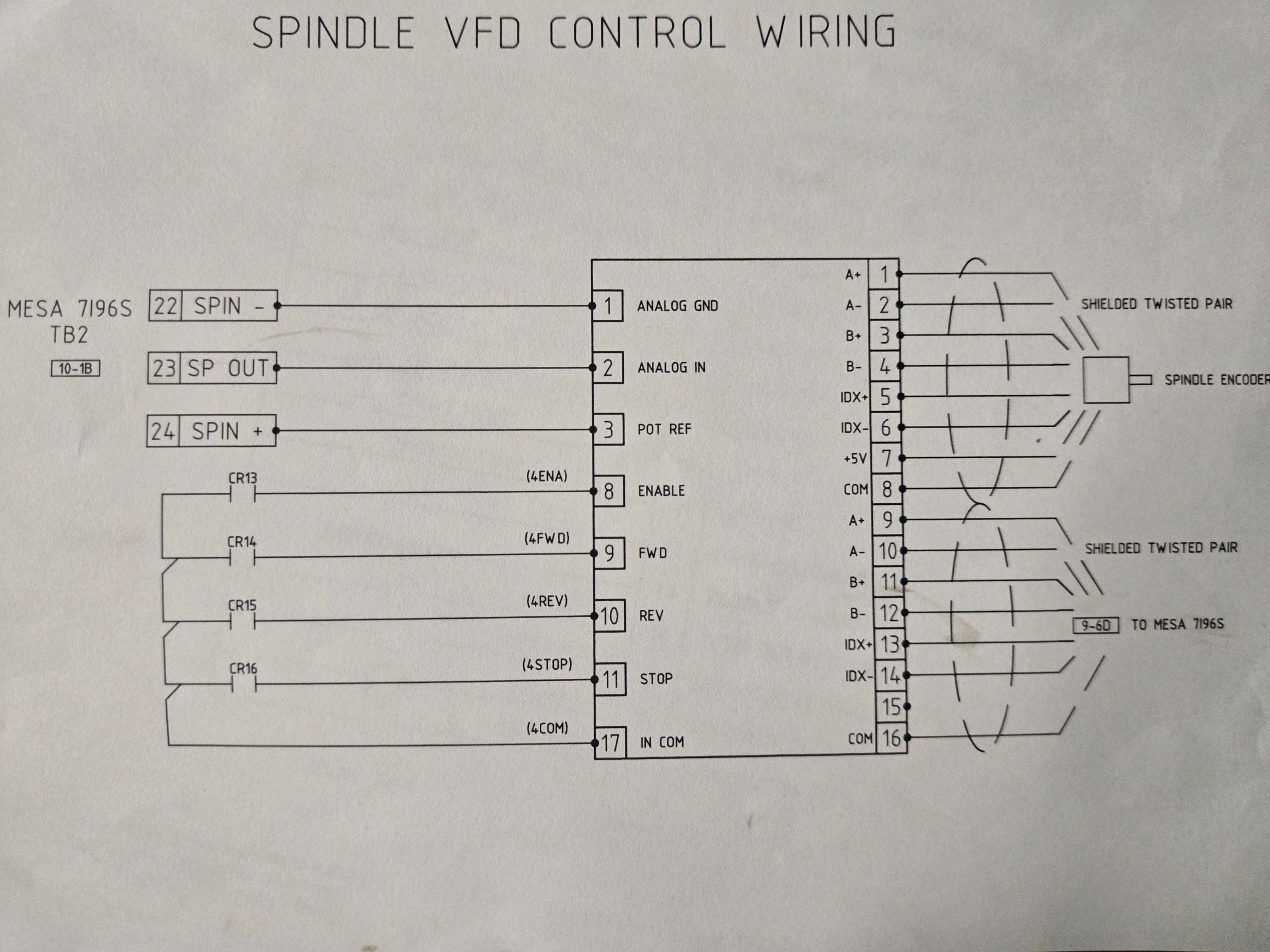

Stuck on the analog spindle output now. The drive im using requires 0-10v and an enable/fwd/rev command. Attached is how I wired it and a snip of the drive wiring diagram.
