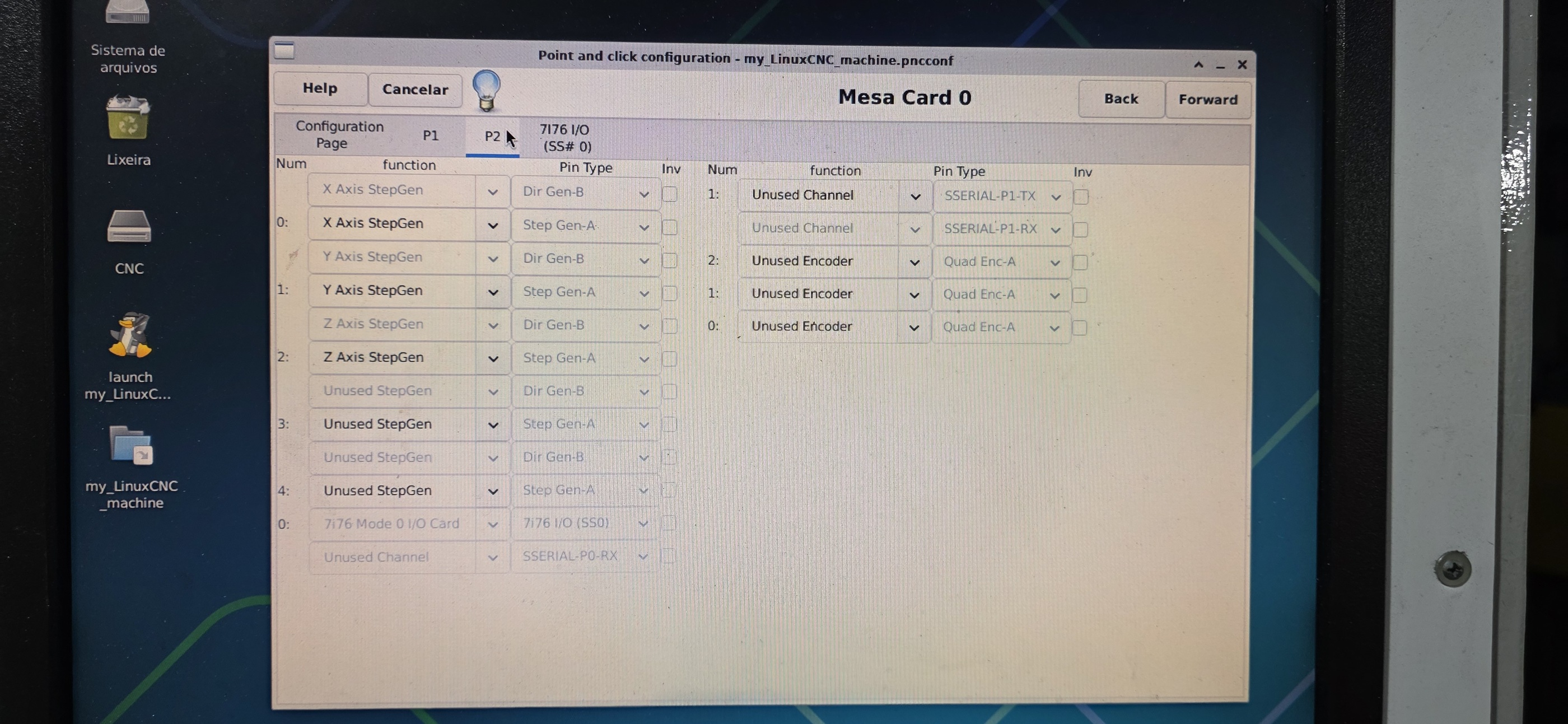

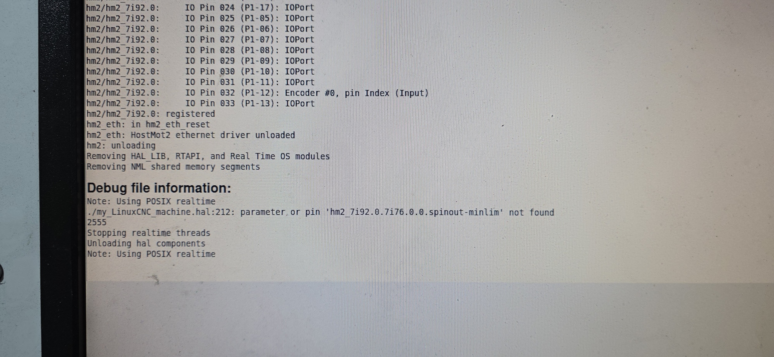

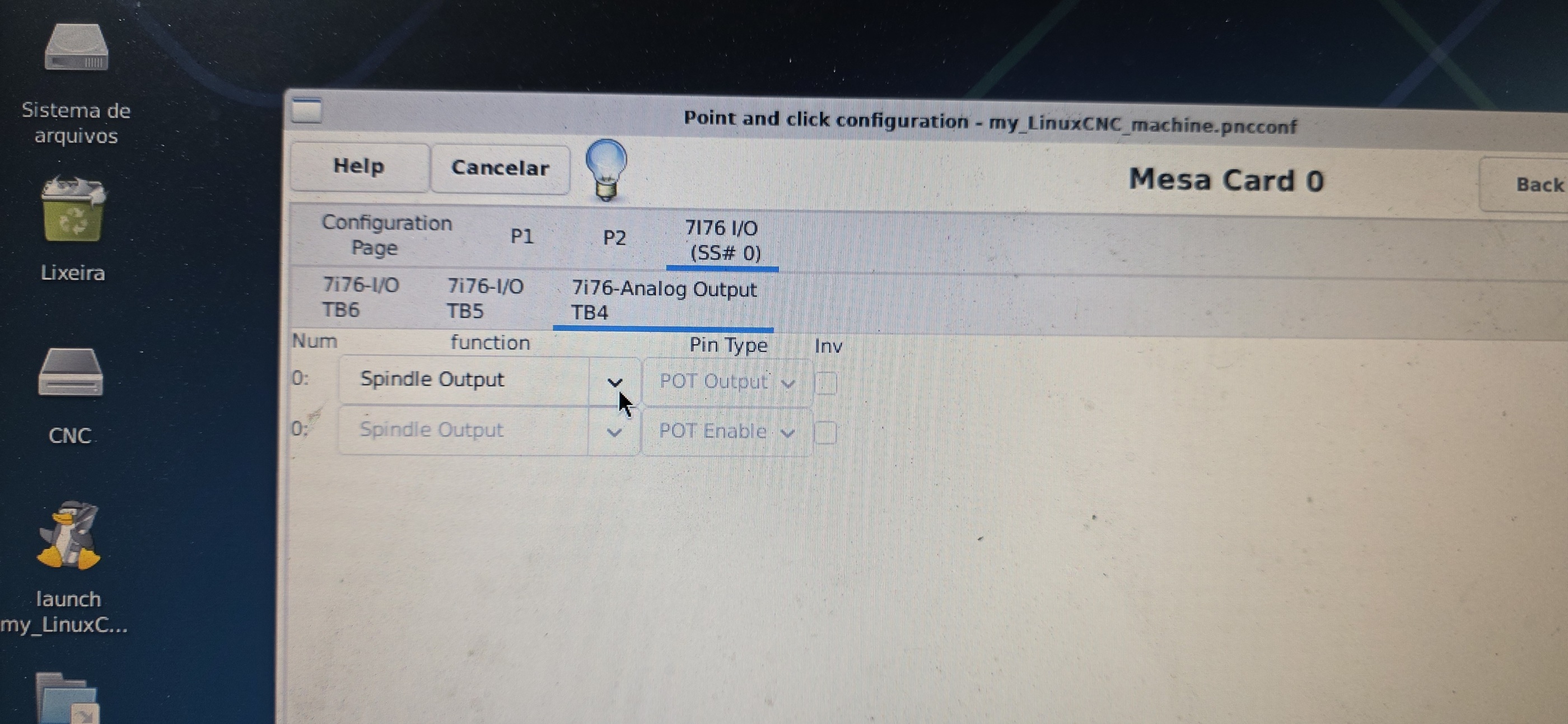

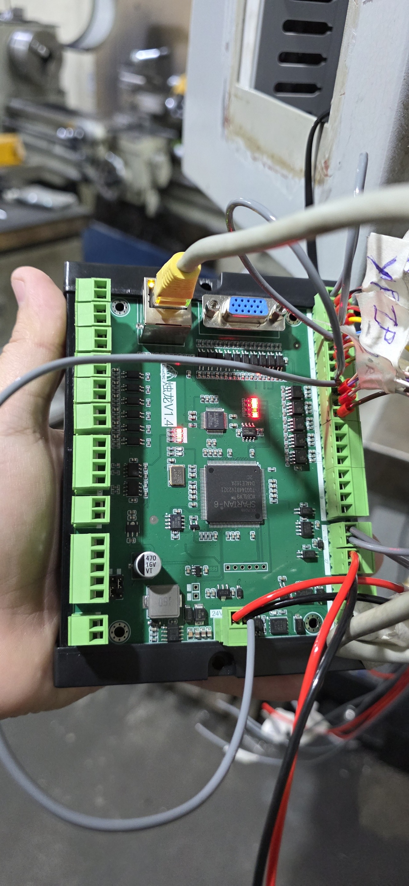

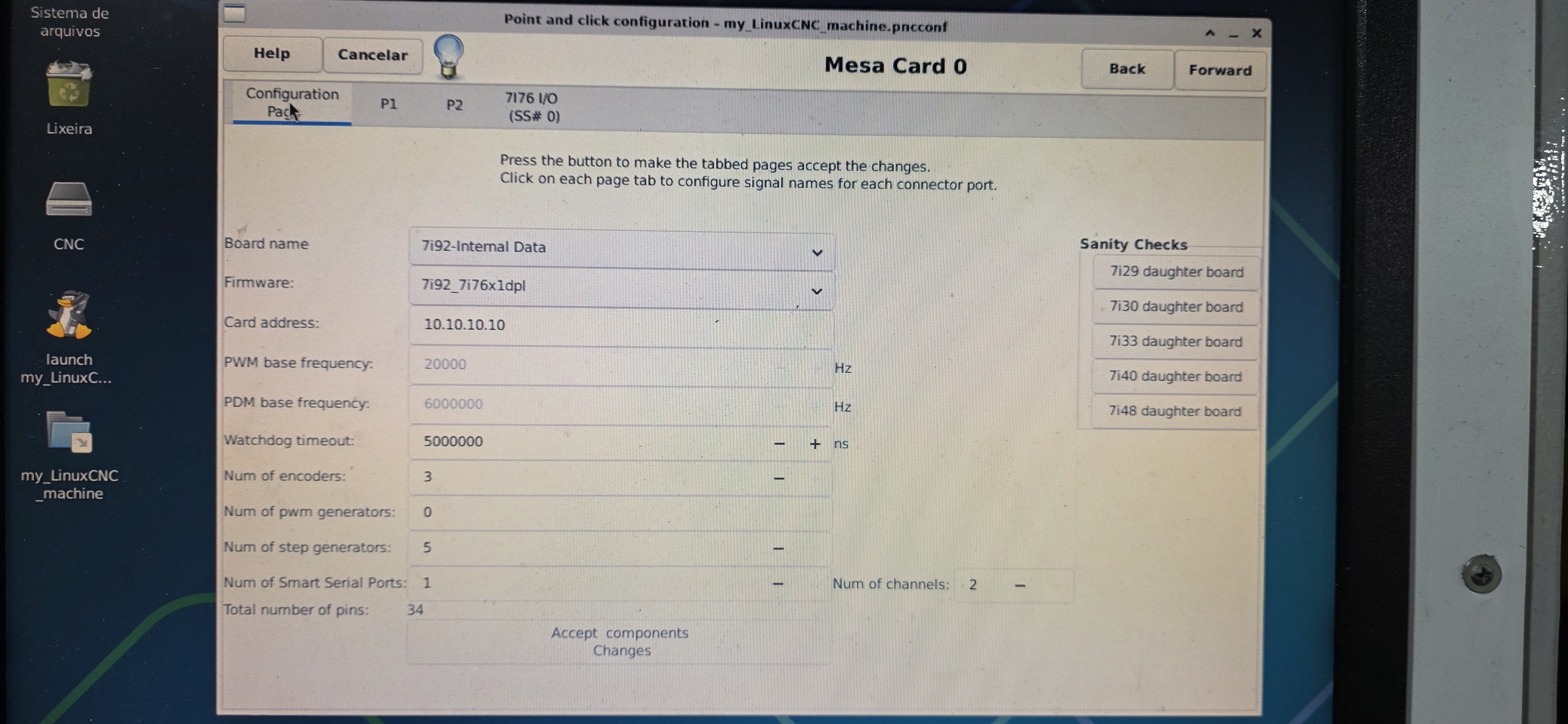

Hello,
I am having a problem configuring the 7I92 card that I bought on AliExpress.
From what I understand, it's a cloned card. My problem occurs when I configure the P1 and 7i76-Analog Output tabs, the error appears as shown in the last photo.
However, when I only configure the P2 tab, nothing happens; the card works and the EasyServo devices operate.
Now I need to configure other outputs to make the motor or spindle work, but this error occurs.
Has anyone else experienced a similar problem?

Replied by PCW on topic Configure 7I92 Zhulong card on AliExpress.
Unless you have a 7I76, some way to connect to it (which that card does not provide),
and 7I76 compatible firmware installed. you cannot use that configuration.
You should be able to get closer with a G540X2 configuration in pncconf or
using pncconfs "Discover" option.

Replied by feng on topic Configure 7I92 Zhulong card on AliExpress.
pncconfOn the second page of PNCconf, check the advanced options box, then select the last item under Board name. Next, click to detect the board and fill in the board module information. PNCconf will read the board’s data, after which you can proceed with the configuration.

Replied by cob.charles on topic Configure 7I92 Zhulong card on AliExpress.
thanks a lot!!! It solved my problem. Something simple, and it took me days to figure it out.

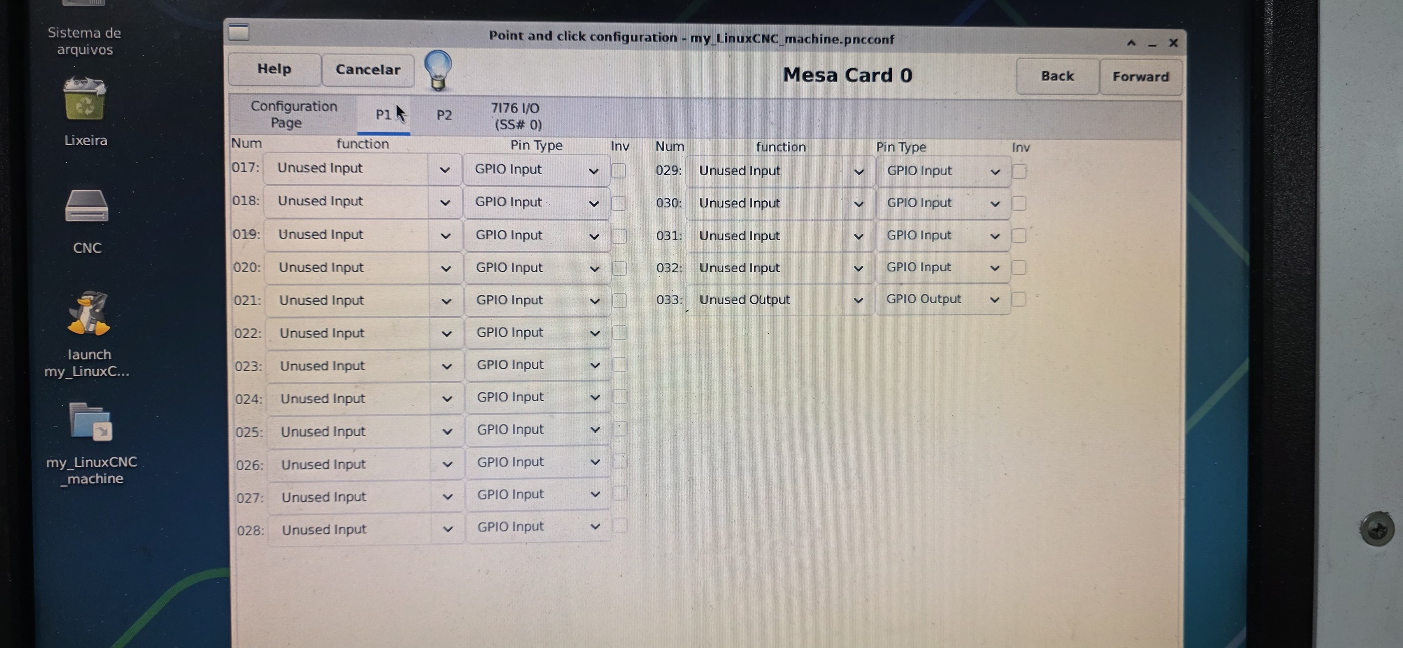

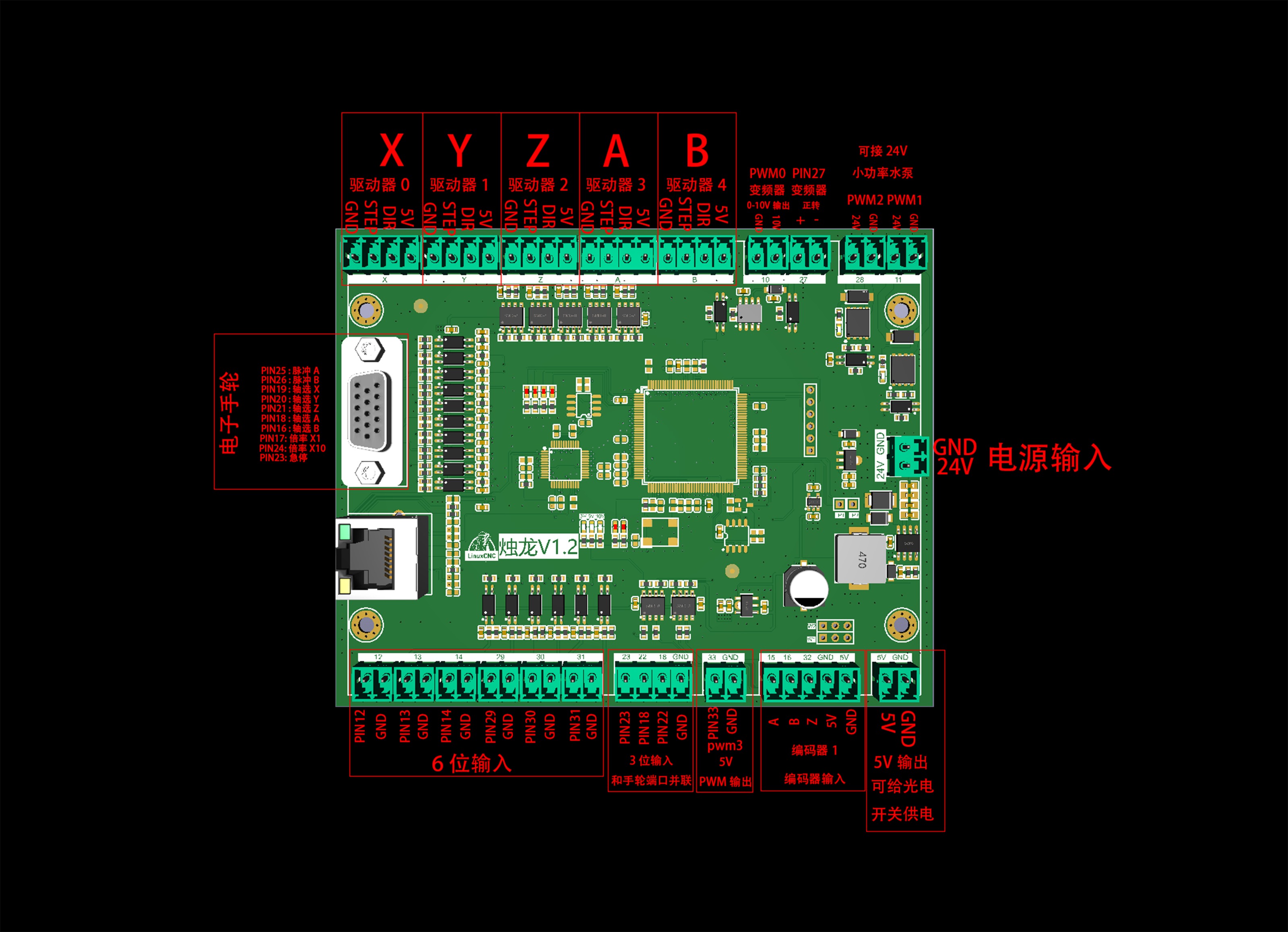

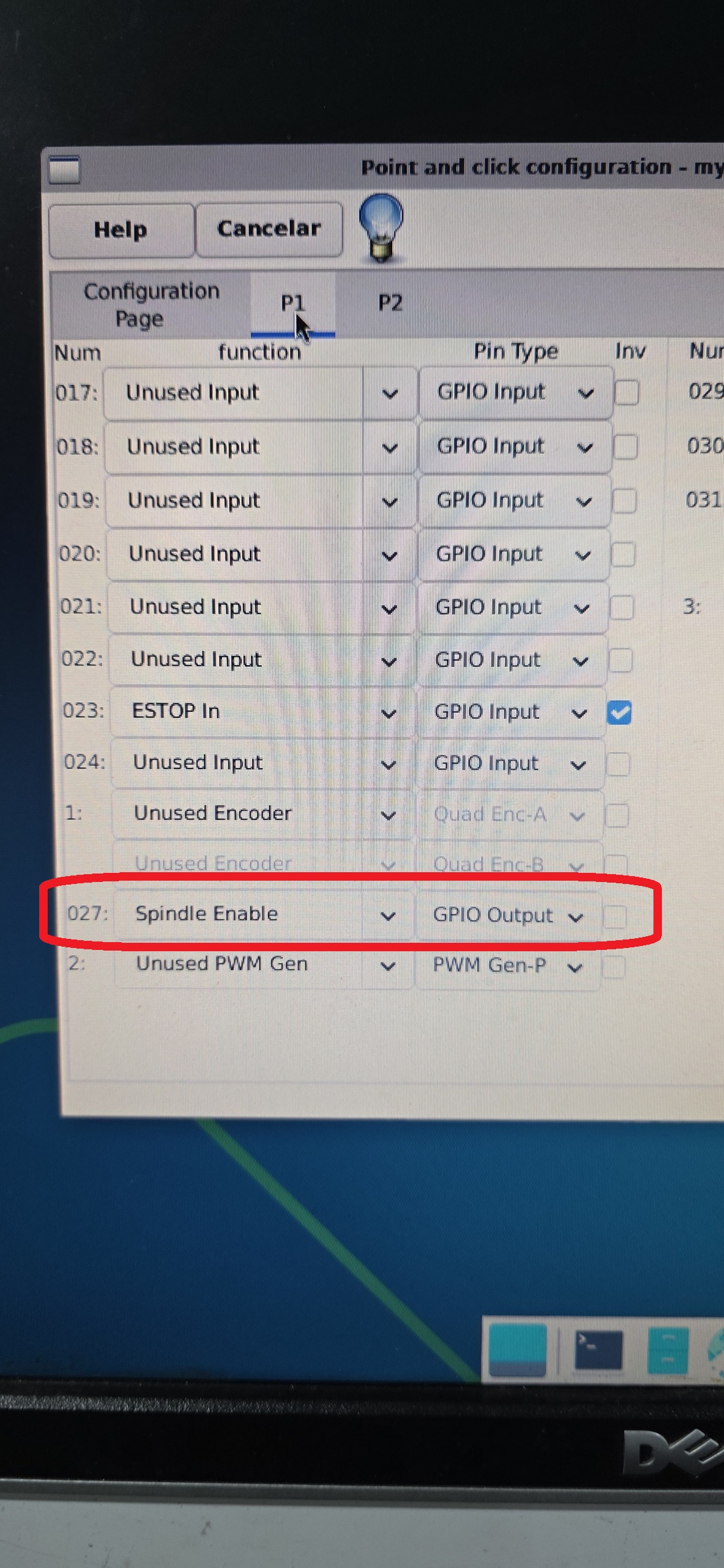

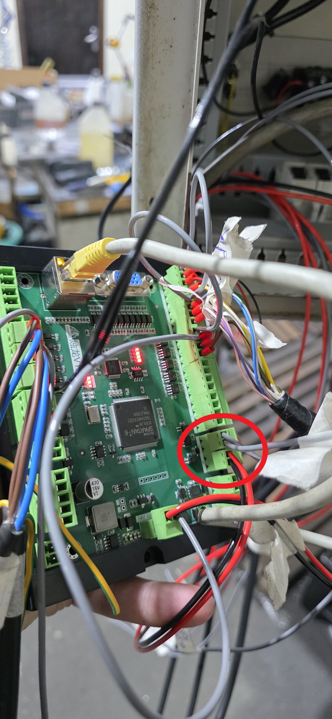

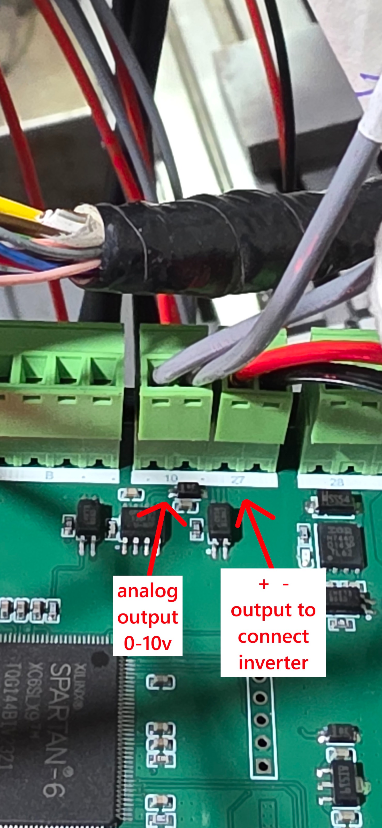

I have another question. I select the option to turn on the spindle. Output 27 is the option available, but it doesn't output 24V to turn on the relay and start the engine. The other available outputs (numbers 12, 13, 14, 29, 30, 31) always output 5V. Therefore, I wouldn't be able to connect a relay for the refrigeration pump and other control outputs. I've already changed the input and output functions, but the voltage remains the same.
