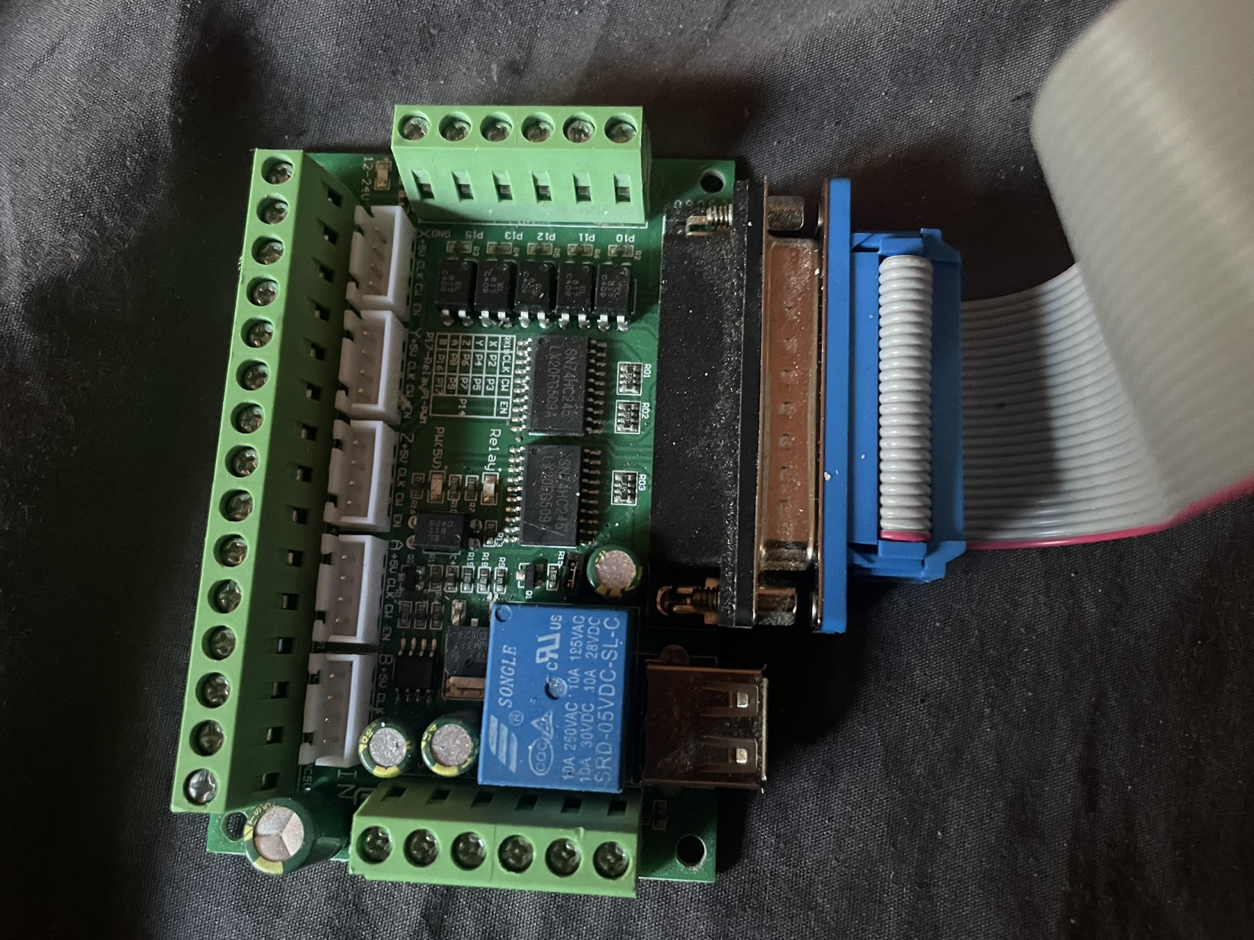

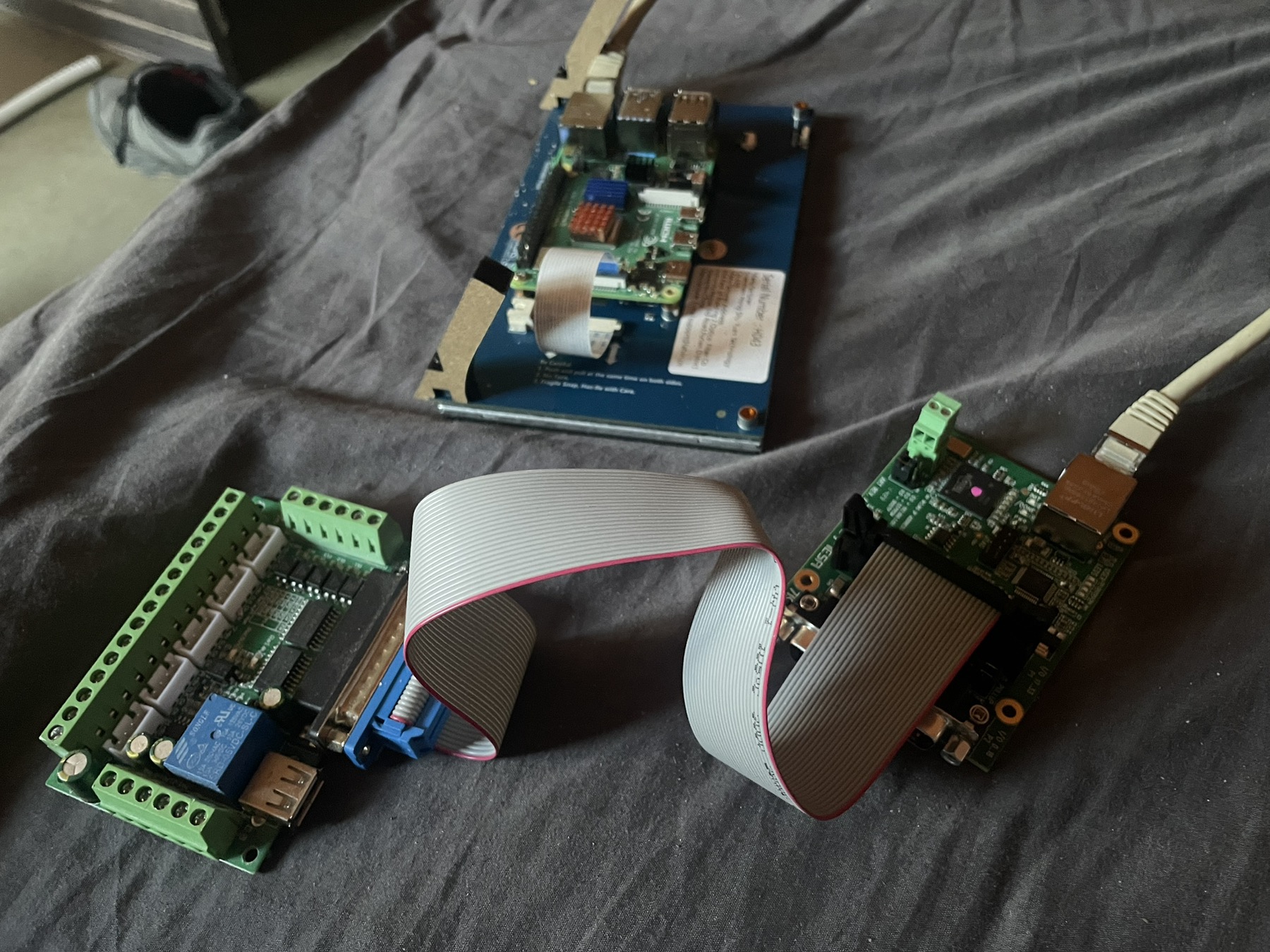

22 Jun 2026 17:31 #347232
by Masiwood123
Replied by Masiwood123 on topic 7i92tm + 2xbob

Replied by PCW on topic 7i92tm + 2xbob
Unless you can get a MPG with open collector outputs ( that match the SainsSmart BOB inputs ),
you are probably better off connecting the MPG directly to the 7I92.

22 Jun 2026 17:51 - 22 Jun 2026 17:55 #347235
by Masiwood123
In that case, if I do a mesaflash for two Bobs, will the configuration work using only one Bob as the base, for example the p1 port, and the other port directly from the card?How would you configure it for my case?
Last edit: 22 Jun 2026 17:55 by Masiwood123.

22 Jun 2026 18:25 #347238
For passive BOBs like the SainSmart ones, the configuration with or without BOB is Identical
