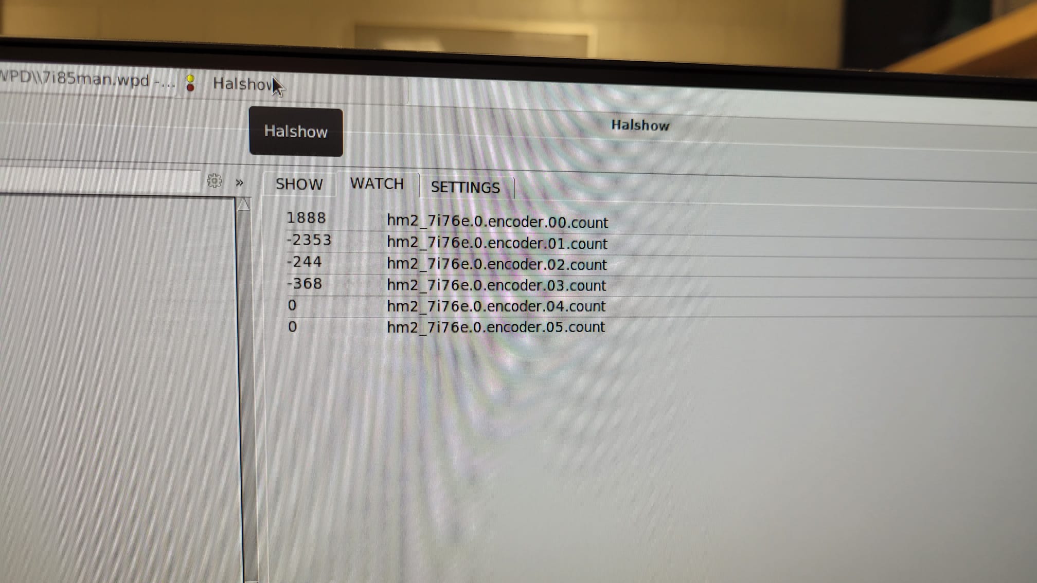

2) Yes I read this also somewhere else on the forum and made a new machine configuration in pncconf using this option. If I look in the hal file made afterward I indeed see a modified config string in loadrt hm2_eth: 'sserial_port_0=0000000x' and the number of encoders increased. However, unfortunately the other 7i84 and the 7i87 are stil not visible (these are connected via other SSerial channels on the 7i85 other than the one numbered 4 in the manual.
3) This evening I wired an encoder and checked it on all the 4 available enc positions (0, 1, 2, 3). I do see the steps increase/decrease in the watch window of halconfig. The signal pin names I look at are: hm2_7i76e.0.encoder.00.count up to hm2_7i76e.0.encoder.05.count. The enc. 0 (identifier from MESA manual image) corresponds to ....00.count and enc 4 to ....03.count. All seem to work nicely (cool to see this work!)
