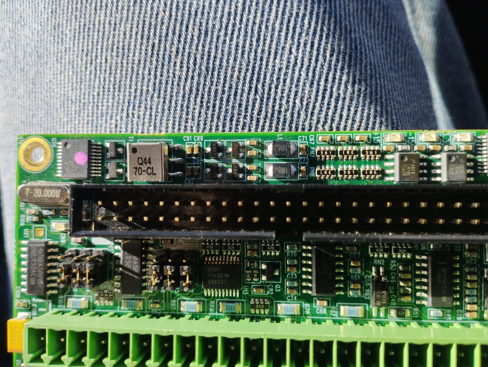

Hello, please can you help me with value of capacitor C91 of board mesa 7I48?. Thanks.

Is it shorted?
If not, that is not the issue/problem/reason.

0.1 uF 25V 0603
