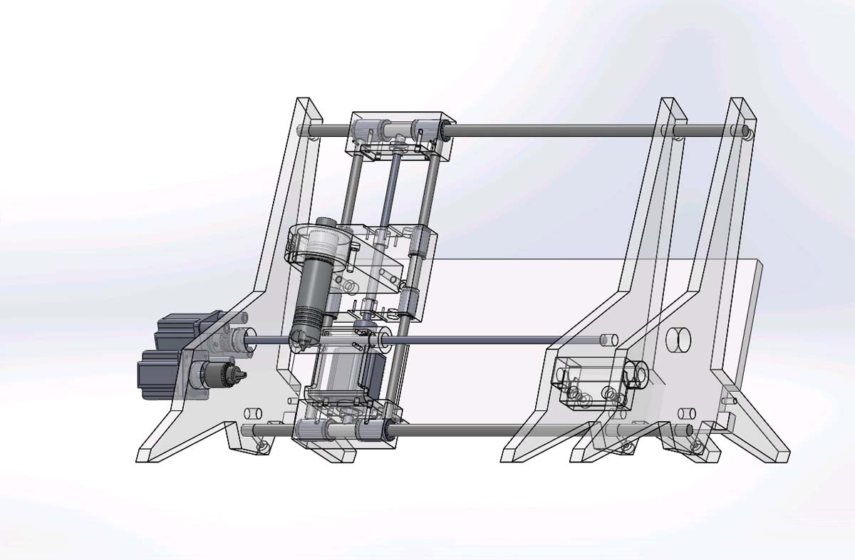

Recently I designed and built a little XZA Rotary axis rig to explore the challenges of rotary machining. Its made of acrylic and its work space is 300mm x 120mmdia. Theoretically accurate to 0.03mm.
The finished item is pretty close to this render and of course I use LinuxCNC with the Axis GUI to control it.
Everything works except for the graphic showing the tool path. The job runs properly and the resultant cut is correct in all respects.
Although the tool is touched off to the top of the job the graphic depicts the tool as being inside the cylindrical workspace cutting on the bottom of the job. Nothing I’ve tried will get the tool cone to display on the top outer surface. Any Ideas would be greatly appreciated.

19 Oct 2012 16:12 - 19 Oct 2012 16:13 #25443 by ArcEye
Replied by ArcEye on topic Re:Home Built Rotary Axis Machine
Hi
Have a look at this thread
www.linuxcnc.org/index.php/english/compo...729&limit=6&start=24
It produces a solution for using back tool / slant bed lathes through G10 L2 axis rotation. Your rig has many similarities with such a lathe.
The other option is to experiment with setting something like [DISPLAY] GEOMETRY= -XZA in the .ini file, but this tends to leave the dimensions bars and axis intersection markers orphaned in the plot display.

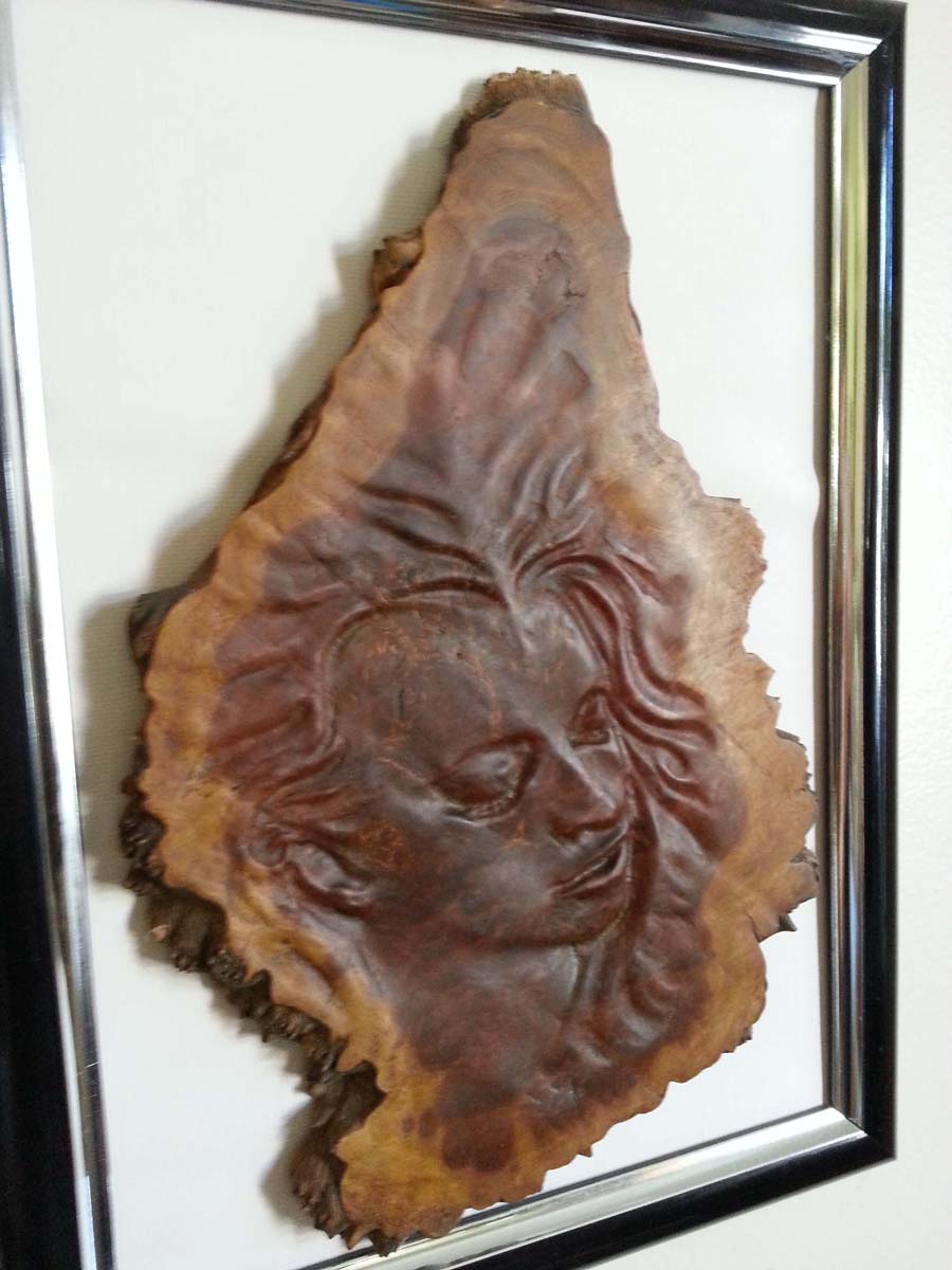

22 Oct 2012 01:56 #25577 by fbn5000
Replied by fbn5000 on topic Re:Home Built Rotary Axis Machine
Thanks for the links.
I don't have a web site yet but it looks like I'll have to set one up.
Here's a pic of a recent piece done in a Jarra burl. The frame is A4. [/img]
By the way I still haven't got the Axis display to work properly.
Regards
Frank
22 Oct 2012 11:55 #25593 by andypugh
Replied by andypugh on topic Re:Home Built Rotary Axis Machine
Nice. Very Huldra.

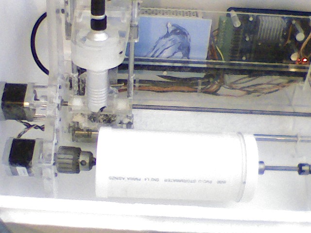

23 Oct 2012 20:25 #25703 by fbn5000
This is a pic of the machine setup for a 90mm Dia PVC Lithophane.
Yes that's a Chinese 3 axis controller. It works well.

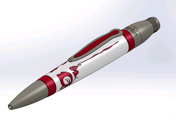

At the moment I'm trying to get Solidworks interfaced so I can machine directly not through STL's
This is not as easy as one would think as changing machine configurations and post processors
to accommodate my unconventional design is not straight forward. DeskProto was a piece of cake.
Here's a pic of the pen I want to make.
Regards

23 Oct 2012 20:28 - 23 Oct 2012 20:40 #25704 by fbn5000
Woops
Here's the Machine
Sorry about that. I need to read the instructions.
