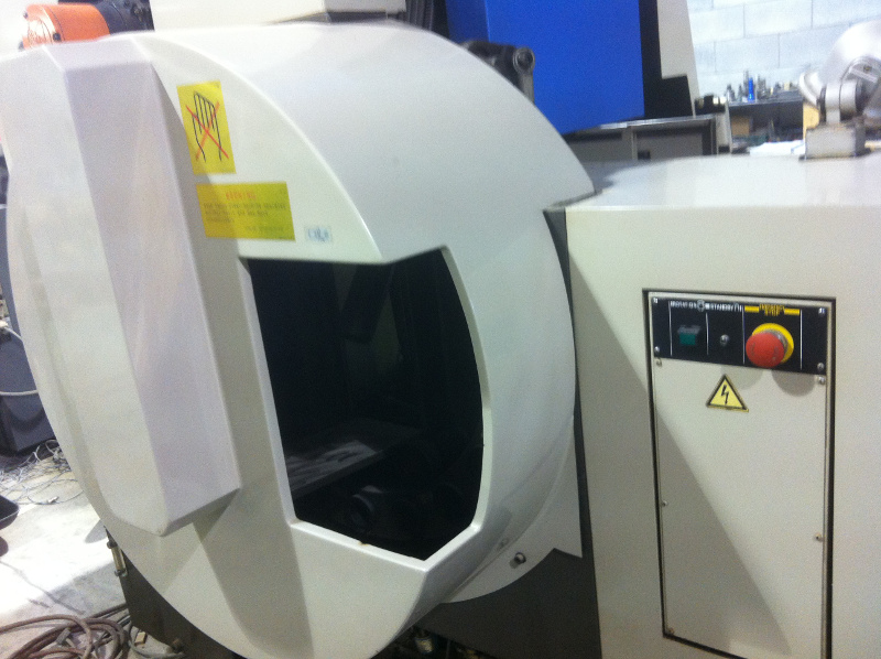

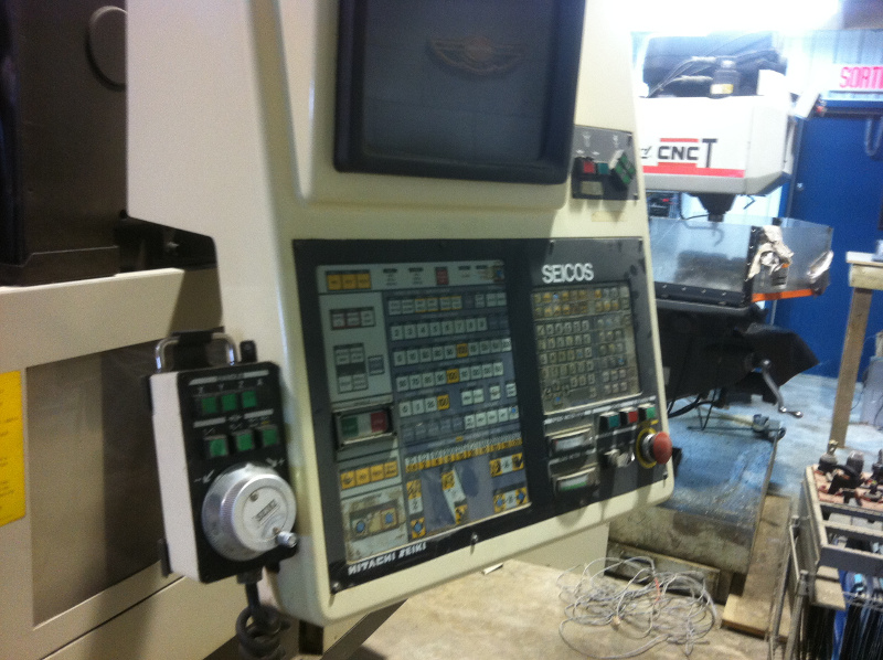

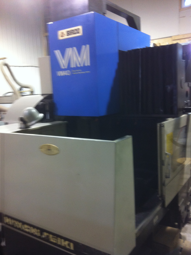

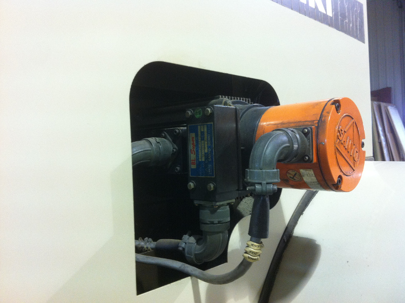

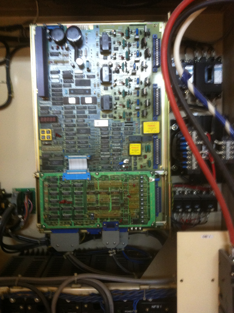

I am starting a retrofit on a Hitachi Seiki VM40. The original control is not working but everything else looks good.
Installed LinuxCNC and I am using a 5i25 and a 7i77 which is up and running. I am programming and learning as I go.
Here are some pics of the machine as it sits now.

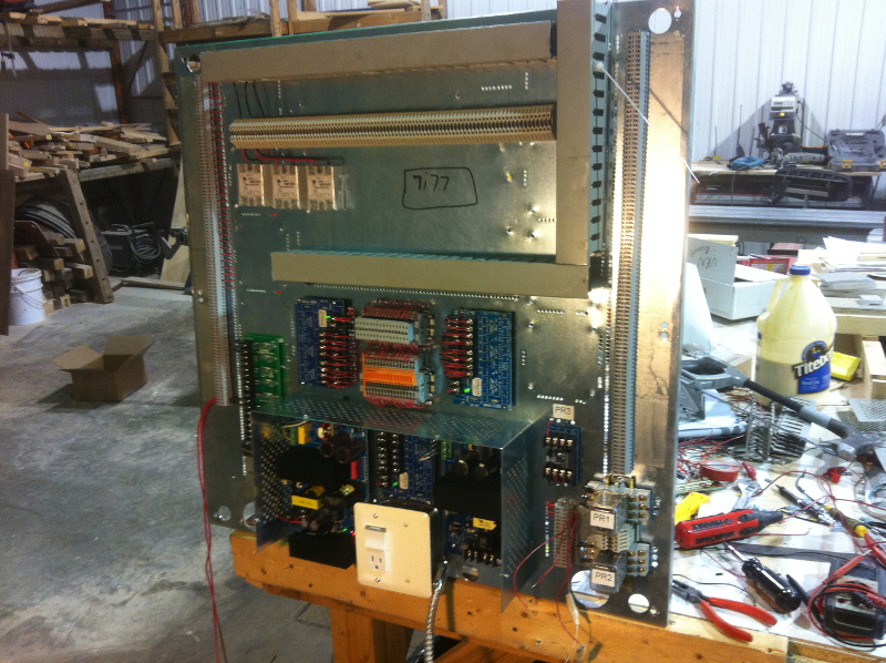

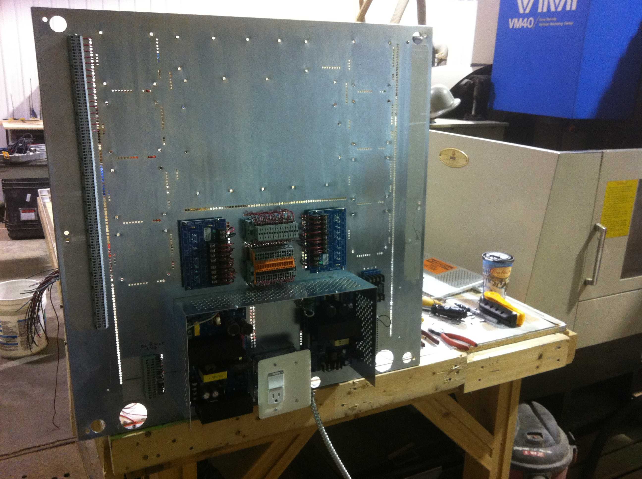

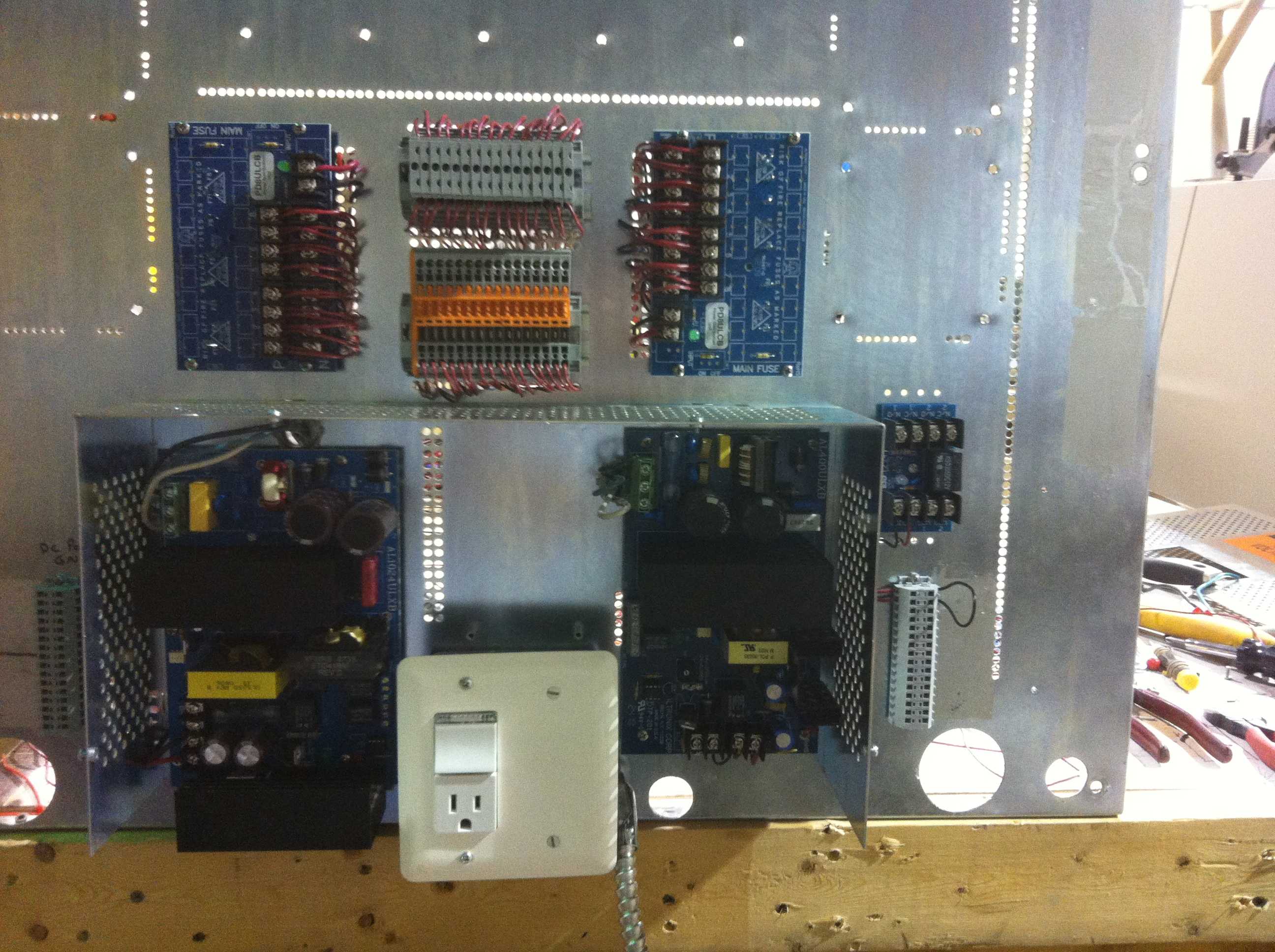

Started working on new control box to house the mesa cards and I/O and power.

With the ATC and P{LC, I am thinking I will run out of I/O on the 7i77. I will leave room to add an I/O board.
Last edit: 12 Jan 2014 21:54 by bevins.
13 Jan 2014 05:45 #42674
Have a look at the smart-serial boards.
Any one of these can be connected to the smart-serial port of your 7i77.
store.mesanet.com/index.php?route=product/category&path=83_88
There is a wide range of capabilities there. The 7i64 can handle significant voltage and current. (which is why it is so much more expensive)
Replied by andypugh on topic Hitachi Seiki VM-40 Retrofit

I don't think I would need the higher powered card. I will just be energizing relays. So the 7i84 will do fine I think.

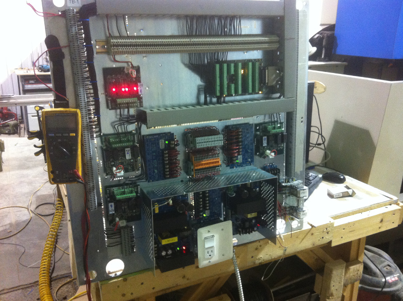

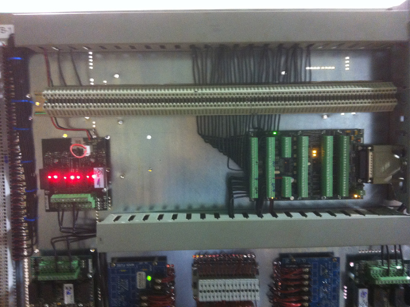

More work done on panel.

Very neat wiring! You don't see that often.
