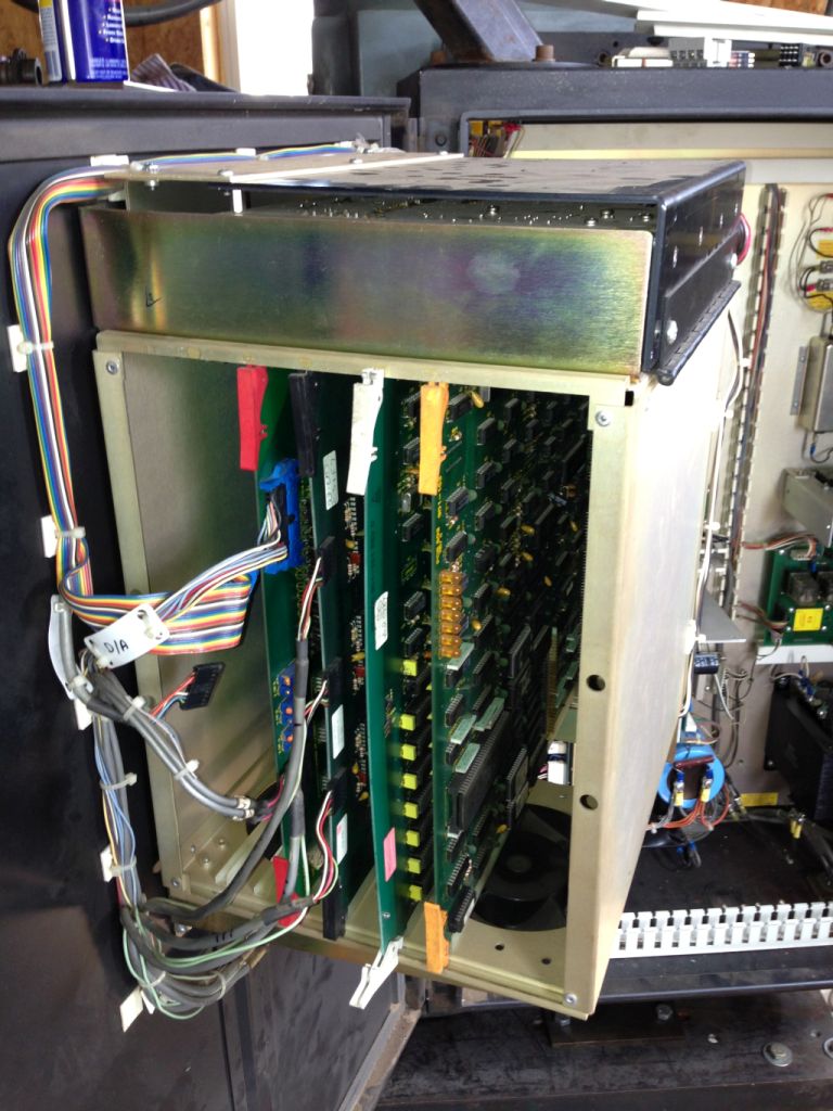

2. I would like to eliminate the current card cage with all of the circuit boards, as this is where the current problem is occurring that is preventing the controller from booting up.

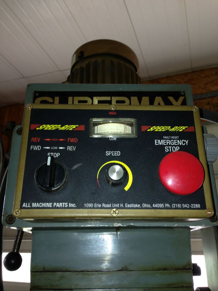

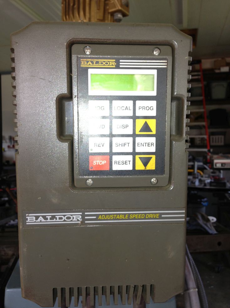

4. This machine has a Speed-Rite spindle motor conversion, which consists of a Baldor Super E motor, Baldor VFD, and a control panel that is mounted to the head of the machine. All of the original mechanical variable speed parts have been eliminated from the head and replaced with two v-belt pulleys that were part of the Speed-Rite kit. I would like my new controller to have the ability to control the spindle speed through this Speed-Rite VFD conversion.

I converted my Anilam 1100m Bridgeport using 5i25 7i77. I'd start by finding the drive cards for the axes and see if they take ± 10vdc velocity inputs. If you can add encoders it makes life easier for the conversion. Some others should pop in that know about the glass scales and how to use them. Also try and figure out how the VFD is being controlled now.
The cmfullview.jpg looks almost exactly like my drives on my Anilam 1100...
That should be easy, the VFD probably accepts an analog voltage for speed control.
