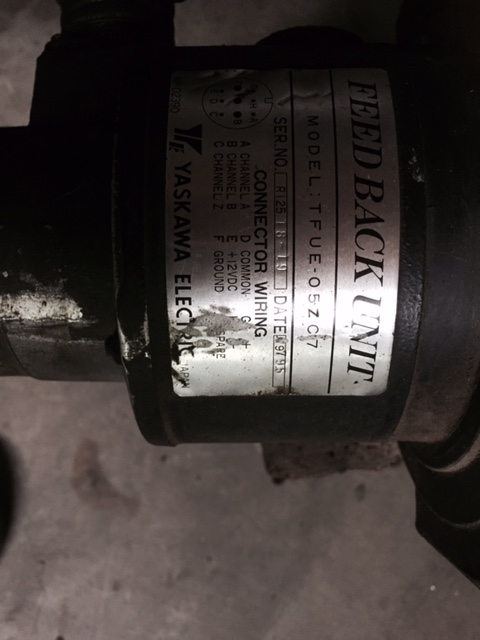

Can I just use a resistor inline to knock down the voltage? These are the axis encoders:

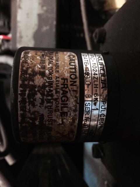

Now on the spindle encoder AND drive, I have no info or wiring diagram. Here's a pic of the encoder.

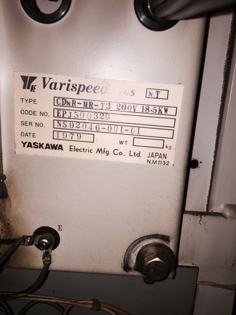

And here's a pic of the drive. I found some info on line for similar part numbers but the numbering scheme did not make sense with what I see on this drive. This is an old Miyano 7BC lathe I'm retro fitting.

Hooking up a couple 100 ohm resistors in series and doing some basic ohms law calc's I came up with a resistance of 1000 ohm for the encoder (ex. A+) leg. With 12V at the encoder, I measured 2v at the first resistor and 1v at the second resistor.
Doing some series ohm's law calculations I could use one 700 ohm resistor to get 5v or use two 1000 ohm resistors (roughly) in series and tap in between the 1000 ohm resistors. (12v/3 = 4vdc) ... maybe too low, but am I understanding the concept correctly? Is one configuration better than the other?
Thank you

What I think you need to do is build a voltage divider with a couple of resisters.
en.wikipedia.org/wiki/Voltage_divider

OK thanks. It just seemed too simple to make these encoders work with the mesa hardware
. Edit: This is true with regards to the X and Z encoders ... the spindle encoder I have no clue on right now nor do I the drive
cheers
There were schematics clearly labeled righ on the X and Z encoders but nothing on the spindle encoder... just p/n
cheers

sometimes it's worth just trying the encoders on 5v , iv'e found in 70% of cases they work without any problems
what details do you have on your spindle encoder ? picture etc

Ok thanks for the tip. Right now I've been able to get a lot of things working without re-wire. There's a separate isolated power supply that runs the encoders and some other things. I think it will be easier to just do a voltage divider for now if there's now downside. There's also a tach built into the encoders ... they probably need the 12v .... or am I just being lazy
I posted a pic of the spindle encoder above.
There's also a pic of the drive model number above. I found schematics for MT 500 drives but couldn't correlate it to this beast.

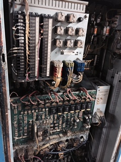

Here's a zoomed back pick of the drive. It's a mammoth. I've seen these drives for sale on ebay and the area on the top left looks to be a little different between models. It is referred to as the "sequence unit". I'm not sure if it's easier to tap into that or figure out how that unit is actually talking to the drive and tap directly into the drive.
Any input here greatly appreciated!

I'm losing counts on the DRO. Tomorrow I will hook up my scope and have a look at the A and B wave forms simultaneously. My resistors are creating a 4.8V wave. Is that potentially my problem? Should I get it right to 5V?
Any other things I should mess with.
The encoders are not differential. I had no wires hooked to the "negative" side of the encoder inputs (a/,b/) on the 7i77. Any chance I should be hooking my encoder pulses to a/ and b/ vs a and b?
It also seemed like hooking up the index pulse garbled the count more. I'll look at that also.
It's pretty cool that I'm getting data to the DRO.... even though it's wrong

If anyone has any info on my spindle drive and encoder that would be greatly appreciated! Pics of model numbers on first or second post of this thread.

When 7I77 encoders are in TTL mode, they have a TTL threshold (about 1.7V) so I would make sure the input swings as low as possible, less than .5V if possible. This is complicated by the fact that the inputs have 2K ohm pullups to 5V. This means you may need to lower your divider impedance to get good low level
