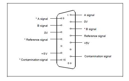

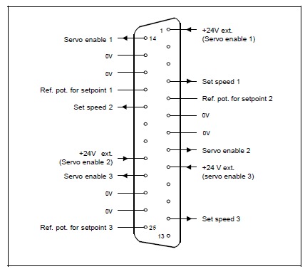

This is an old Swedish made machine, kind of a compact with a ISO40 spindle and some.. weird things.. =)
I include the encode cables going to the current control system. And something that is called "Setpoint output measuring circuit".
But basicly i think i could make an adapter cable that fits to the current cables and connect them to my Mesa 7i77 card.
Could this possibly be a tachometer channel?
It might just be a montoring feedback for the original controller: "I am asking for 5V of servo speed, but is there actually 5V at the servo drive terminal?)

29 Mar 2016 12:46 #72320 by NeoTech
Replied by NeoTech on topic Retrofit a Storebro Combi Mill CNC.
That M0 remap seems to be my best bet yes.. damn its hard to find stuff like that in the manual. =)
going in deep.
Ive figured out anyway that the encoder and setpoint connectors dont have the endstops or spindle control within them so they need to be broken out seperatly.. This retrofit will be planned beforehand.. i need the machine running.. but if i'm gonna get a 4th axis running i will need LinuxCNC. So it's only a question about time before when i must swap. =)
