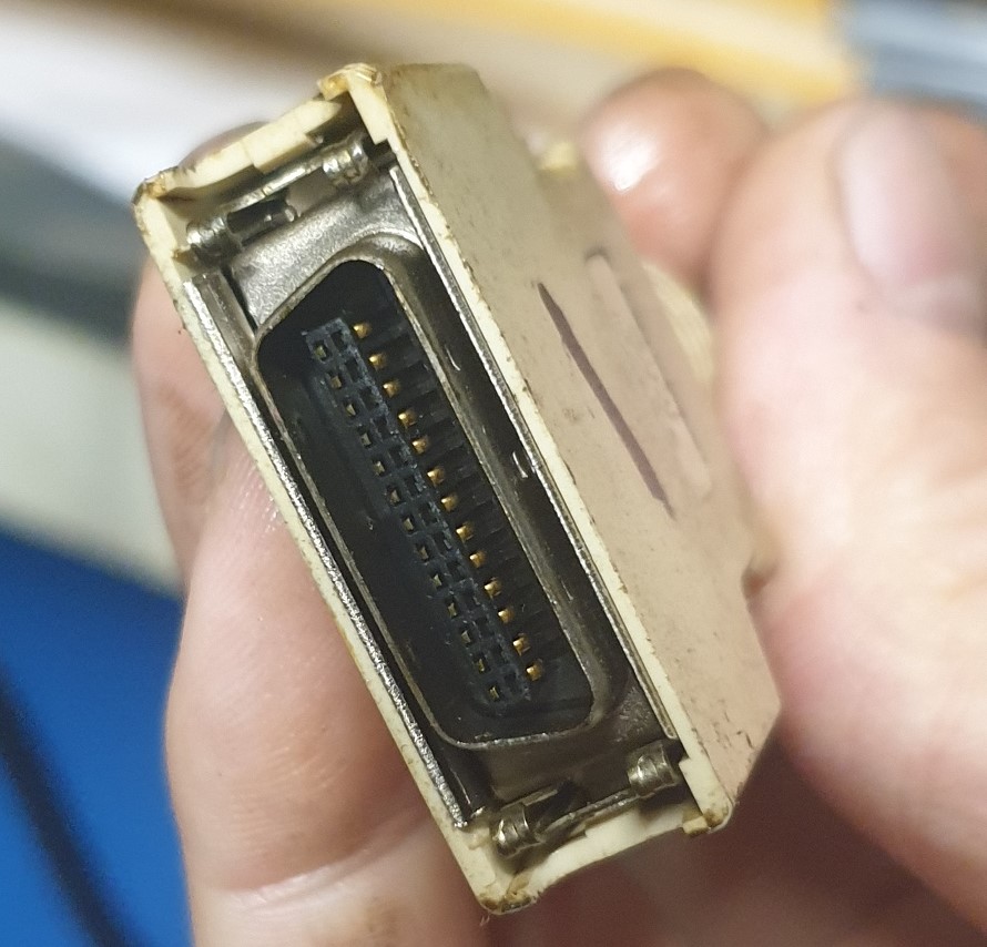

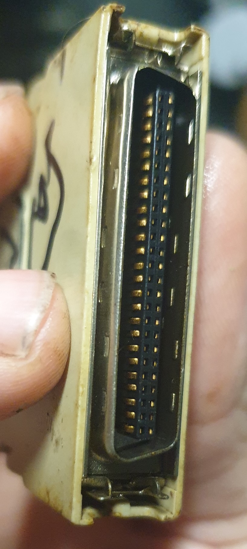

Until then, if it is of any help, here are pictures of the two connectors that currently connect the MELDASMAGIC64 to the BASE I/O unit and the Relay unit. Those are the two only connections that currently exist between the controller and the machine.
03 Jan 2021 19:29 - 03 Jan 2021 19:51 #193976 by dm17ry
mitsubishi spindles. it can be either speed or position controlled. to establish an absolute position the controller first issues an "orient" command, the drive will spin the motor a few turns and locks the spindle. then you can switch the spindle to the position control mode and that oriented position will become an origin point. not sure how precise it is because orientation and use either a magnetic sensor or spindle encoder... in position control mode the commanded resolution is 23,040,000 cpr regardless of what kind of encoder is used. when the spindle is used as a C-axis they usually use a really high resolution encoder. also, the controller explicitly signals the spindle drive that it is currently in C-axis mode. i believe to set PID gains which match other axes to achieve better synchronicity.
yeah, the common practice to use generic 24V I/O modules is kinda wasteful price-wise. with all those input optocouplers and protected driver ICs. i wanted to come up with something more optimal, but it hasn't happen so far. :) i did a control panel controller a while ago using a $2 STM32 controller, a piece of breadboard and bunch of wires. ADC for a rotary witch and joystick, hw quadrature decoder for MPG, WS2812B serial LEDs for indicator lights. buttons arranged in like 8X6 matrix... i can share the code and configs, but the are not documented apart from some comments in the code...
i can also share my YIO modules firmware which use STM32F030 MCUs. it's a really simple serial protocol on RS-485 half-duplex bus @5Mbps. if you're willing to make your own interface hardware - it is surely doable, no problem

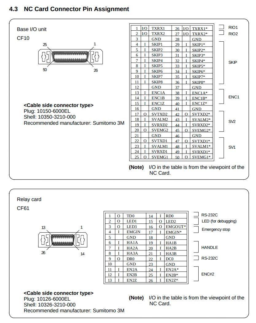

those MM64 connectors are documented in the manual. i believe 64ins/64outs on the base I/O card should be present on the RIO1 bus.

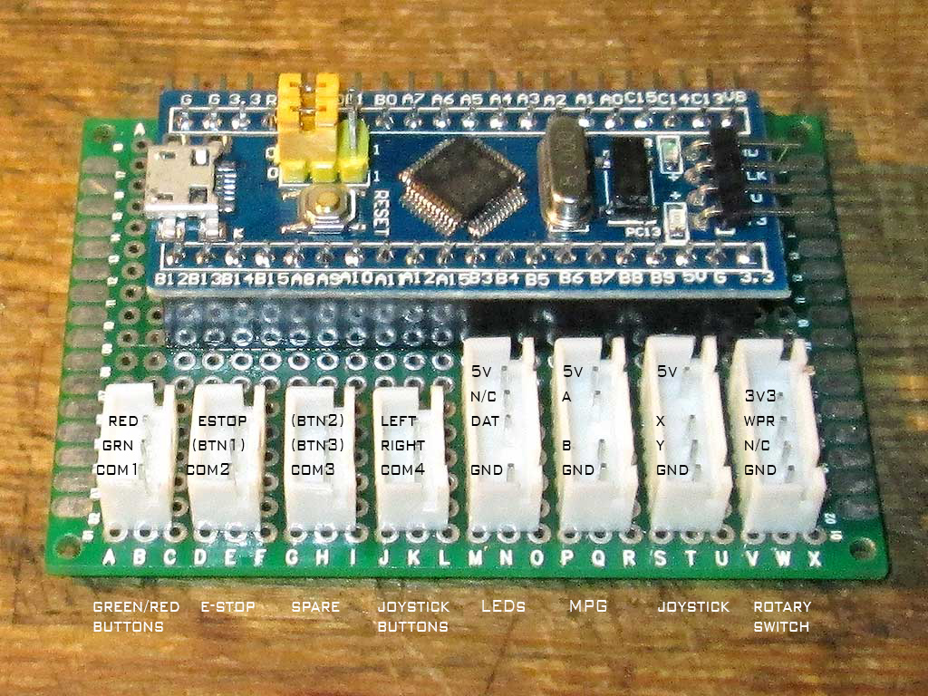

i did a control panel controller a while ago using a $2 STM32 controller [...] i can share the code and configs, but they are not documented apart from some comments in the code...
I wasn't sure if this was something that is possible. If this is feasible at my current skilllevel, I will probably end up doing this at some point for sure. If I understand correctly, it has the big advantage of being infinitely flexible if I ever want to add any functionality/buttons to my panel/machine.
What I really need to know is how the communication between the MCU and linuxcnc is done, and how you set up linuxcnc to have individual responses to certain events from the MCU. From a brief search in the wiki it seems that this can be done via HIDcomp and/or halui if I figure out how to get an MCU to act as an USB device. (there should be plenty of tutorials available online to do just that)
Is this what you have done here?
If so please do post your code and config, it will certainly help to have a working example that works on a recent-ish version of linuxcnc.
If not, could you still post the code, and I will have a look at it and see if I can figure out what you have done.
Have a look at page 14 of the electronics manual I uploaded. II'm not sure how cf31-34 are supposed to be adressed trough that cf10 connection, but if I see this correclty, we could ignore most of the pins, as they are already being handled trough the sh21 port on your card.

Is this what you have done here? If so please do post your code and config, it will certainly help to have a working example that works on a recent-ish version of linuxcnc.
kinda. the MCU presents itself as a composite USB HID device. it emulates a normal PC keyboard, a wheel mouse (with joystick and MPG) and a few more buttons. linuxcnc gets them using the hidcomp. i wanted to have an ability to use the alphanumeric membrane keyboard anywhere including BIOS SETUP. is the goal is only a few buttons - i think it will be easier to implement a custom HID device and a userspace linuxcnc component which will poll it for keypresses...
i will publish the code to the github in a few days after a bit of cleanup

if you want more I/O points than available on the card you'll need some way to bring them to the PC. the parallel port is kinda limited. adding another PCI/ethernet card may bring some compatibility issues. there's a serial YIO protocol already present in the firmware which supports up to 256 I/O points at 0.88ms poll cycle. so yes, i think you can use a $2 MCU to talk to the card and any I/O interfaces you like. with shift registers as you suggested, or whatever...
not really. my card only implements the "SV1" part of the CF10 connector
However, I suggest we only do this if you actually WANT to do that. I am aware that I am basically a stranger who came onto this forum asking for free help with a problem. I don't want anyone doing work which he doesn't want to do, just because that was the more convenient solution for me.
i'd like to implement it, because i think it will save a lot of rewiring and keep the possibility to instantly fall back to the original control for whatever reason... but need to evaluate how much time it will take. recently i've got a retrofit candidate with similar base I/O and RIO. will do some tests in week or two and decide if it's feasible.
Okay thank you very much for that
Okay that sounds indeed like something that I should try once the card arrives. Am I correct in assuming that any board which can be programmed in C and is capable of half-duplex RS-485 should work with your firmware with perhaps a few minor mods, or should I stick to stm32 architecture? I'm asking because I have a whole bunch of esp32 and STM32F103C8T6 boards lying around.
yeah but sv2 isn't hooked up, the encoders are reached trough to linuxcnc by your board directly from the drives if I understand correctly, RIO2 isn't hooked up, and the way I see it, RIO1 is reached trough directly to the RIO Board.
That is of course true- I also wanted to try and work around irreversible changes as much as possible. Hence why I liked the idea of the HID controller so much- simply building a new console that I can put in front of the old one. Arguably not very elegant, but at least reversible should I ever have the need to do so.
