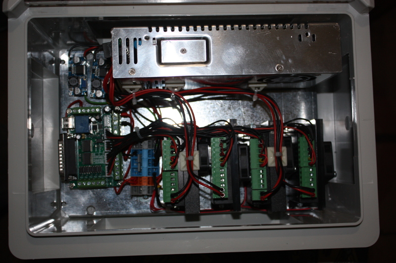

11 May 2020 06:49 #167332
by bbsr_5a
Replied by bbsr_5a on topic Replacing electronics and Firmware
yes it will be working fine
it is the standard machine setup
and the DM556 are slightly over for this
you can go for cheeper 542T Clones if you want to safe money
the PC will also work
PLEASE Download the LINUXCNC MINT DVD/USB and try it out from the DVD/USB what latency the PC got
everithing below 50000 Nanoseceds will boost your setup
- Kosmas
- Posts: 9
11 May 2020 09:09 #167352
by Kosmas
Replied by Kosmas on topic Replacing electronics and Firmware
Thank you bbsr_5a
"yes it will be working fine"
Thank you
"DM556 are slightly over for this"
I will replace my 4 motors soon and lead screws too.
Now is 6V-2A-62oz.in motors ->with 4.8V-3A-396oz.in
And at the link in my first post, DM556 costs only 18Euros/piece-3 days delivery.
"the PC will also work"
Its only latency that matters or i have to choose between 32bit / 64bit?
5V parallel port for PCIe is mandatory, yes?
Nice photo
I thing this is the controller i want to use.
What is this (2 pieces of electronics) on the left of the power supply, above your controller?
And a final question quite difficult.
My ex (USB) controller had a good responce in cutting speeds 20IPM on soft materials.
Is it yours (this green breakout board) able to do this?
Thank you
Thank you
Nice photo
Thank you
