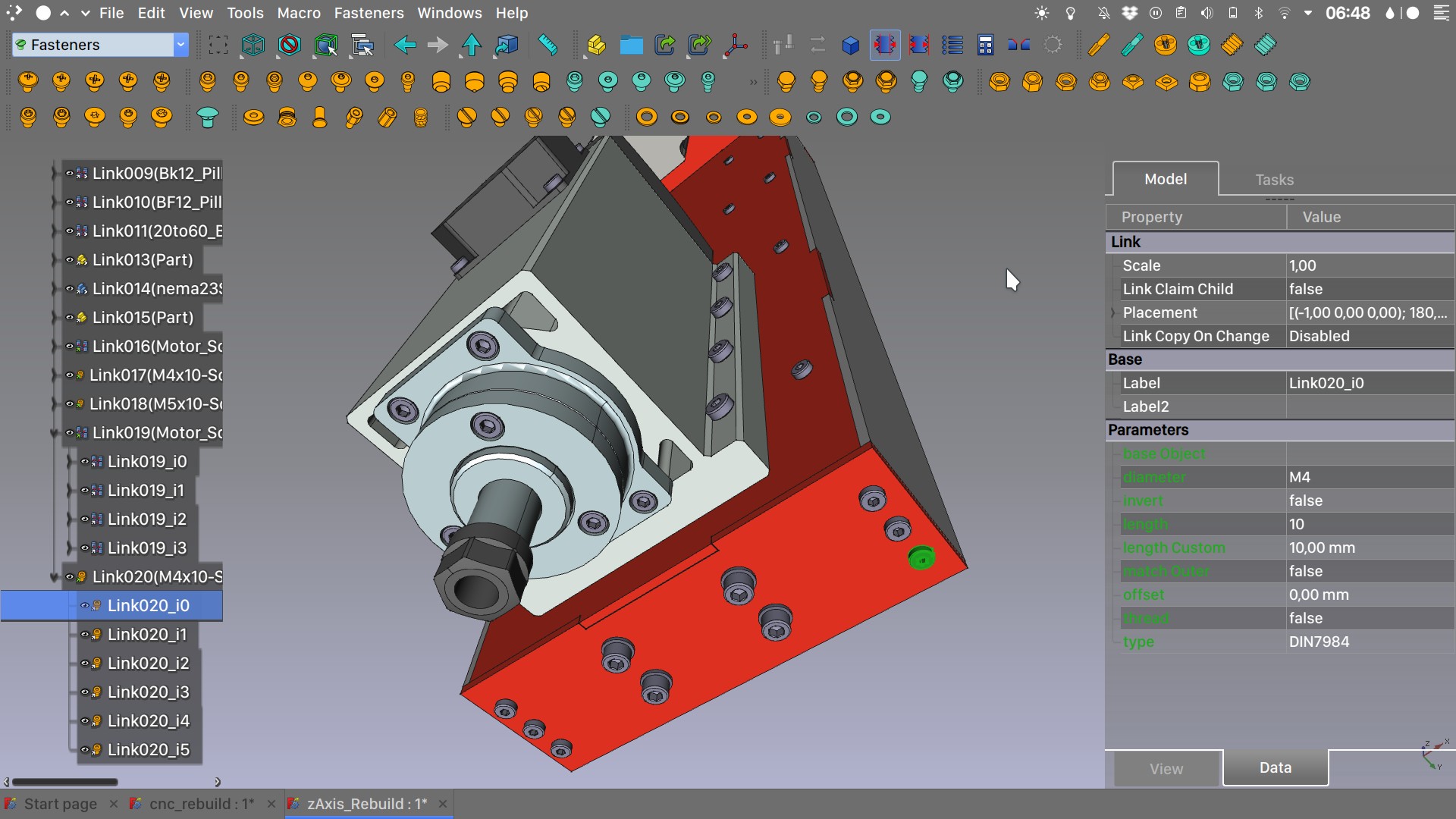

My day work and the general situation have kept me away from this project for quite some time now but I have finally made some progress.
Here is a quick test of the Z axis in motion.
I also made a tut of the modelling process in FreeCAD hoping it might help someone.

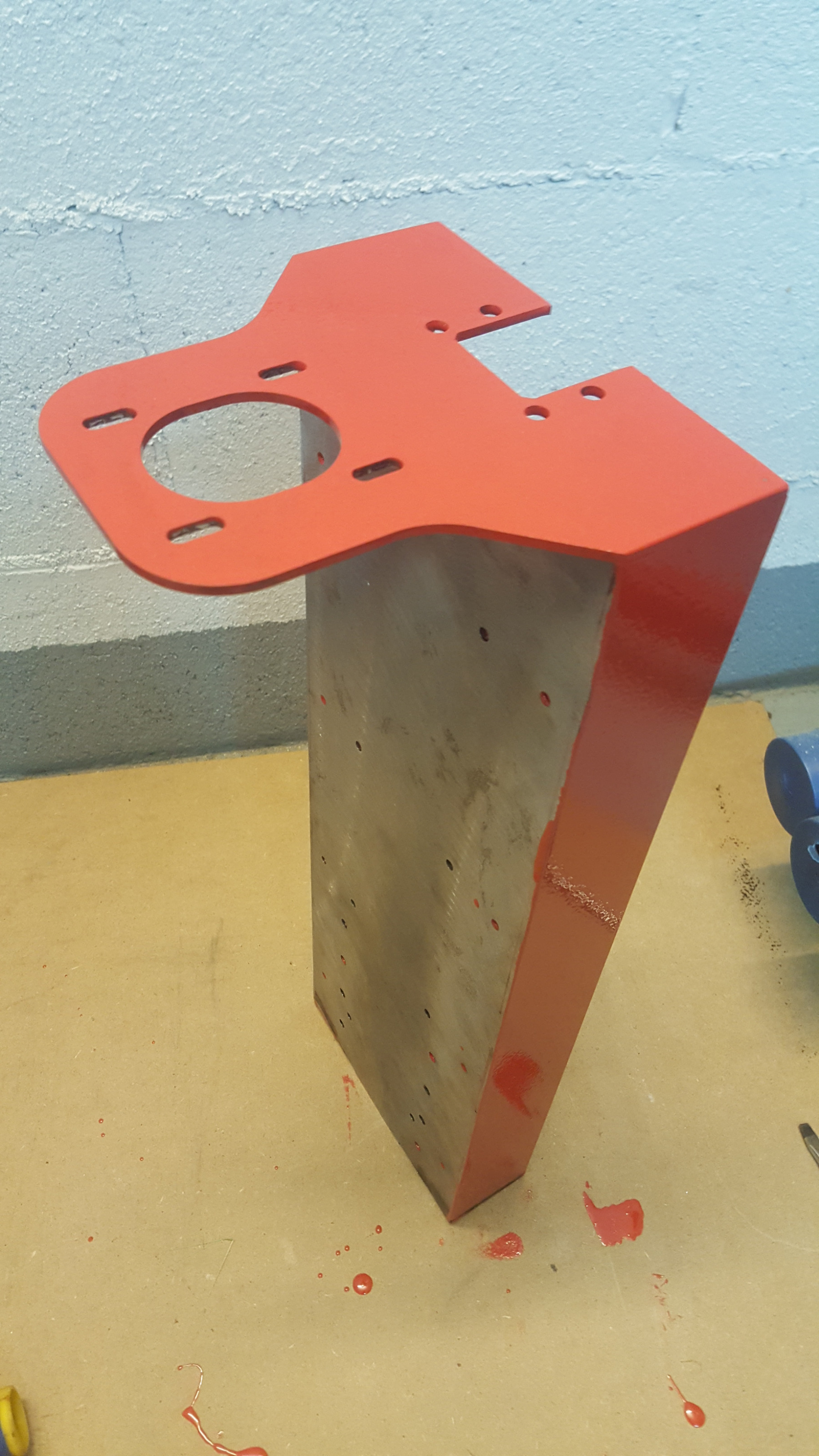

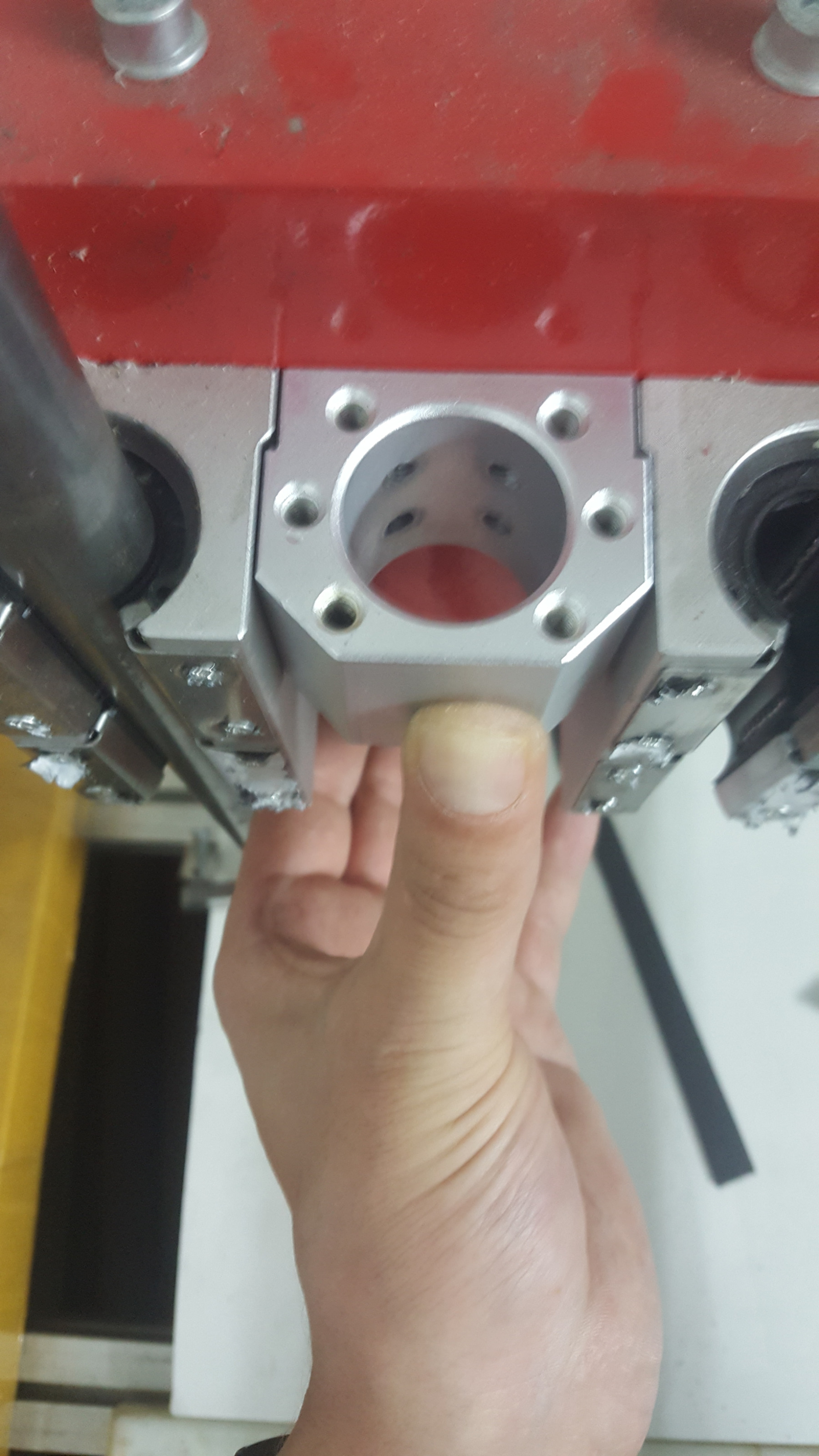

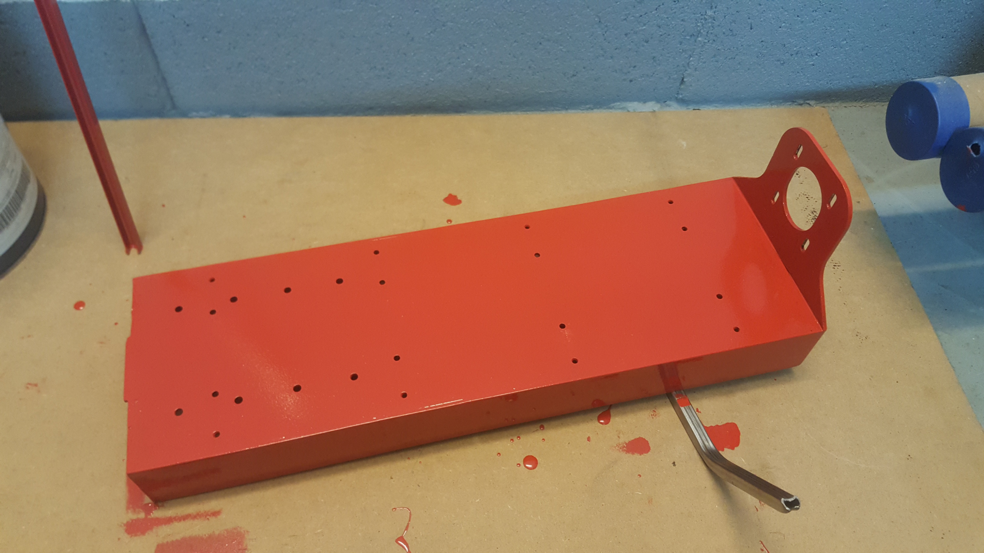

Not much to be shown but here it is.
I had to machine the ball nut holder in order for it to fit between the Z axis linear bearings. Now I will need to drill the corresponding holes on the plate.
I made, welded and drilled/tapped the support lip for the bottom of the Z axis. This has 6 screws that will keep it in place
And finally the first coat of paint

Question about freecad.... how do you get it to look for Fusion 360 ish?
Where all the components or assembly items are on the LHS and overlaid over the model and not in a seperate menu box?
- oficinerobotica
- Posts: 47
- Thank you received: 12
05 May 2022 09:35 - 05 May 2022 09:36 #242026
by oficinerobotica
Replied by oficinerobotica on topic DIY high soulder CNC with cad model.
@robertspark
To get the same result is a bit of a rabbit hole but highly worth it imo.
First you need FreeCAD LinkStage3 dev branch from here github.com/realthunder/FreeCAD_assembly3/releases
This FC branch has a substantial amount of improvements from the interface to the modelling tools but the highlight would be a improved TopoNaming algorithm (Freecad's Achilles heel)
Follow this guide after you installed FreeCAD LinkStage3
Hope this helps
Hope this helps
