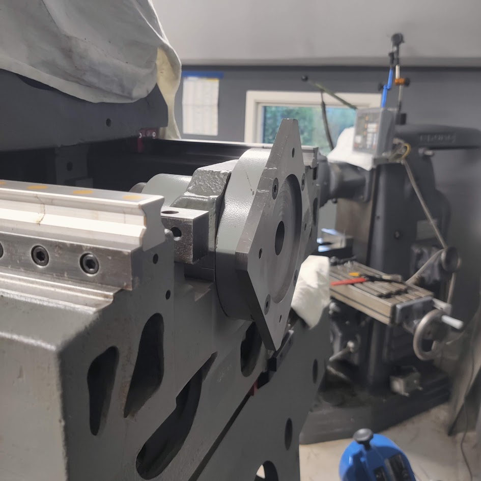

I have lots of pictures, but i don't understand what length you are talking about. Do you mean from the flange face to the ballscrew? I made adapters to fit new servos.
Warning: Spoiler!

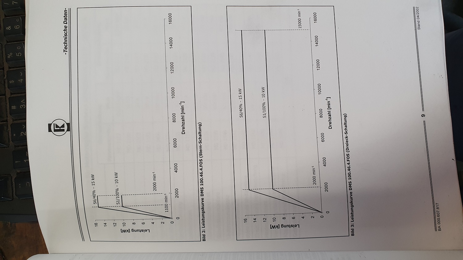

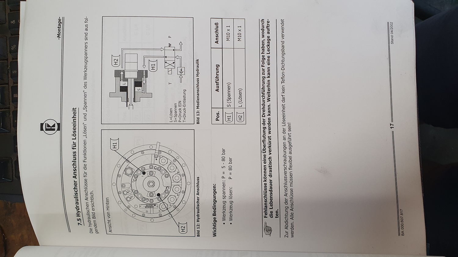

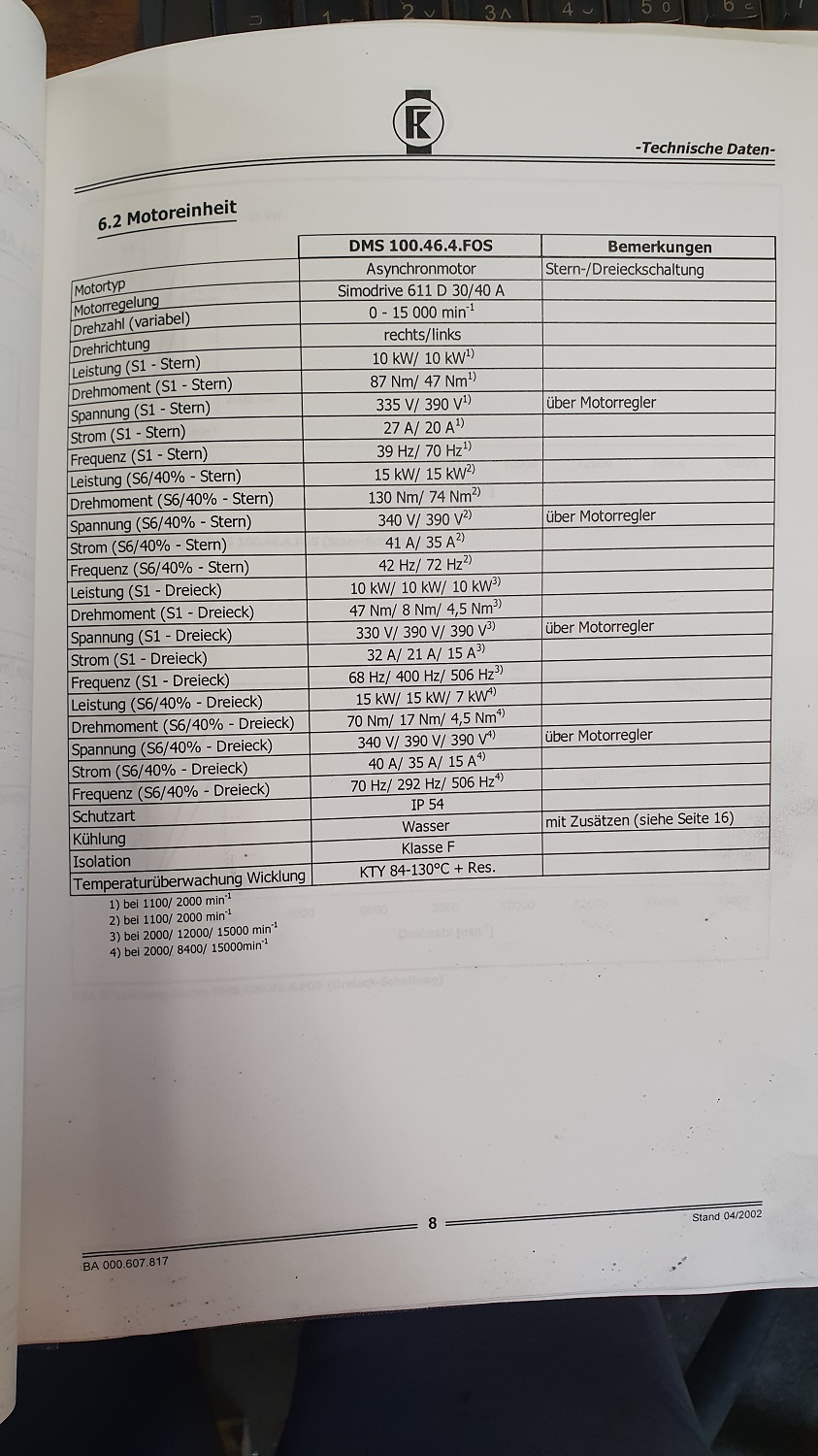

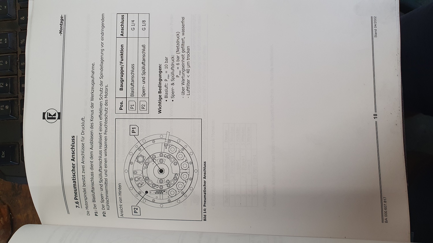

03 Sep 2025 13:31 #334366 by trisa25
Replied by trisa25 on topic DMG DMU 50 Retroftiing(?) help

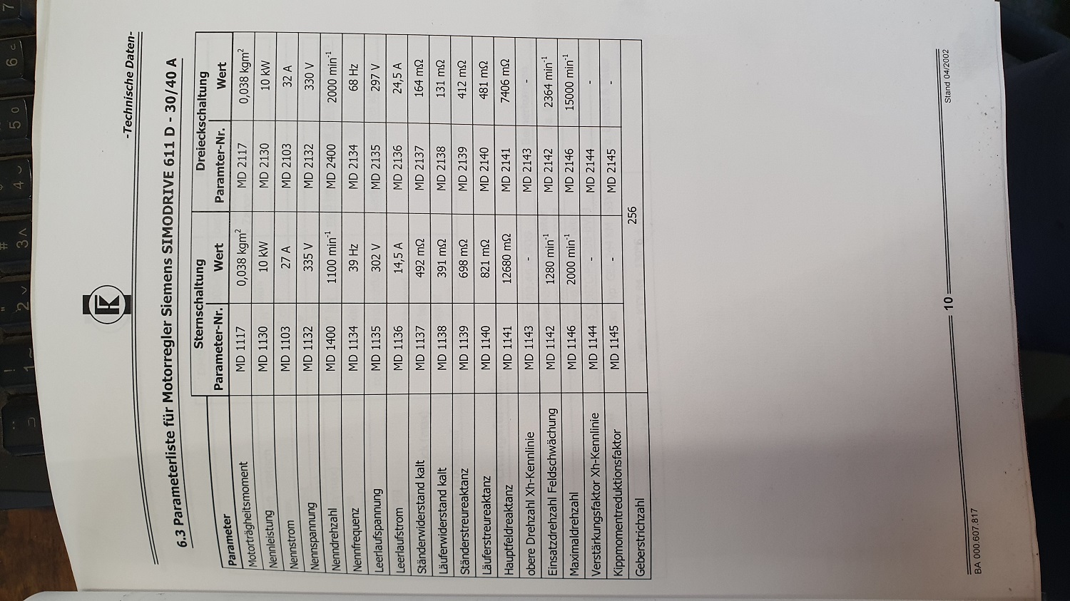

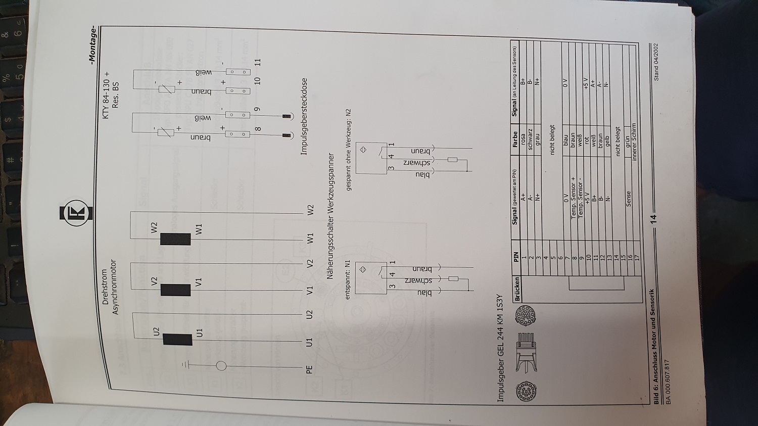

I have a simmilar 15k rpm Kessler spindle on a DMC 100 V.
I have attached the datasheet pictures.

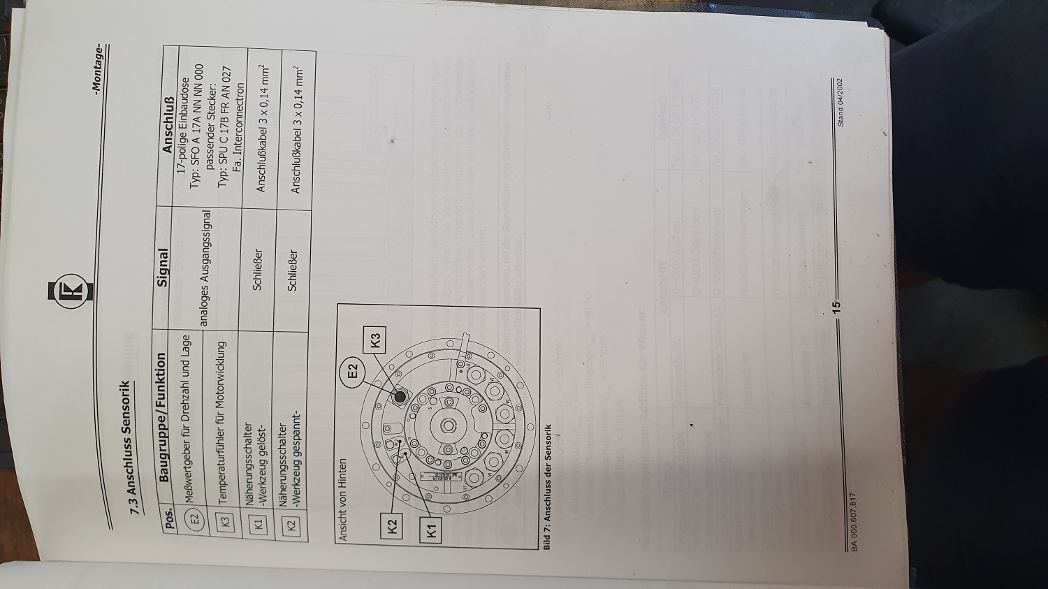

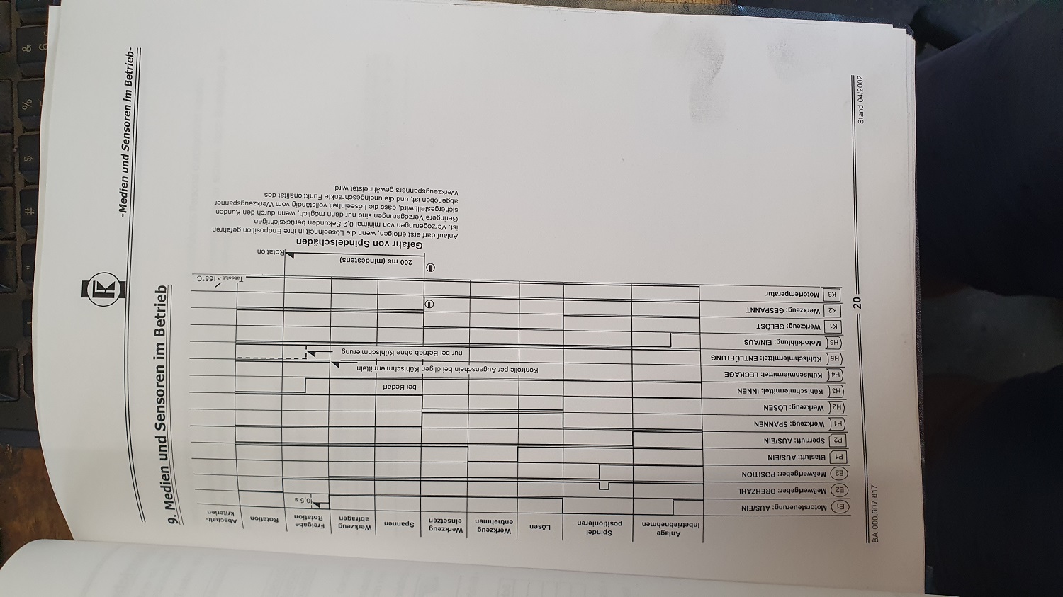

03 Sep 2025 13:35 #334367 by trisa25
More pictures.
