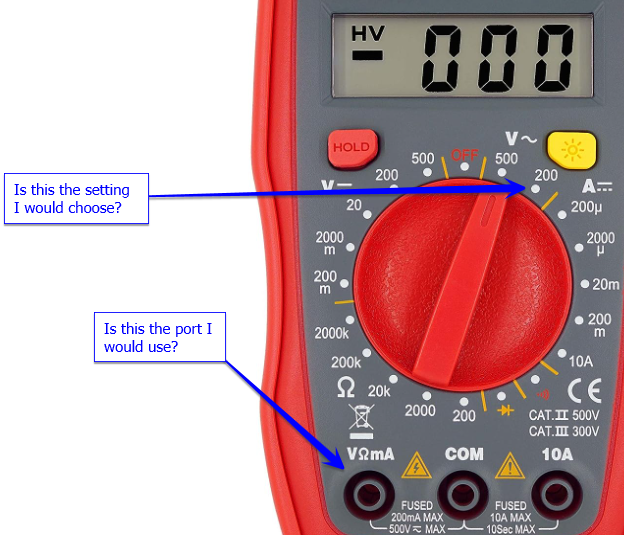

28 Aug 2023 12:53 #279165 by tommylight
Spindle on, makes electrical noise, messes with signals.
Check grounding and shielding first.
Then check power supplies for noise/ripple.
I had a bad batch of power supplies, had to change all 3, they would cause so much noise the machine would shake and rattle sometimes, not always, just some times.
If you do not have an oscilloscope to check ripple, use a DVM set for AC voltage, anything above 0.2V = new power supply. Also, beware that some cheap DVM are not good for this.

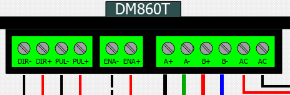

28 Aug 2023 20:57 #279212 by tommylight
Yes, and yes on the picture.
What exactly do I check? The output power of the PS's? At the PS or the input at the drivers?
Both, if the power supply is ok but at the stepper there is above 0.2V, means the noise is not from the supply but from the cabling.
Also measure between neutral and ground, should be under 2-3V AC. Probably even a bit more is OK, but that depends on other equipment in the shop/house/office.

29 Aug 2023 04:09 #279250 by Sray69
Thanks. That is helpful.
Where exactly should I be measuring this? And using the same settings on the DVM?
check the power supply when the machine is running, if the LED blinks = not enough current for the drives motors, so a bigger power supply or lower the motor current on motors that can handle it.
I assume the blinking LEDs would be on the drivers? Or on the PS? If the power supply is good then it should have enough power. I feel like I made sure of that when I purchased it. I am not sure what the motor current is set at currently. I thought I set it on the lower end when I set them up just to be safe. I will check that in the morning.
Thanks for your assistance!
