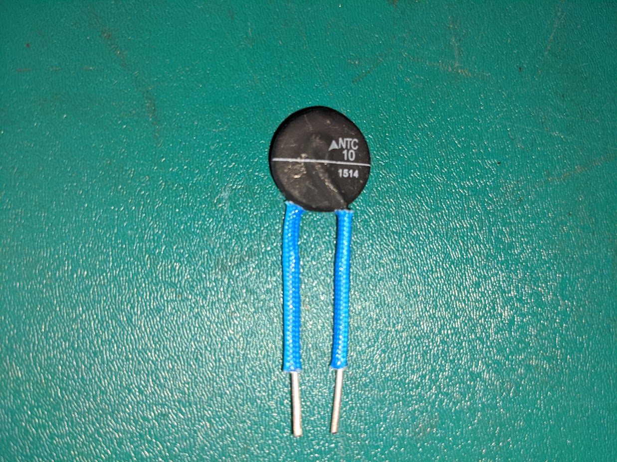

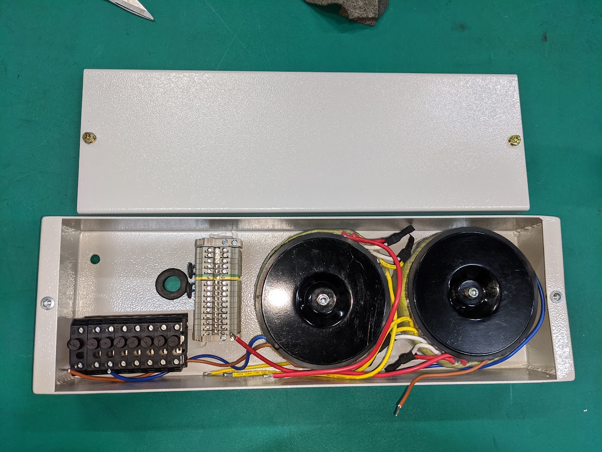

I would not be too worried about the slow blow fuse. I have done three Toroid setups now for steppers. The first one, I used 2 x 32V toroids in series (cos thats what I could get) to give 64 Volts @ 20 amps. I was a bit worried about inrush and when I queried that, the manufacturer gve me a couple of Thermistors to limit the inrush.
But the recommendation from the Stepper drive manufacturer was to add fuses on the power to the motor (hence all the terminals)
Next time round, I got 2 x 60 volt x 12.5 V toroids made and did not worry about the thermistors.

I did finially find a reference for a different brand of toroid that oddly enough has the exact same specs as this one and they actually listed
For 115V use: primary: 6.3A, 5x20mm, IEC127, high I²t value
in series with 2 NTC-resistors type NTC2.5
secondary: none
So.... both a slow blow fuse close to what I figured AND a NTC, belt and suspenders I guess. On order now

Completed and installed the new power supply. Ended up using a combination of what rodw suggested and some other info I eventually found online.
One main Fuse from the 120v line on the hot side (it also splits off into a 120v > 3.3v/5v/12v power supply for the other various circuits before hitting the toroid)
A thermister and a slo-blow fuse on each of the input coils which are in series to each other.
One fuse on each pair of the output to the stepper coils
Seems like overkill somehow but that's what's there.
