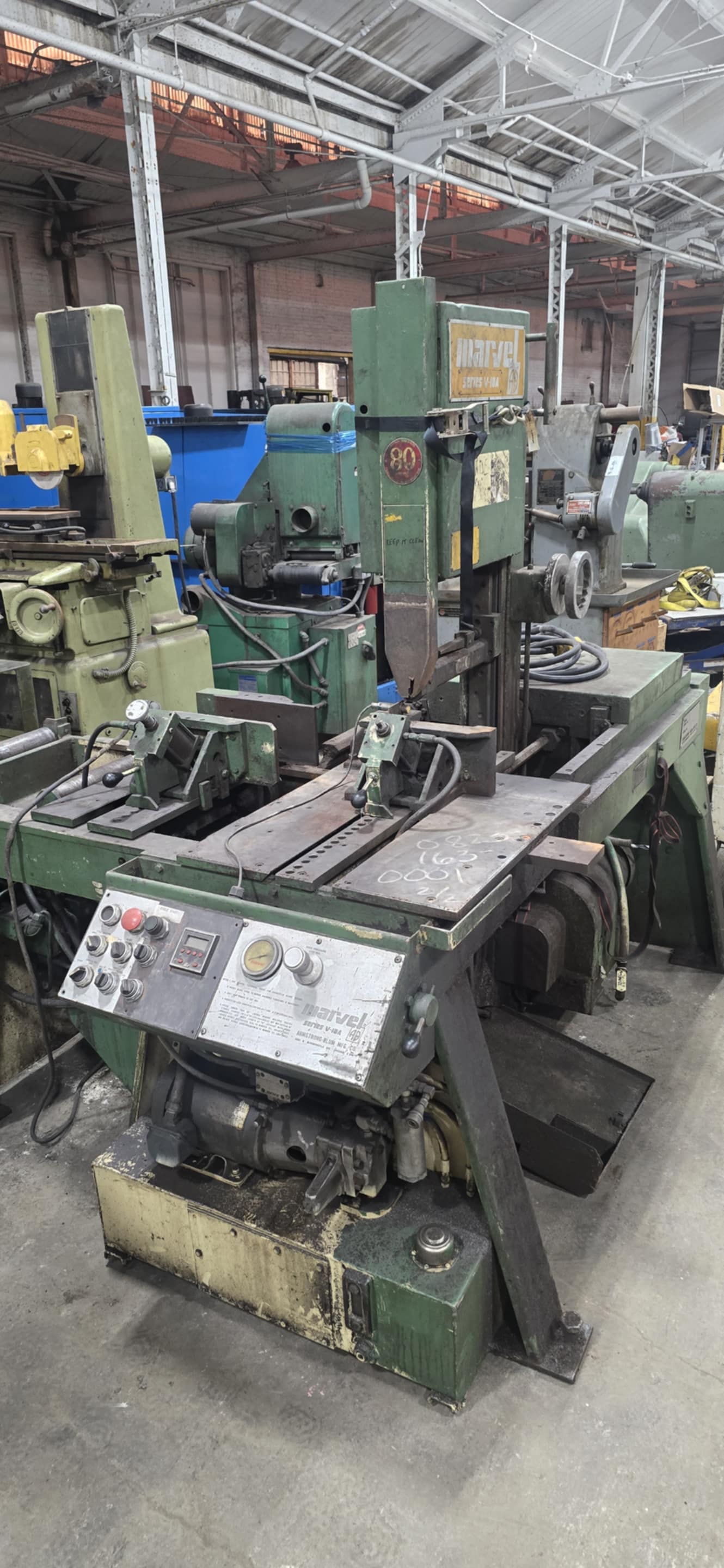

I recently had a marvel v10a automatic band saw fall into my lap. It's in pretty rough shape and I am considering doing a restoration on it. I was told the electronics are in potentially broken condition. I think it would be a neat project to retrofit the control, and would be useful to be able to upload cut lists to the machine via USB to further automate the cutting process and have a hmi. The machine does not currently auto miter and only allows 1 direction mitering. I think I can modify it to miter both directions, but need to further investigate if i can I will try to add auto miter. This thread will serve as a build log if I make progress on the project. Has anyone seen any examples of retrofits being done on band saws? What would be the best way to go about taking on this project.

Got the saw back home. She's definitely rough. Good news is it looks possible to make the saw miter in the opposite direction by removing one support bar. The way the shuttle seems to work is it has a ball screw with a limit switch on it to control the length that the hydraulic retracts. Once it hits the limit switch it stops the hydraulic from further feeding forward. I may rework the vices as they currently have a very shallow depth of hydraulic travel. The bearings in the saw wheels feel sloppy but smooth. In the morning I am pressure washing the whole machine and may try to put power to it to see if anything still works. If I can reuse hydraulic pump and band saw motor that would be awesome!

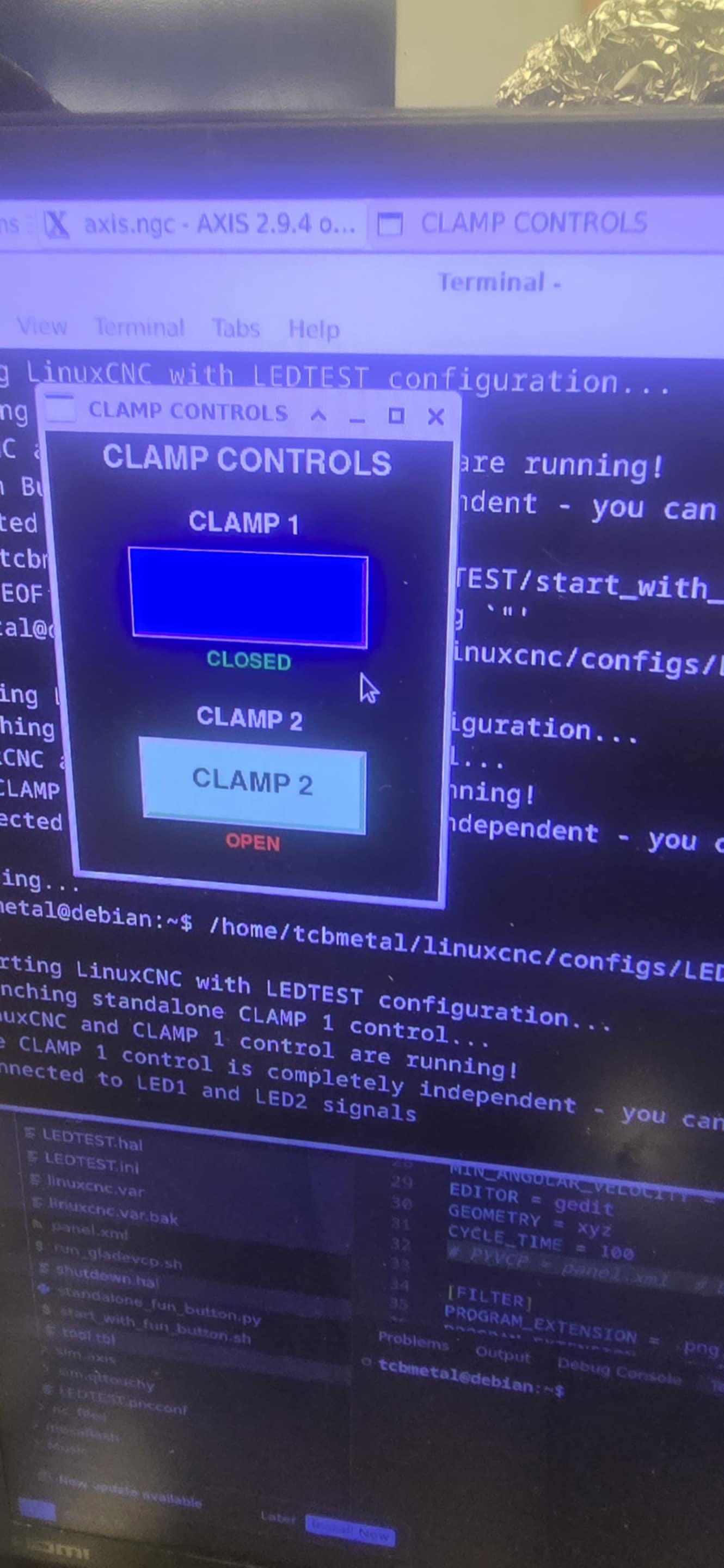

I was able to make a basic gui to turn on and off 2 leds using cursor. Pretty cool tbh. It took 2 days of pain in the ass vibe coding to get it done but now that I'm here everything should be smooth sailing. This is really a new method to make gui that is not talked about much. In my opinion it's much easier then trying to learn a few programming languages. Pretty neat because cursor is pretty strong at using the ai to make python gui. I don't think I would use it for a mill but for basic input outputs it should be strong enough.

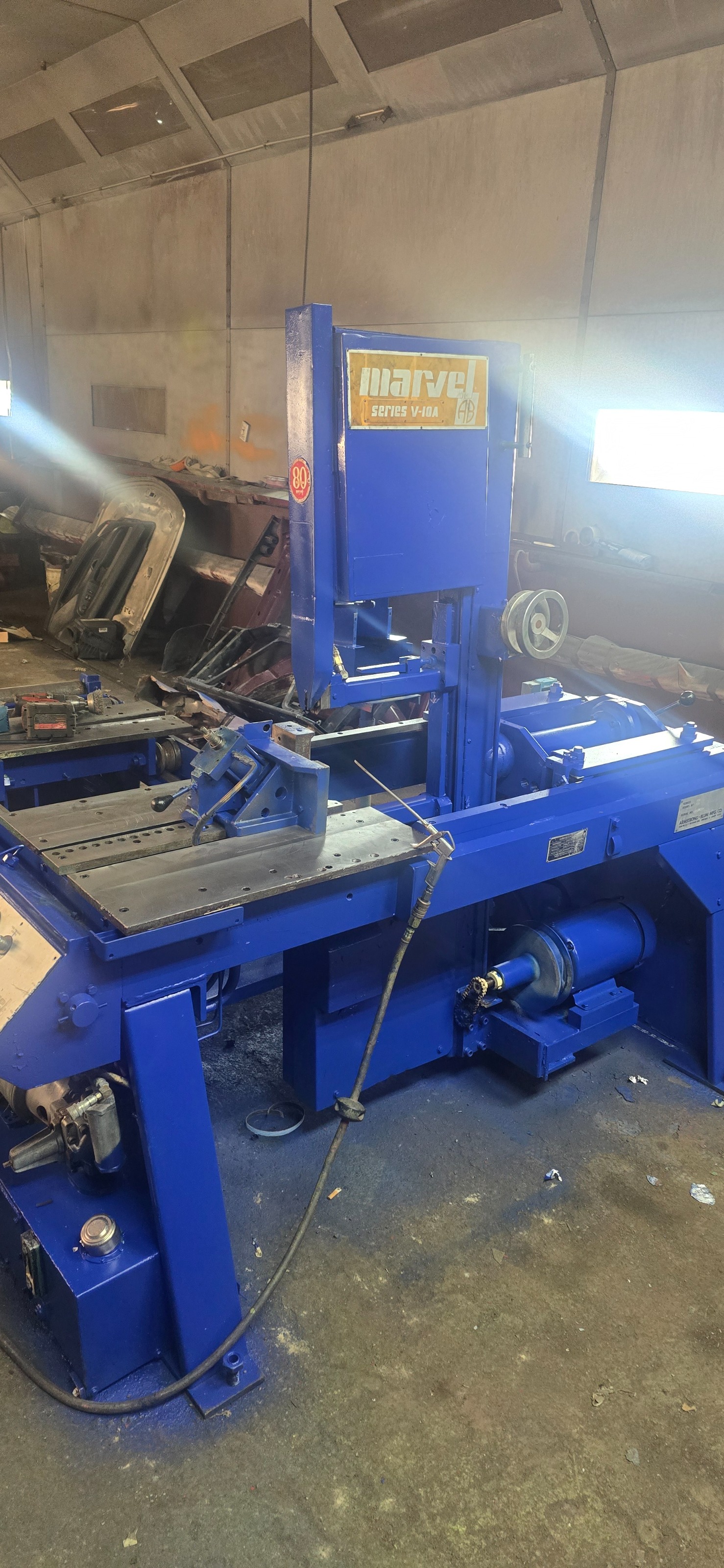

Here i have the saw. I pressure washed it like 20 times lots of wire brush on a angle grinder to all of the machined surfaces then painted it with thick oil based enamel paint. I also resurfaced all of the flat surfaces on the clamps/table on a large gorton milling machine with a shell mill. Soon I will start doing the assembly of the control box and wiring. I am going to keep a portion of the original electronic components and replacing most. Hopefully the system of controlling the hydraulic feed with a Encoder works well. If not I can scrap it for a ballscrew. slowly but surely it comes together.
