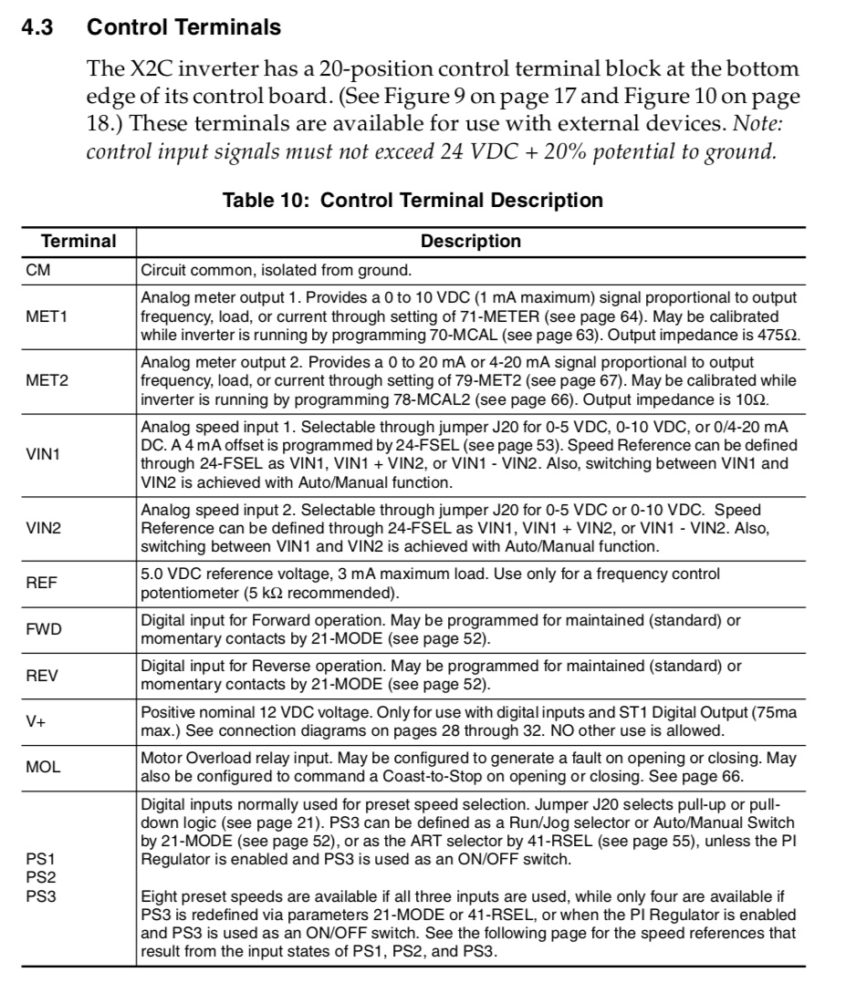

I think I have wrapped my head around my stepper motor and limit switch wiring. Regarding the spindle, I have a few questions:
The inverter is a woods eTrac x2c and the manual offers a nearly overwhelming number of options. I was never able to see the spindle working with the stock

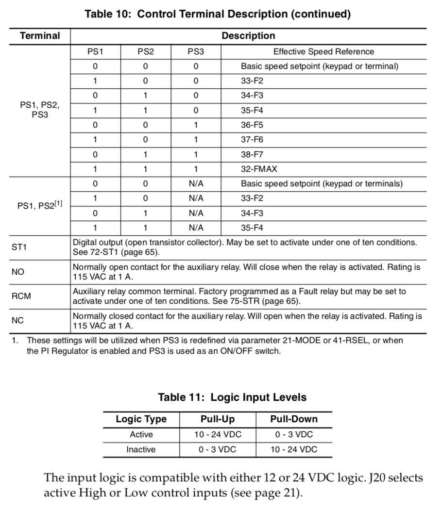

AMC controller. I have attached the relevant table from the inverter manual and it seems like I should be able to use the analog spindle interface to provide 0-5vdc signal for speed control (vin). Do I simply use inputs on the 7i96 to conteol fwd/rev and a ground connected to the inverter common? Is that all there is to it?
The original wiring from the AMC controller to the inverter is somewhat different and it isn’t obvious that the AMC was actually able to control the spindle speed. It is connected to use 4 preset spindle speeds and the AMC has wires indicating an acceleration/deceleration signal, as well as some connections to NO and RCM.

Is the a 7I96 or 7I96S?
If 7i96S you should be able to use the 7I96S analog output
connected to the VFDs +5V output, CM, and VIN1
VFD   7I96S
REF   SPINDLE+
VIN1   SPINOUT
CM      SPINDLE-
Then you would use 2 isolated outputs to drive the VFDs FWD and REV pins, something like:
V+  --> OUT0+
OUT0- --> FWD
V+  --> OUT1+
OUT1- --> REV

I didn't ever say thanks for your reply PCW so a belated thank you! Yes, the 7i96s. The above is working with the VFD set in 'pull-up' logic which is great. I still need to connect the VFD digital outputs (ST1 & STR) to the 7i96 inputs to signal when the motor is running at the commanded speed and when there is a fault. I also initially forgot to configure the PWM signal in pncconf initially.
