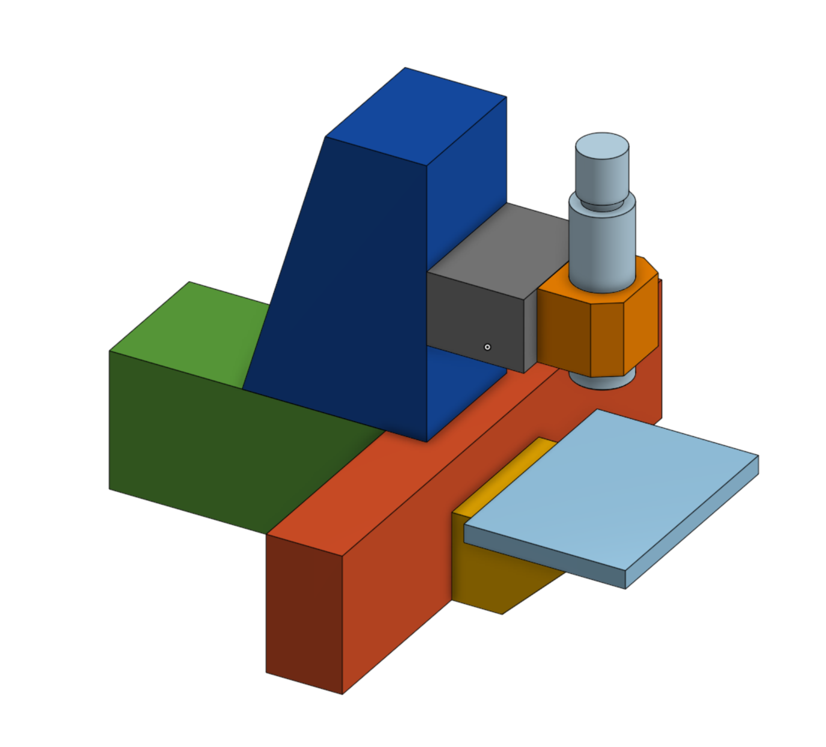

Is there in existence CNC machines with such axes placement. If yes how this types of machines called?
Red -> X, Green -> Y, Blue -> Z
Pros:
Clean working area, no way covers (only on vertical wall)
Easy way covers construction (plain sheet of metal)
Possibility to put long vertical work material (if to remove table or use other type of attachment)
4 and 5 axis could be added for rotating (smaller table or chuck)
Cons:
Please share your opinion

Seems not very common.
I have seen some grinders with moving column, but cannot find a milling machine.
... wondering why...

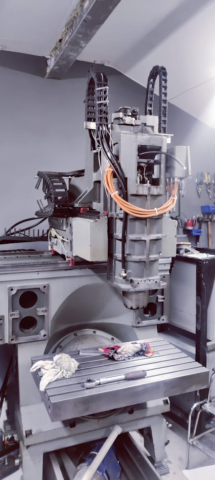

I found one example picture for a milling machine. I think this is about the rotary table, allowing to double the y reach by rotating the workpiece and then the overhang does not have to be as big?

My DMU50 looks kind of like this. That model is at least quite common i think.

i guess in my case what i have drown that it will be mix of twos, since x axis(table) will move with + to the left (as usual cnc does) and others two as you said. Wondering can it cause any problems with configuration or smt else
